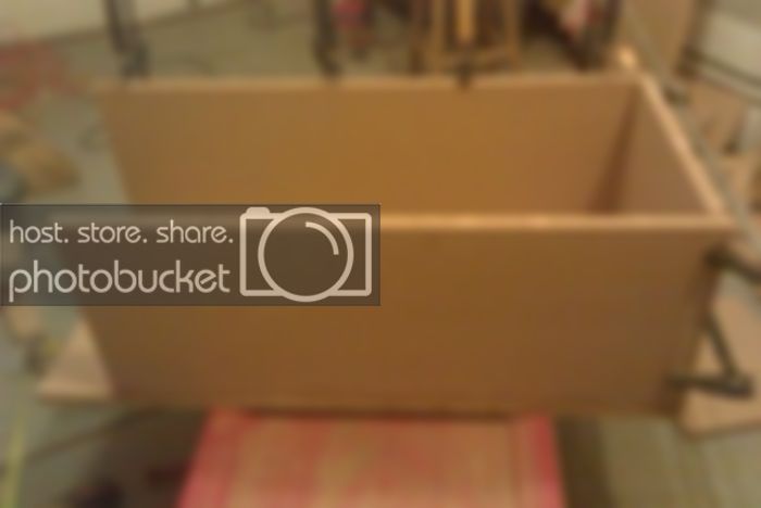

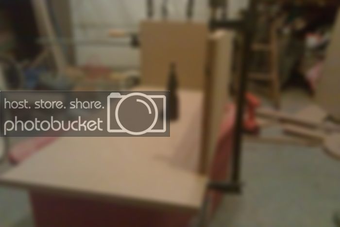

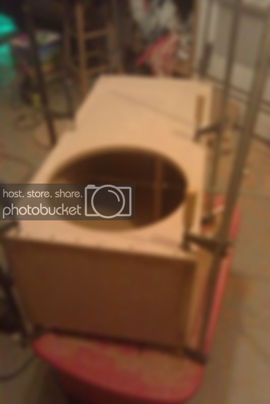

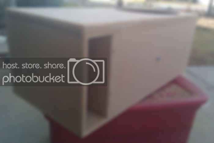

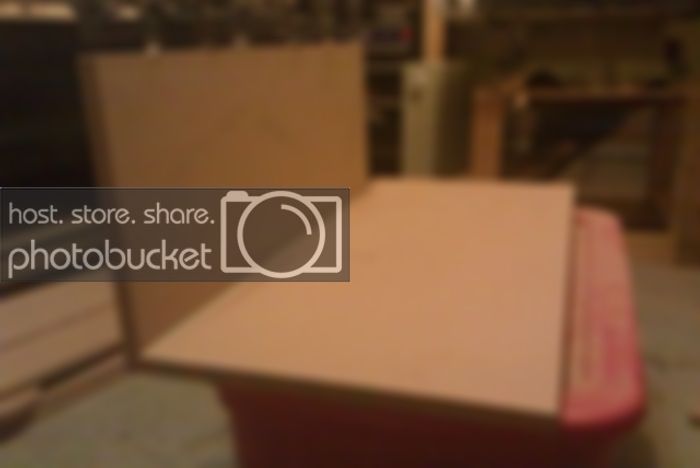

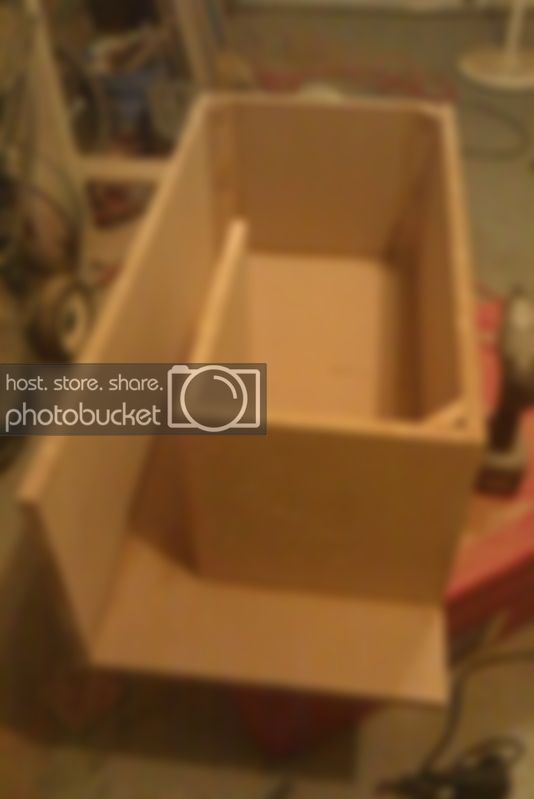

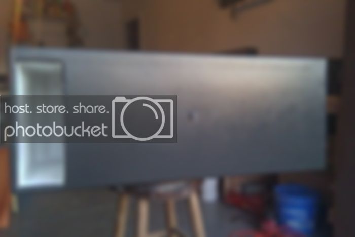

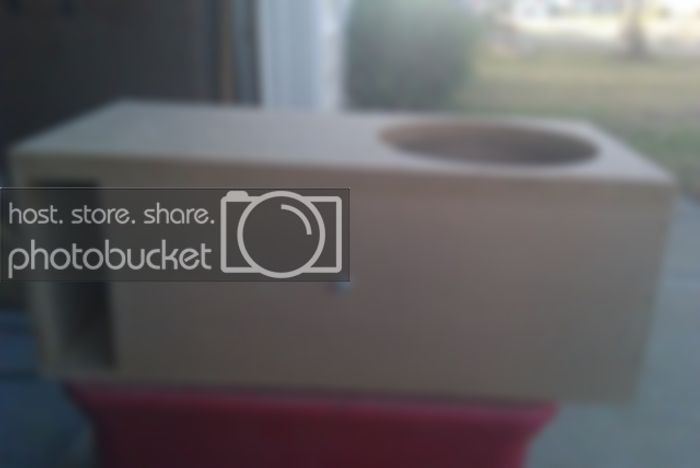

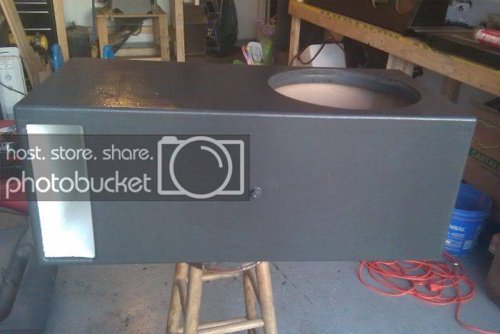

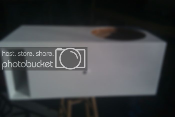

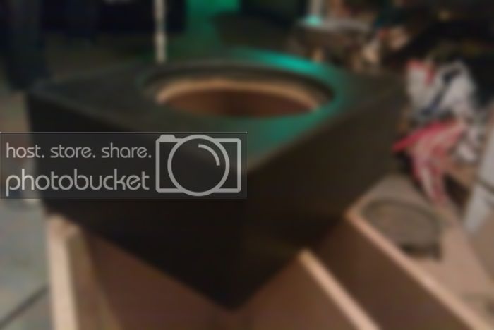

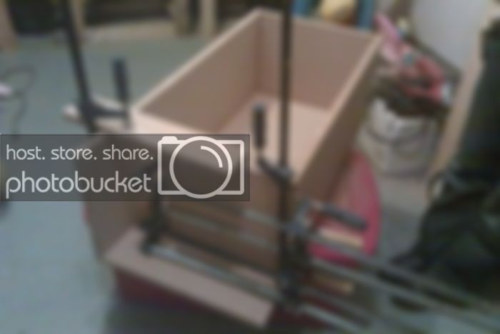

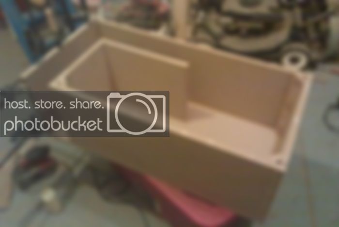

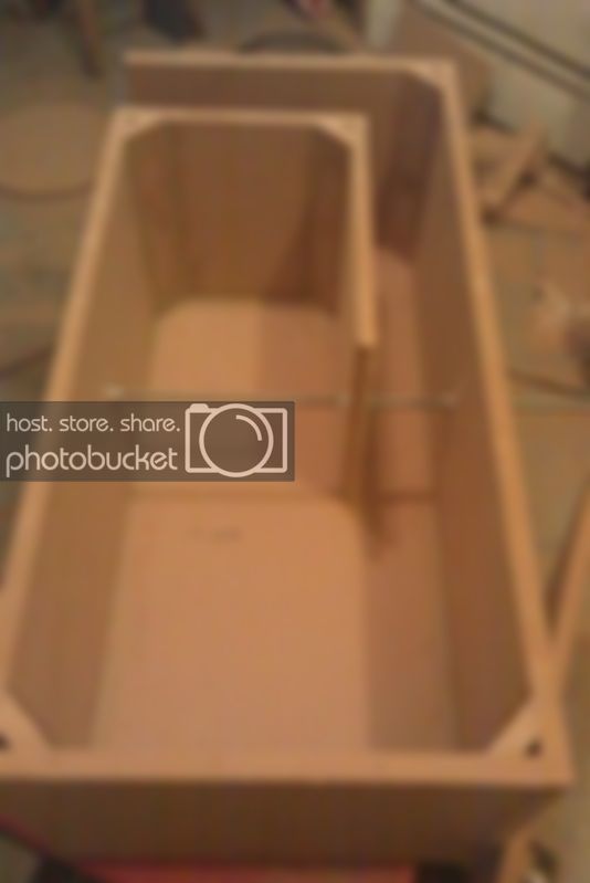

Building this for a guy he has a 15" TC-3000 going in a 95 eclipse sub up port back. 35..75" wide 14" high(including the double baffle) and 17" deep. 2.78 cubic feet tuned to 33.5hz. 16" of port per cube. Should be pretty loud. going to be painted coal gray and have rounded edges.
Well most of the construction is finished, it sure does take some time to build these. Whats left is 1 more 45. Then with the top plates cutting out the circles. The cut out is 14 1/8 for the sub. I imagine i cut that out of both plates correct(for the double baffle)?
Looks great as always man. Your building skill is quite remarkable
