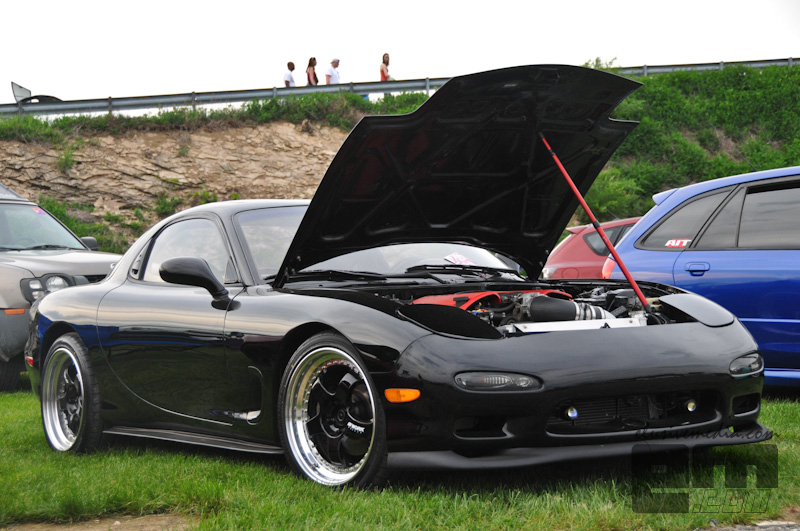

pics of that RX7, Rotary Fan here
sorry, no more rotary... Swapped in an LS1
Heres a pic from a car show last year, i now have actual hood props, lol
