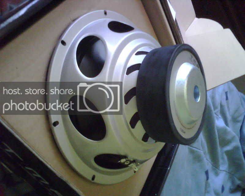

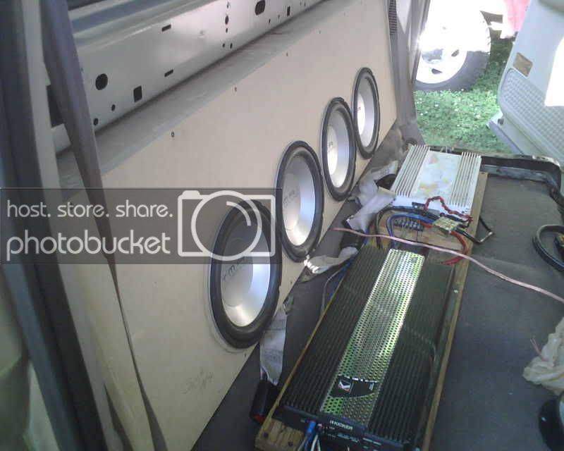

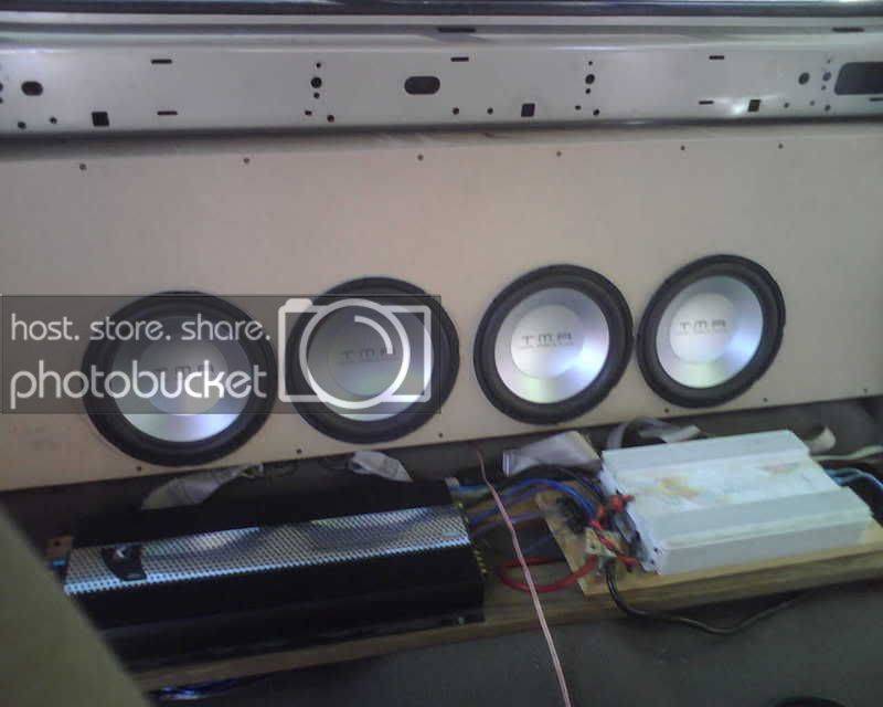

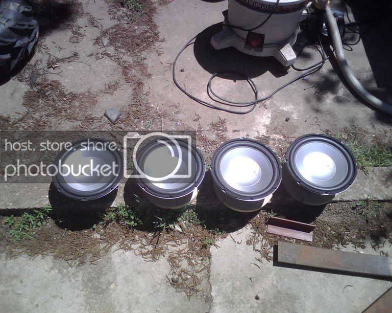

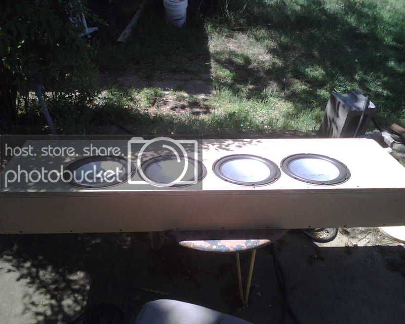

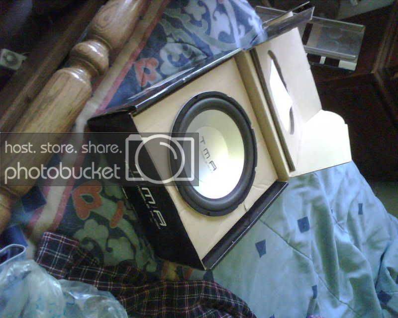

Brother has been wanting to get some "boom" in to his new truck. I built a box original to house 3 10w6v1s but just couldn't come across any. We then found 4 10w0s new, but we decided we could probably do better on the price. After everyone came across "TheSpecialist" having some killer deals I found some TMA (total mobile audio) single 4 10s. We had run some of their 12s in the past and really liked the sound. Very comparable to a JL w0. Charlie over at TheSpecialist gave us a killer deal at 51.99 a piece. so for a little under 250 after shipping for 4 10s, my brother couldn't have been happier.

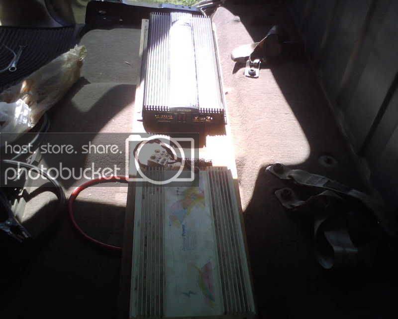

The subs are being powered by a Kicker Impulse IX2302 bridged 4ohm mono... so roughly 225 watts per woofer... The other amp is a PPI Art Series A600 power the fronts. As you can tell, it has been through a lot, but is still going STRONG!

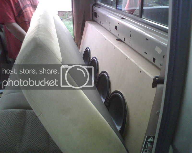

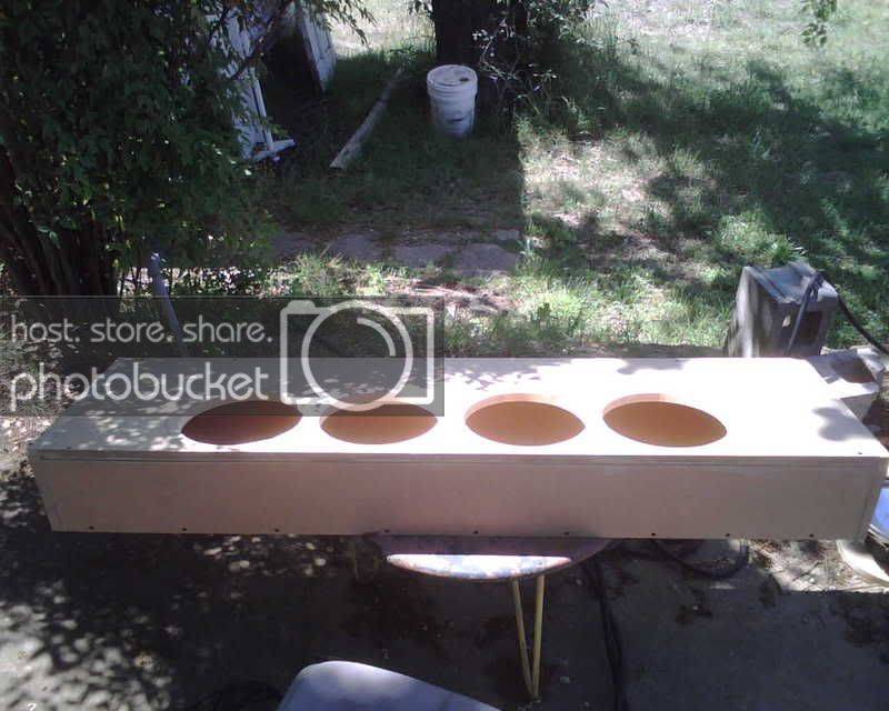

The box is right at 2.35 after sub displacement. The TMA specs are .4 - .8 sealed, so we fell in that range at ~.6
The box fits great behind the seat, and the amps fit perfect under the seat. A very stealth install for 410s in a truck without modifications.
Picture time:
