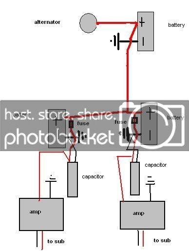

hello all, i just bought 2 kicker zx750.1 amps 2 kicker solo baric L7 12's what is the correct way to install dual batteries dual caps and dual amps?
im not really sure if i should run the main power to the trunk off the positive post on the battery under the hood or on the power supply on the alternator
any help is appreciated
you need a 2 fuses between the batteries, one beside the front battery and one beside the back batteries, and a fuse between the batteries and the amps
dont use the caps
