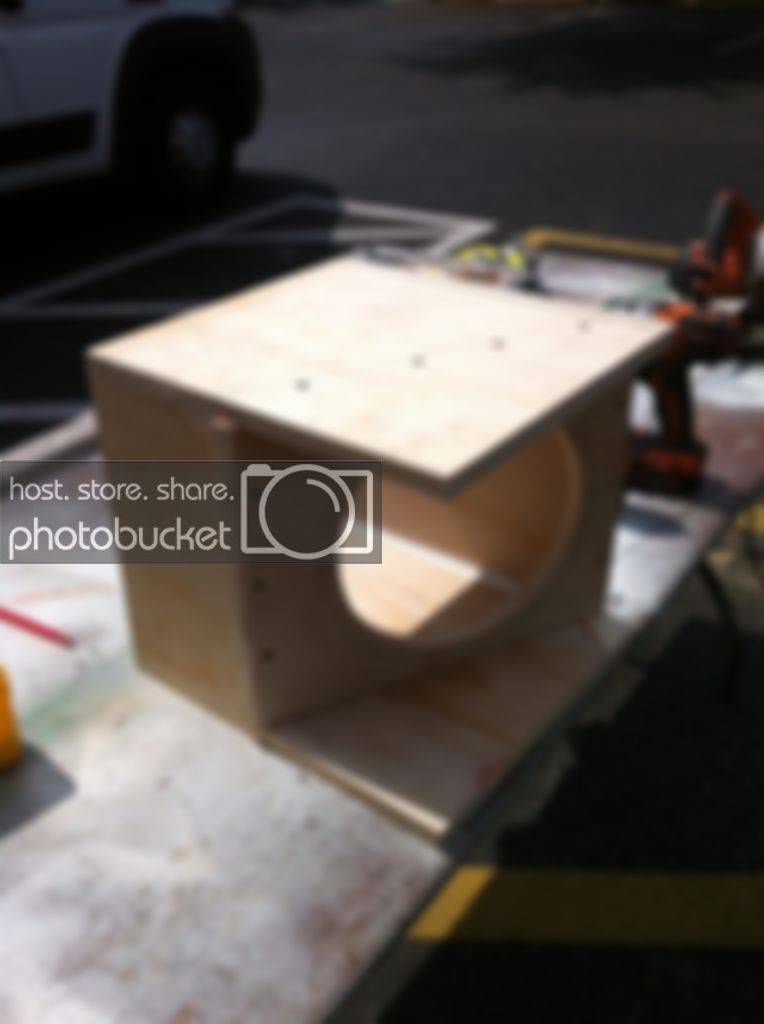

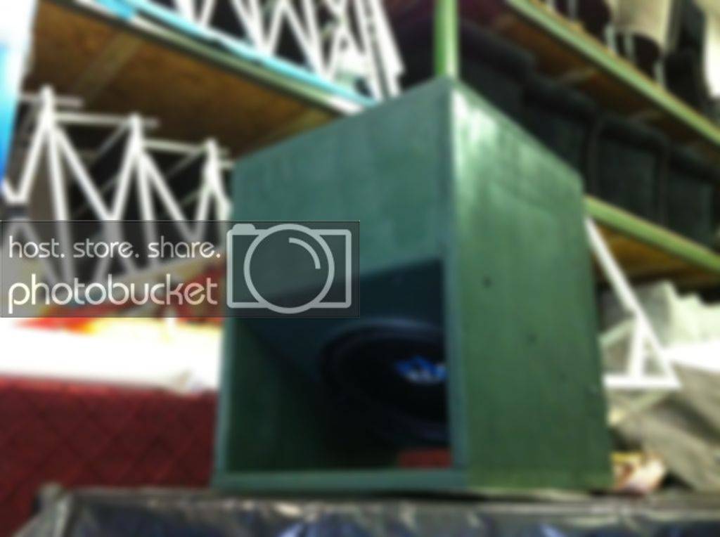

get a cheap 10" subwoofer that only takes 200w rms and build it a box like this - sealed but slanted down fire - so that it has its own baffle to bounce the sound wave off of to reflect at you - as a side note this type of enclosure will keep your sub "safer" from getting poked or smashed up. this is probably your best bet at getting bass to sound loud and like bass without being inside of a room or a viechle.

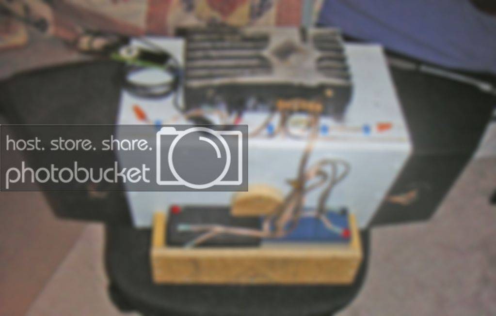

you can steal some batterys out of the emergency lights inside of most big wearhouse type buildings. some are 12v some are 6v either will work if you find 6 volts you obviously have to jumper them in pairs to get 12v.

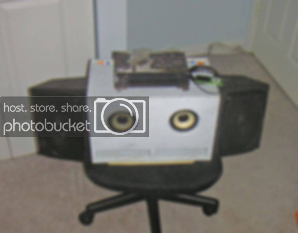

here is a crappy setup i did with those type of batterys - i diddnt steal them tho i trash picked them during construction remodel of a old publix ( grocery store )
pick up a cheap o mtx or bla 4 chan used here on the fourms for $80get a cheap 10" subwoofer that only takes 200w rms and build it a box like this - sealed but slanted down fire - so that it has its own baffle to bounce the sound wave off of to reflect at you - as a side note this type of enclosure will keep your sub "safer" from getting poked or smashed up. this is probably your best bet at getting bass to sound loud and like bass without being inside of a room or a viechle.

batterys are the key here - you want to run a 400 watt system off just batterys your going to need 80 pounds worth of batterys in the thing to make it last more than an hour before needing recharge...
think about how heavy this thing is going to be once its built ...
the big box i did with home stereo speakers and just 1 kenetik 800 battery was so dang heavy i could barely pick the thing up by myself ( it was alkward size shape)
