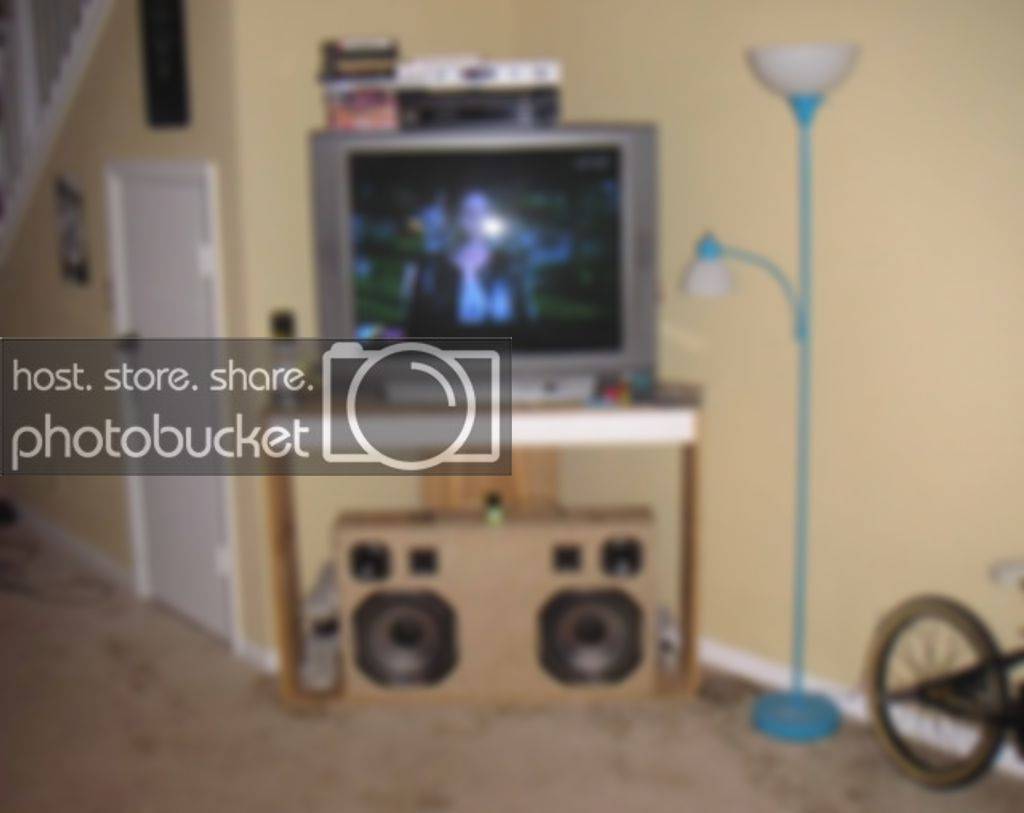

i took apart a pair of home stereo 3 way speakers with 12" woofers donated from a friend - used all the parts - including crossovers
small agm battery ( kenetik 800 ) and a small 2 chan amp
added charge spots up top for a car battery charger to clamp to -to keep it charged - and a toggle on off switch wired to the remote turn on spot on the amp. amp and battery were built inside - next time i would build an axess pannel to them.. eventually i let a friend hold on to it - and they never re charged the battery and the battery went bad - but it would play for 2 hours at full volume before needing recharge. as a tail gate situation - one could simply add jumper cables from the under hood car battery to the charge spots on the unit to give a quick recharge...
it was amazing. hands down the loudest boom box ive ever heard.

Nice! Thats the biggest thing, want it to be loud.
efficency is the key in portable stereo system. you dont want a ton of weight / batterys to run the thing.
car audio is mostly not as efficent as some home stereo gear can be
i think my box was getting roughly 75 watts per channel and was loud loud loud
efficency is the key in portable stereo system. you dont want a ton of weight / batterys to run the thing.car audio is mostly not as efficent as some home stereo gear can be
even the sub?
