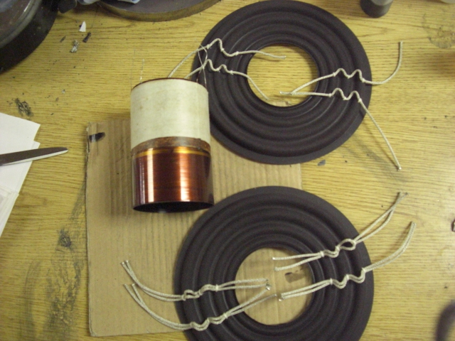

do you have pix of the coil and spiders? most co's would just use more or less of the same spiders with the same size coil such as the z and nightshade.
please explain. you going with a 9" spider on the nightsade v2?
pix pix pix

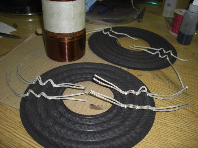

These spiders are different than what I've had before on the NS v.1 -- they also have optional double leads.
These coils are what I've tested with so far (in the pics)... I am changing them very slightly for production.

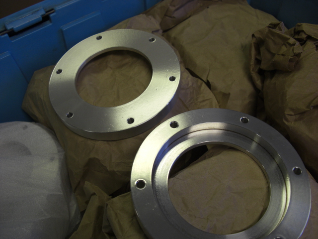

I am trying to figure out how to get a 9" spider on both 15s and 18s for the NS v.2 -- but I don't know if it will be ready for initial production. I am looking at making adapters for the 15" 12-spoke and the 18" 6-spoke already accepts a 9"
I have a 9" spider ring i can send you that fits 12 spoke 15" and 12" baskets. Ill also send you some pics..
Jake, I think you need to tool up your own basket so you can fit whatever spider you need. //content.invisioncic.com/y282845/emoticons/smile.gif.1ebc41e1811405b213edfc4622c41e27.gif
It's awesome that you are doing this, should help in both the SQ and SPL markets.
are you putting a collar under the spiders and need that extra clearence?

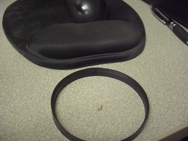

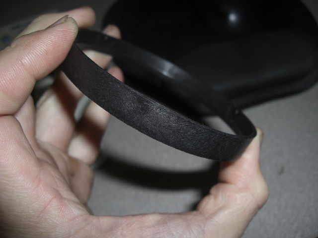

As promised here are pictures of the triple joint ring (this is why I added 10mm of spacing with the shorting ring) :
* The ridge part faces the winding... gets filled with glue.
* Another view.
Made in Concord, NC from a very high temperature material... takes ~530 degrees to mold it and they tell me that unless I get it up to around 500 or so it won't deform from the formed shape.
Simple part... but should help alot with excessive abuse. I am planning to round the edge that touches the spider as well to keep it from sawing into the spider over time.
