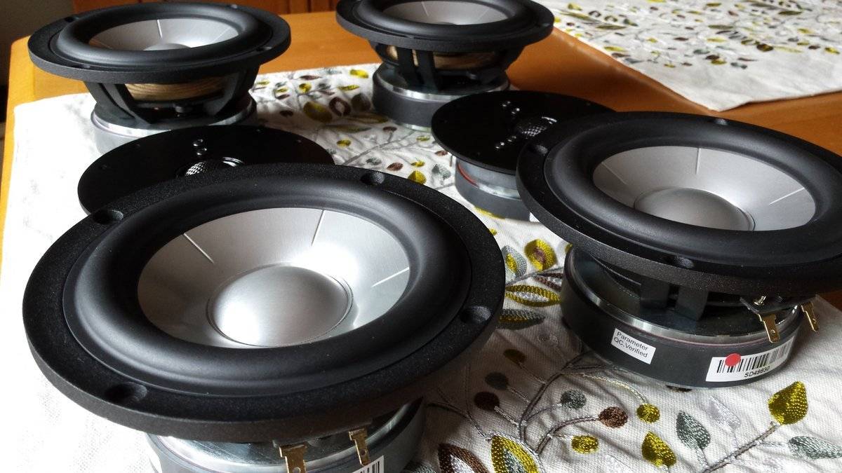

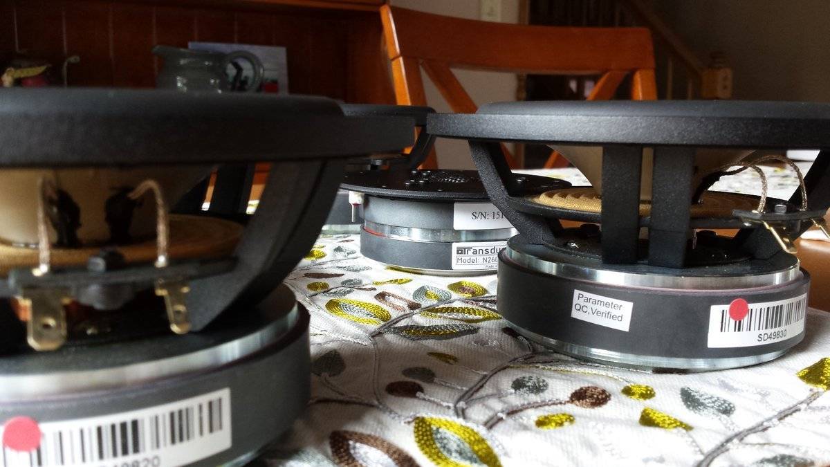

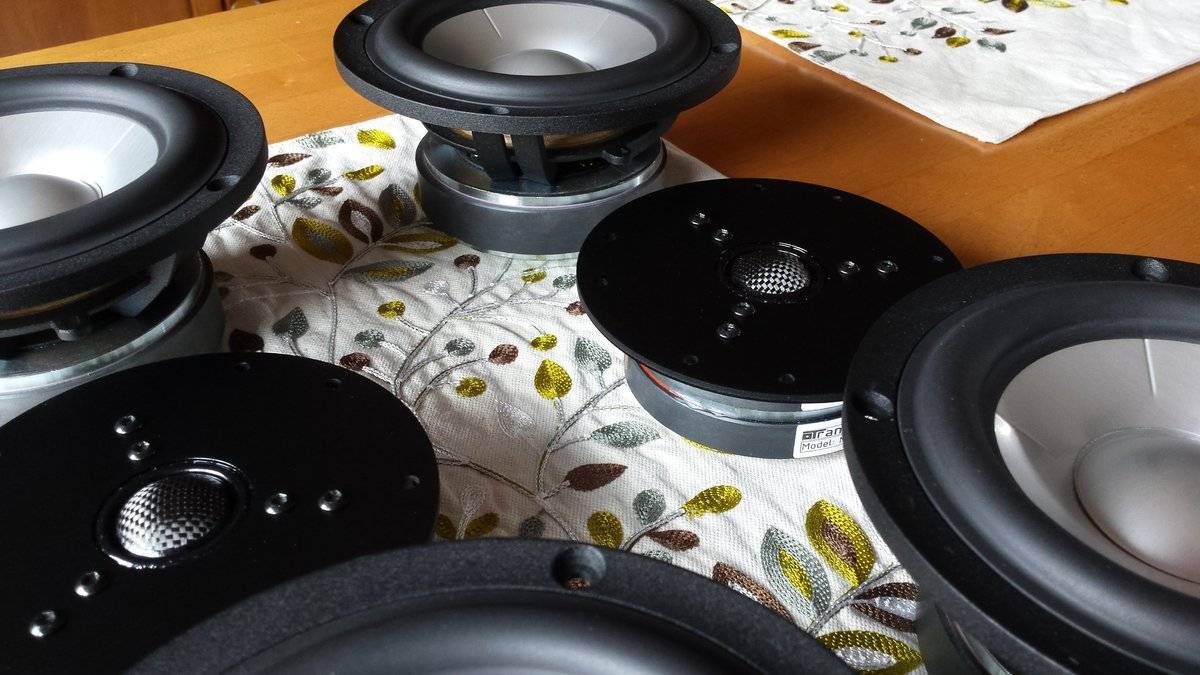

Best to buy good drivers and not worry so much about it. I like Transducer Lab tweeters unless I'm running ribbons. The carbon fiber and the ceramic are my favorites.

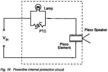

Another old school trick that you still see now and then is the current limiting bulb in the tweeter circuit. It diverts power away from the tweeter coil above a certain threshold.

Those are some very nice looking drivers.
Yeah, these Transducer Lab tweeters are about as good as it gets for the price. The link below shows one of the cleanest spectral decay and plots I've seen for a dynamic driver. I think the only step up would be the more expensive beryllium or diamond domes from SBA, Scanspeak, and Accuton at much higher price points.
http://www.robsandiy.com/tweeter/TD_N26C-A
Nice. It would be a sin to cover them up if being used in the home.

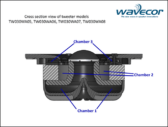

You can't bottom out a tweeter voice coil because of how thick the magnet is below the top plate. I put a picture below to help with this.
Most tweeters have a voice coil that is the same height or slightly less than the height of the top plate. The top plate and the coil are not very tall, only a few millimeters. The voice coil former is usually much taller by comparison and on top of that is where the dome and surround junction occurs. The allowable stroke would be limited by the former height and surround width so if there's any amount of width, you can actually produce a pretty impressive physical stroke. The stroke is not always clean but if it is, you can choose between playing low frequencies (800Hz to 1500Hz) at low power levels, or playing normal frequencies (2kHz and above) with higher output and better dynamics. There are a few tweeters that can actually do both with very impressive freedom from thermal compression or IM distortion being generated from the dome moving back and forth. The ones pictured above and below are in that category. It's all in the motor and suspension, just like any other driver.
