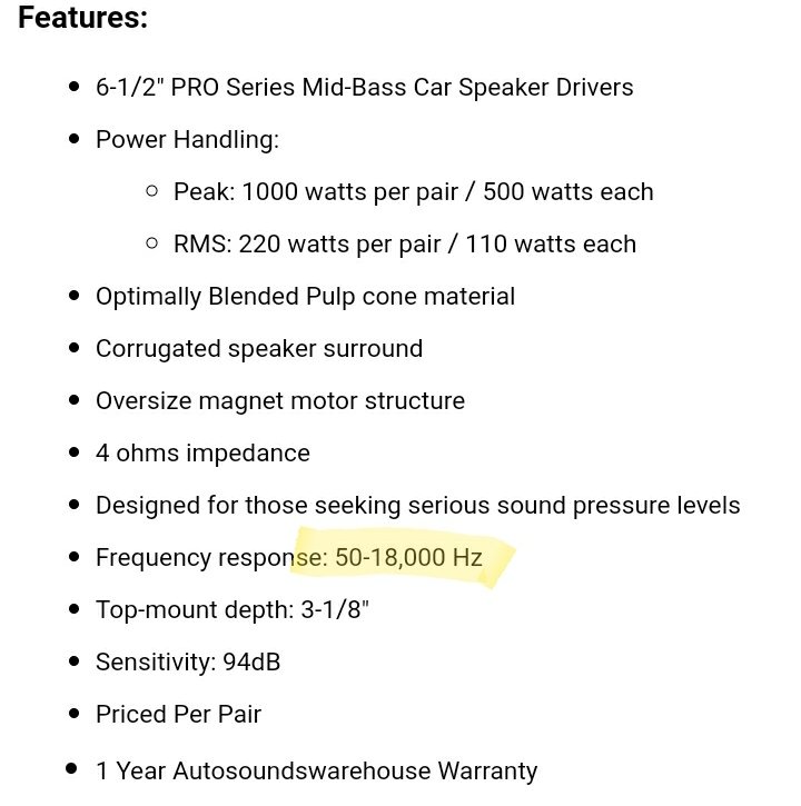

Quick question. Would you even need tweeters if you ran these in the front and back doors? Look at the frequency response. $100/pair.

If that thing can play 50hz for real its gonna sound like garbage above 3500hz.
Pro audio mids are usually a 125hz-8000hz range and that's stretching the upper end way past what I'm comfortable with. I'd hate to see the response graph.
You don't want drivers to play to much as they get I mushy sounding. I'm trying to let my silverflutes play 30-3500hz right now because of blow tweeters and it's just bad. Put hpf to 100hz it's still bad. That speaker is a 50-2600hz driver in my install. Outside of that range it struggles.
