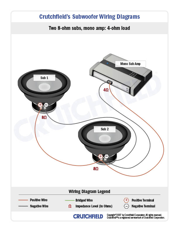

one more question...
would you agree with this diagram when hooking up the system?
