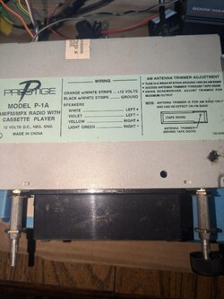

Hello all! I am new to the car audio game & could use some educating!
I am wanting to install 2, JVC-DR162 300watt 6.5 coaxel & 2 JVC CS-DR693 6X9 500Watt coaxel speakers.
I am looking for a JVC Amp (prefer to keep matching manufacture) that would be good match for this set-up.
I have not settled on a receiver as of yet but the one I plan to use in the mean time is the one pictured.
Thank you in advance
Chris

I've had good experience with JVC head units. I've had my current model KW-M560BT MULTIMEDIA RECEIVER about 3 years, and it works good for me.
I suggest that you look at the wattage of the internal amp of the unit that you select. Most will have nowhere near the peak wattage of the speakers you selected. Many folks have external amps to drive the 300 and 500 wat speakers you selected. My particular model is rated at 21 RMS and 45 RMS peak per channel. Not an issue for me, as I have external amps powering my speakers.
However, i f you are using your head unit to power your speakers, I suggest that you purchase speakers that will accommodate that RMS.
