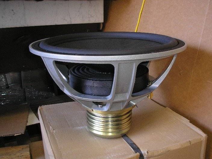

Do you know of any complete 4" radial neo subs I could buy? I sure don't.
They're out there. They have the same potential and actually sound better. This dude is water cooling his, lol. --> Some pics of my liquid cooled neo 18s setup. (pg2) - Subwoofers / Enclosures - SMD Forum
Couple in a Ford. -->
Thermal is a bit lower on those but they have wide bandwidth with real efficiency, not just 95dB at 1kHz. Are you going for loud to the meter, or loud to the ear?
Pair of 5100's. --> TC Sound PRO5100 18" Subwoffer | eBay
Lots of Aura NRT/NS. --> Aurasound NS18 992 4A 18" Pro Subwoofer Driver 4 Ohm 296 260 | eBay
I almost forgot about these, we could help a fellow member with a sale. --> Rare 18" Aura 1808 with 4" coil underhung NEO motor. MINT CONDITION - Car Audio Classifieds

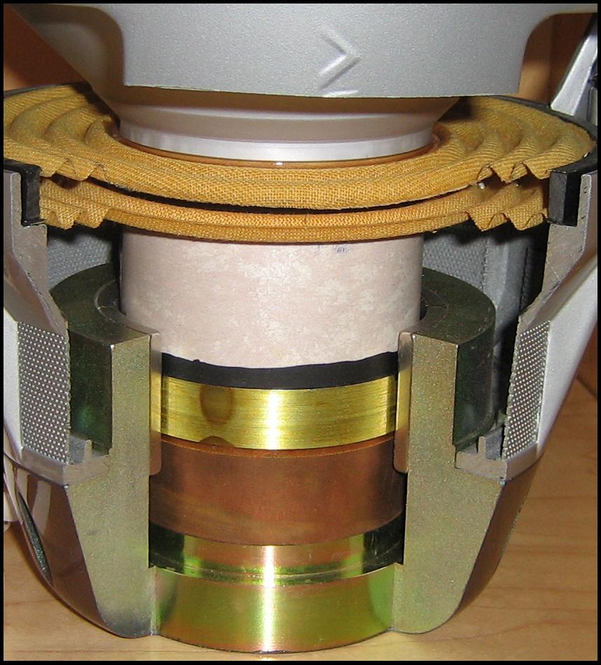

The Aura's are not the prettiest, I do agree. By no means, cheap. They're just the refined version of the older NRT. Sensitivity is a bit lower but I think it's a better driver overall. It's used in the early version of the big Magico Q subwoofer. Magico uses the LMS ULTRA now.
Didn't DDaudio make 4" 5" 6" cool neos? I think they tried them all... There are pictures floating around
id imagine they did. i know the original BEAST was a 4 inch coil like the current 99 but they had much better efficiency with the 3 inch coil. the 3" coil in hte normal LGLC design work great. the added mass in a LGLC driver with a 4inch coil doesnt have anymore BL(not much) and the added mass lower the efficiency just enough for the 3" to be louder and still have low enough power compression. as we keep pushing the boundries we going to find new designs and techniques to get louder, longer lower and sound better.. cant just stop now!
