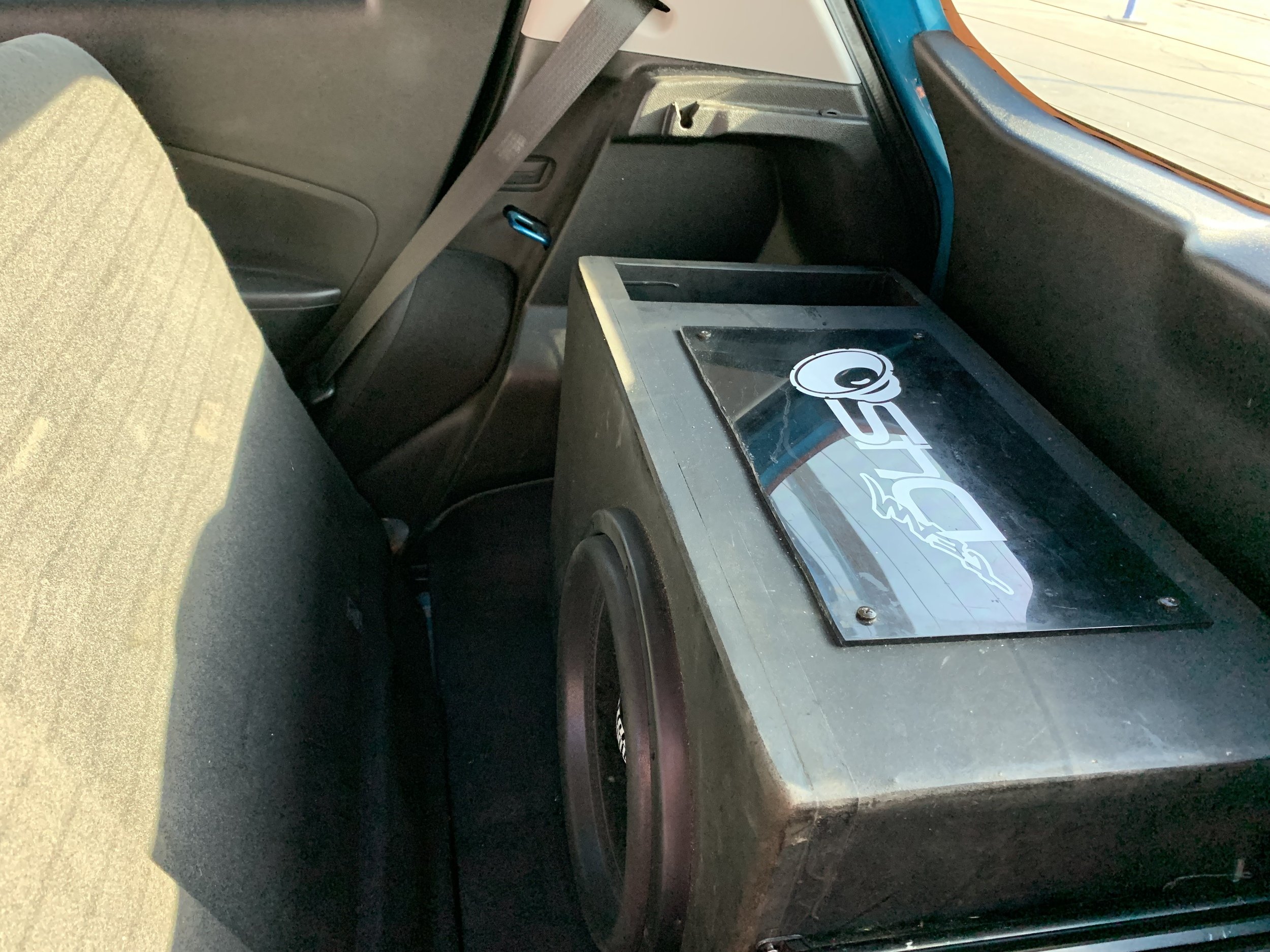

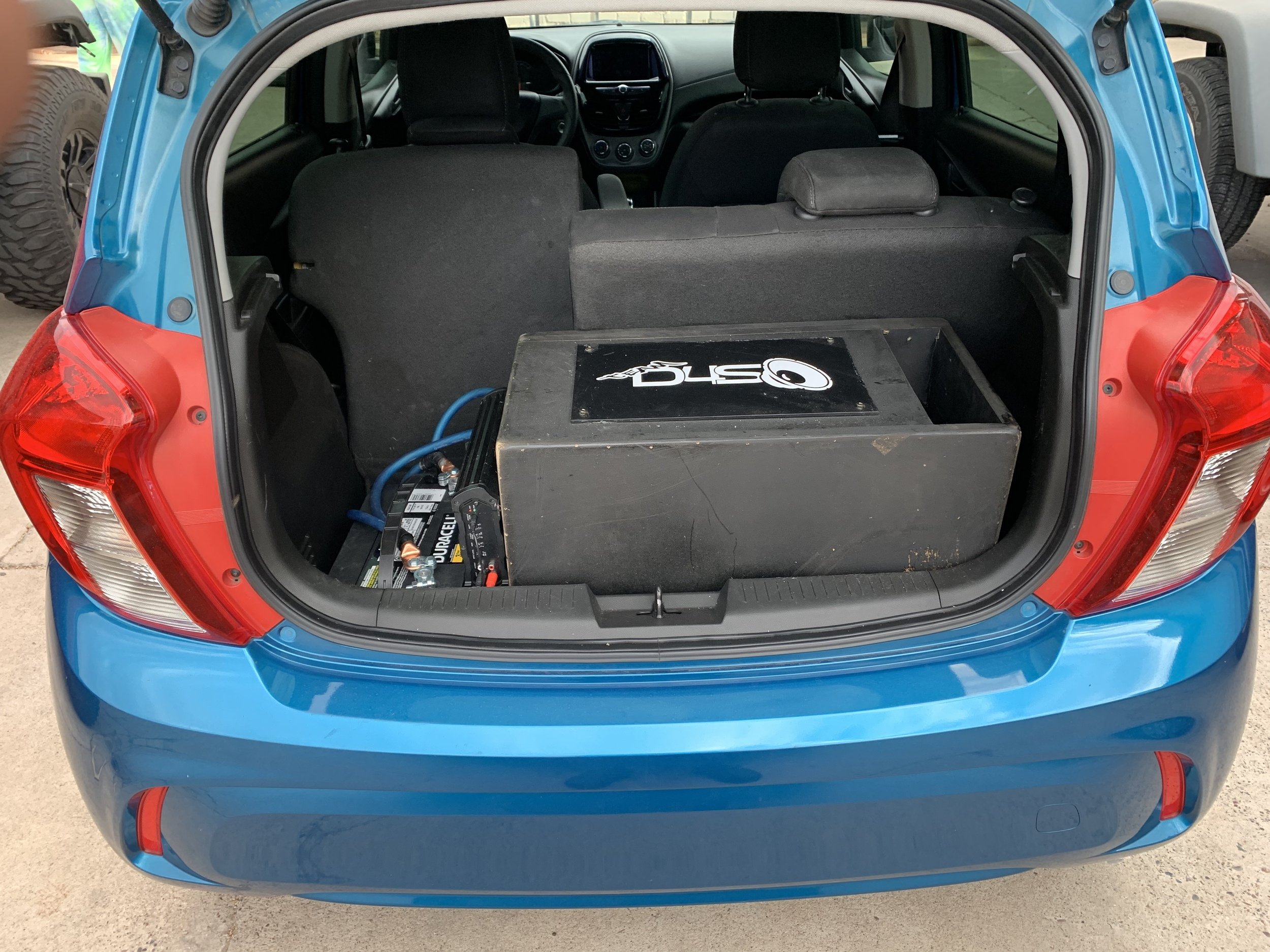

Pics of the box as it sits in the vehicle right now.
39382
That might crowd out the port too much but yeah, I don't think sub firing forward is doing you any favors here. If that were my vehicle I'd try sub and port up.
I'd also be a bit concerned that the acrylic window may be flexing. How thick is it I wonder?
Made the adjustment sounds better thanks. With limited space would I be able to upgrade the sub with the same box?
