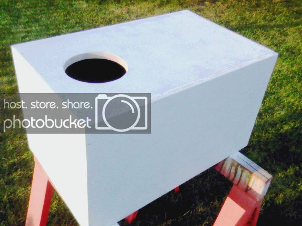

Let's get this thread started! Enclosure is 2.5cuft @ 32Hz (4" Flared Aero Port) after displacement. Design courtesy of Bromo from Car Audio Forum - Car Audio's Forum!

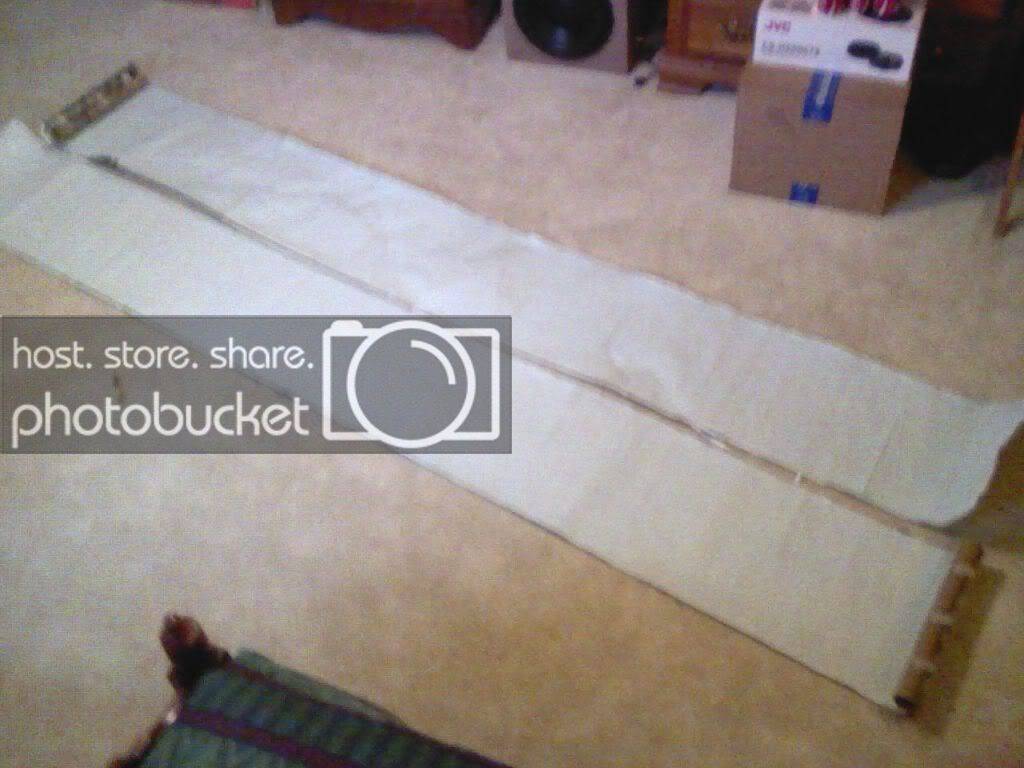

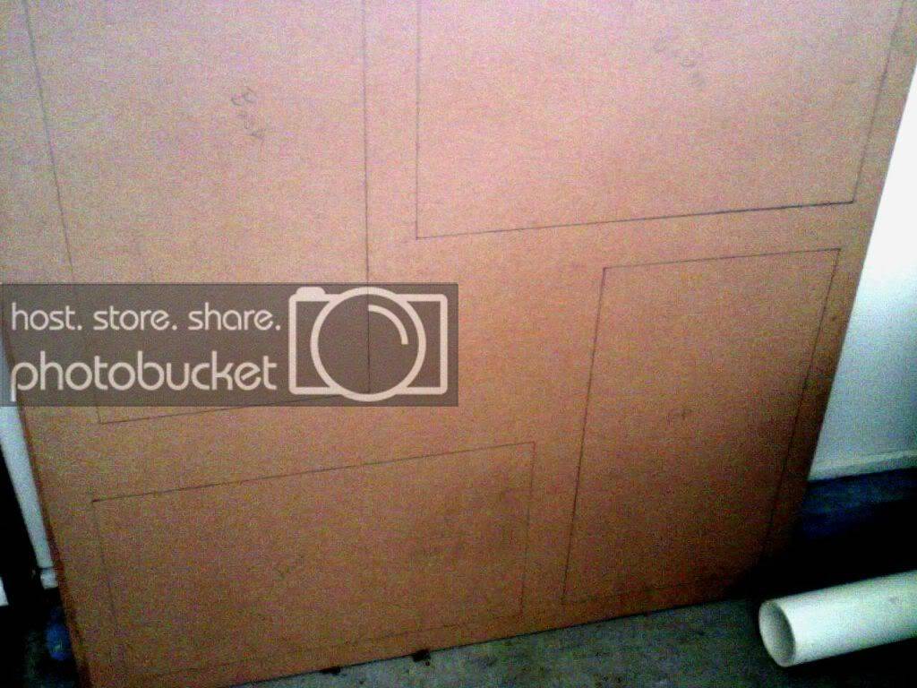

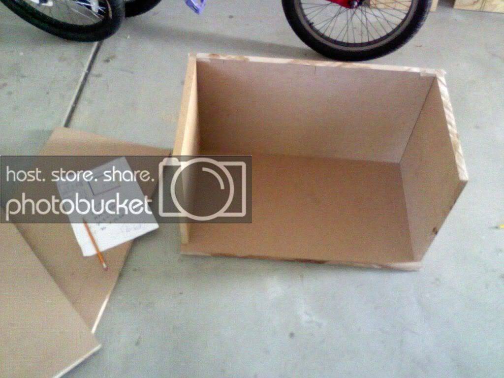

Cut Sheet drawn out.
Making sure everything lines up.

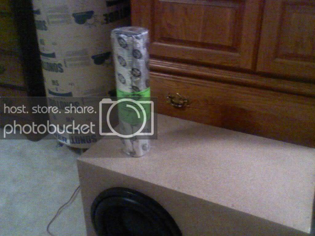

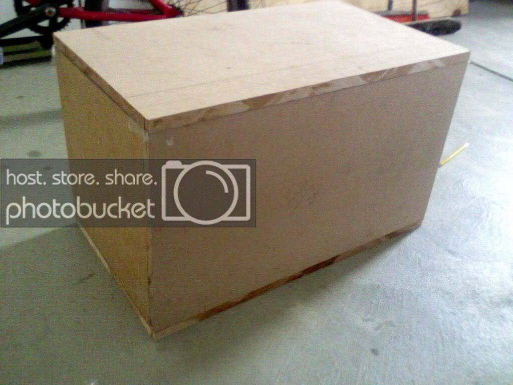

Box taped together

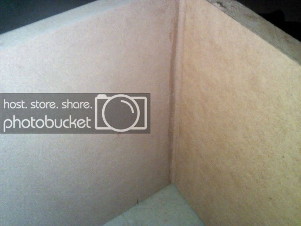

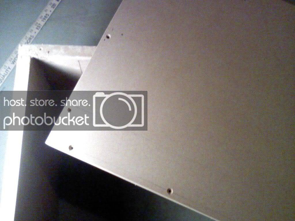

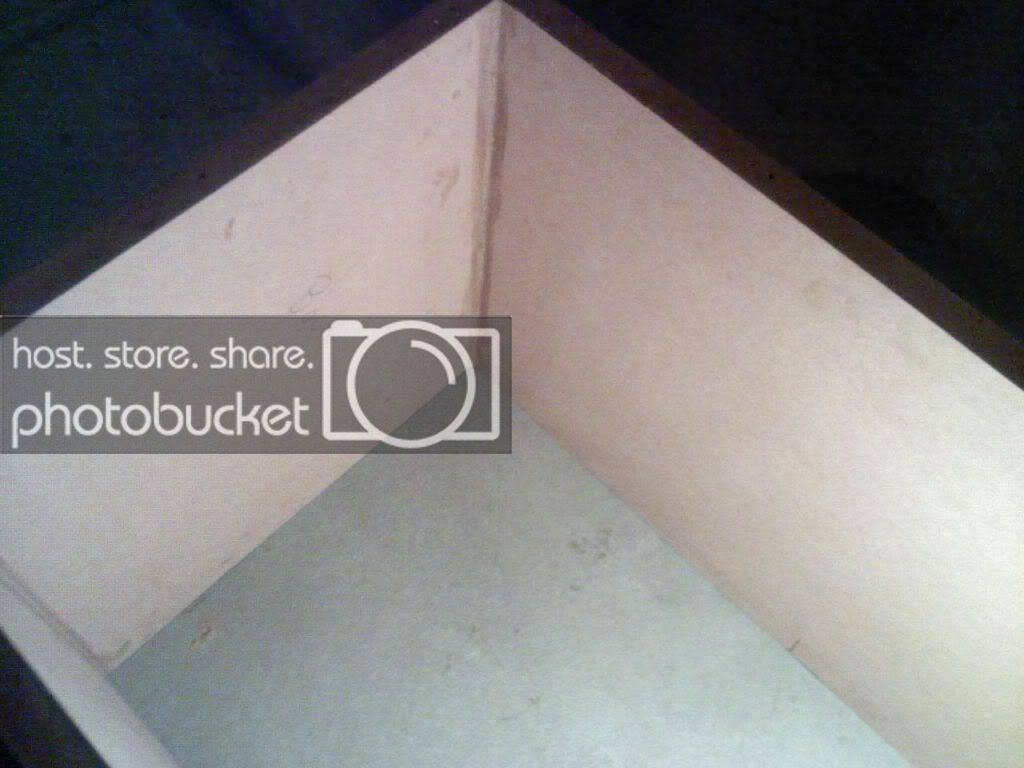

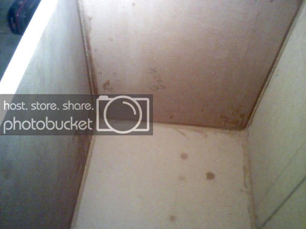

Screwed, Glued, and Sealed

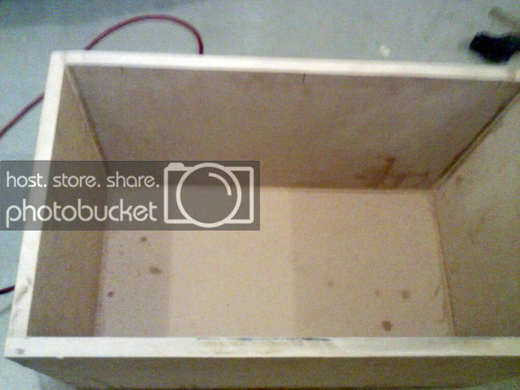

Bottom

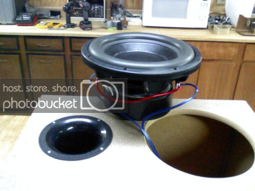

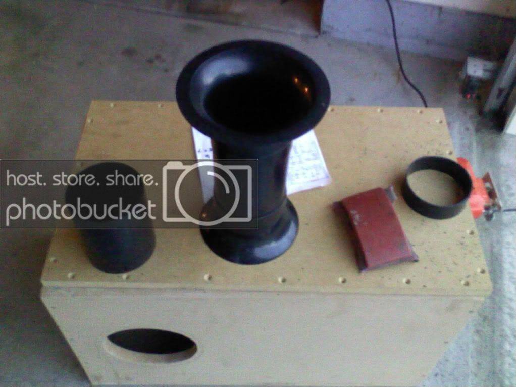

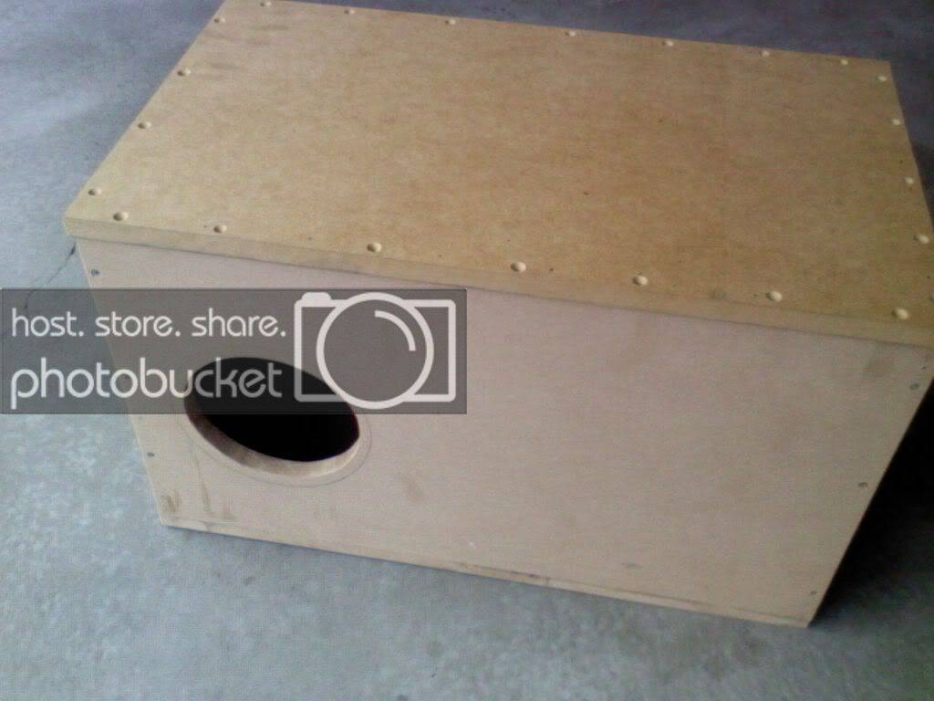

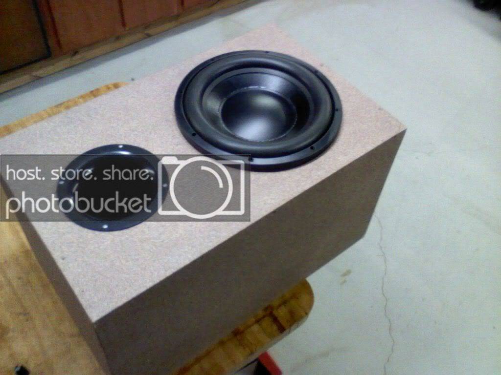

Top View and 4" port hole cut
Port Cut to Length

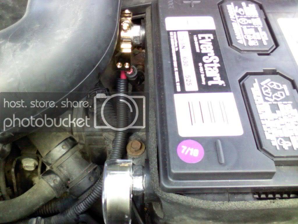

Aftermarket Battery Terminals Installed

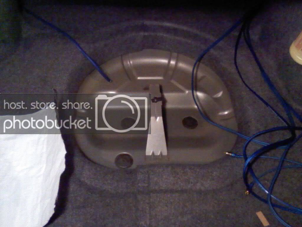

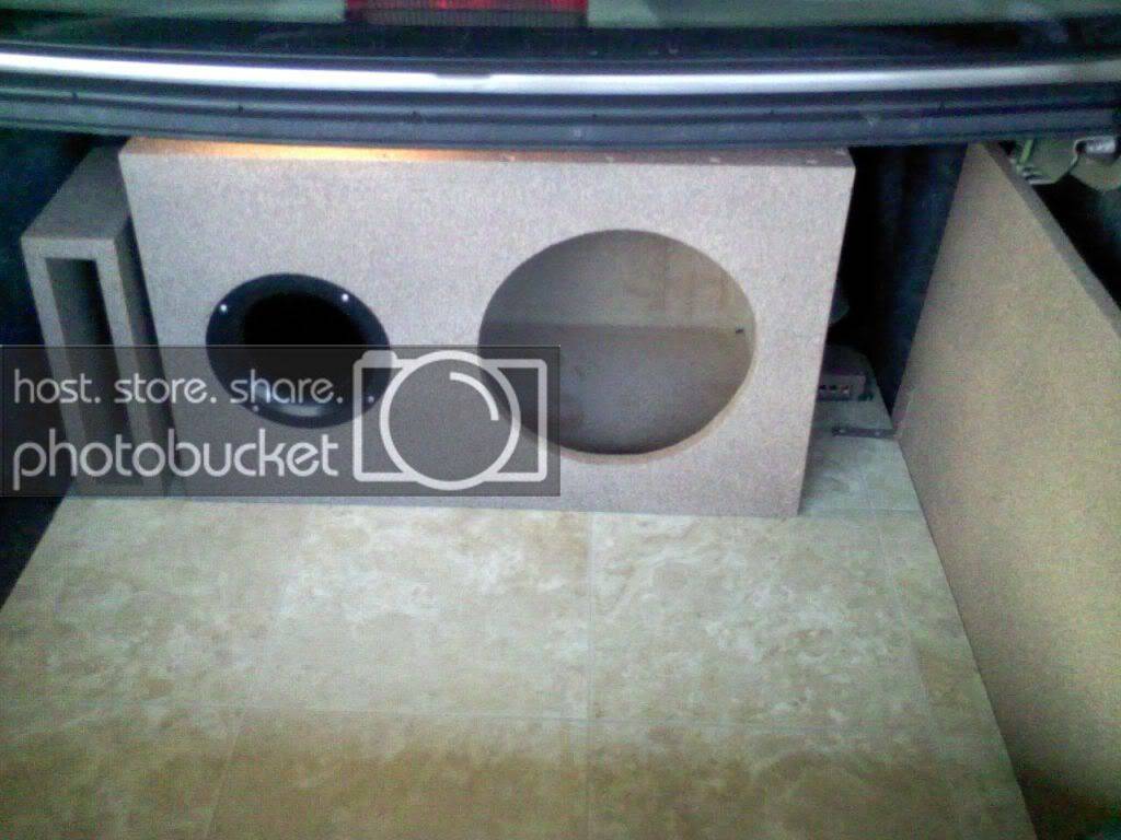

Trunk Layout Design (hopefully)

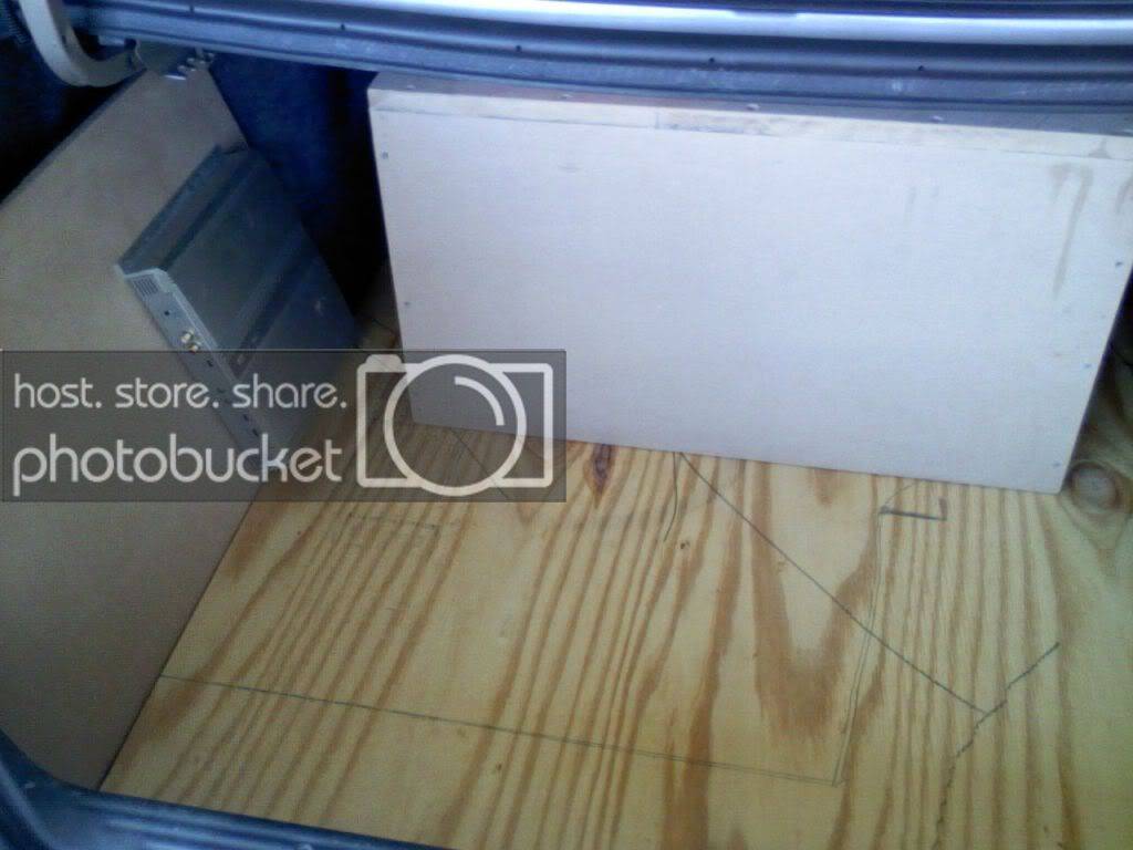

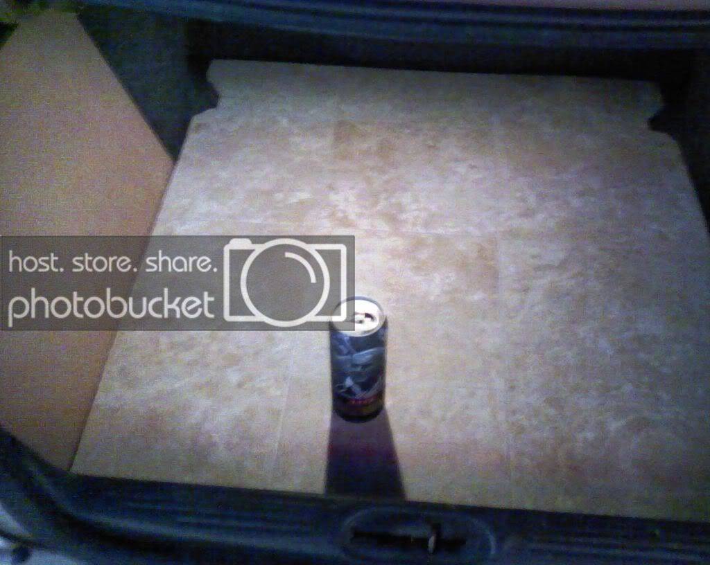

False floor cut and Laminated

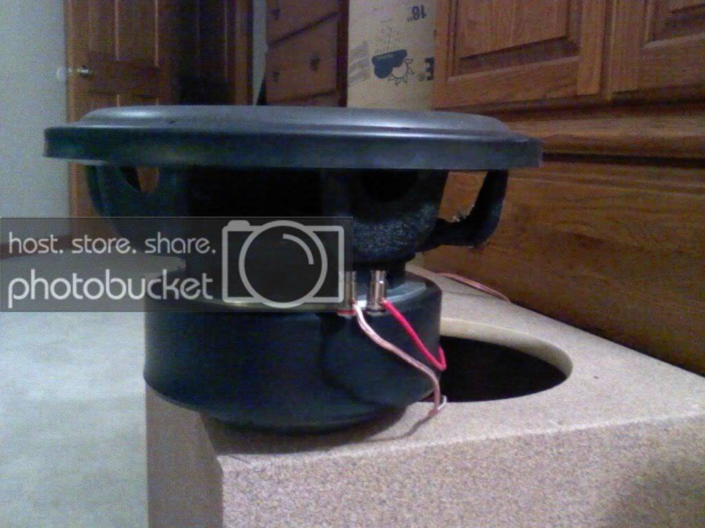

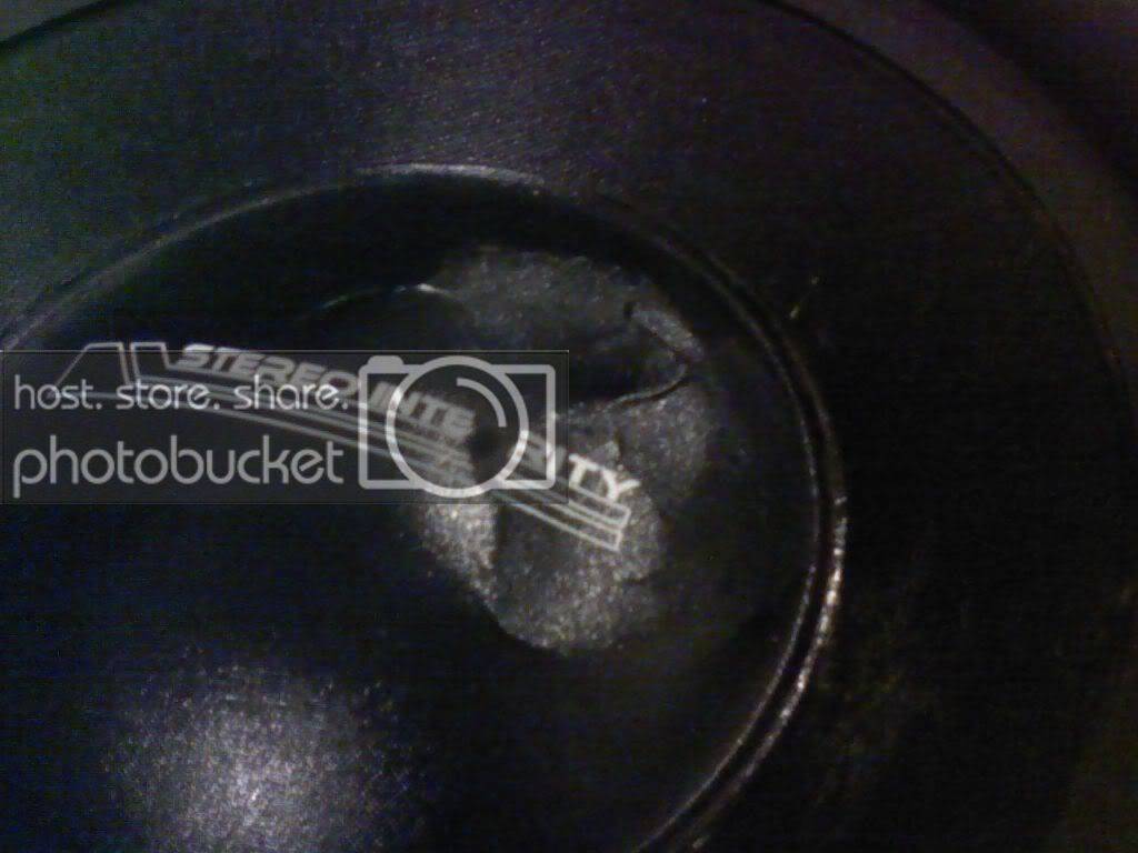

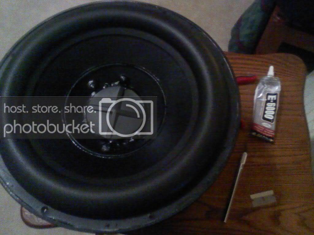

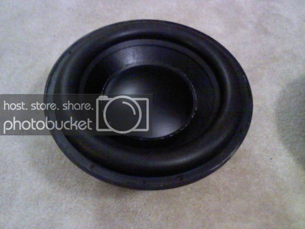

Update....Subwoofer is 12" SI Mag Claw V1 (V3 softpart recone) with another custom dustcap lol. Bought if off my friend for $100 because his dog dented the dustcap. It has only been played for an hour after the recone. He's not into caraudio and doesn't realize he basically just gave this gem away lol.
Dented Dustcap
Dented cap off
Fixed :)
Screwed in
Side view
Wired to 4ohms
Updated trunk layout

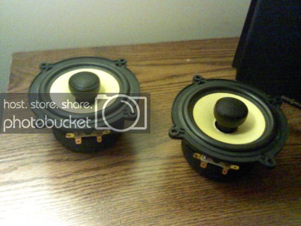

Door Speakers, Bravox Audio CX50Ks

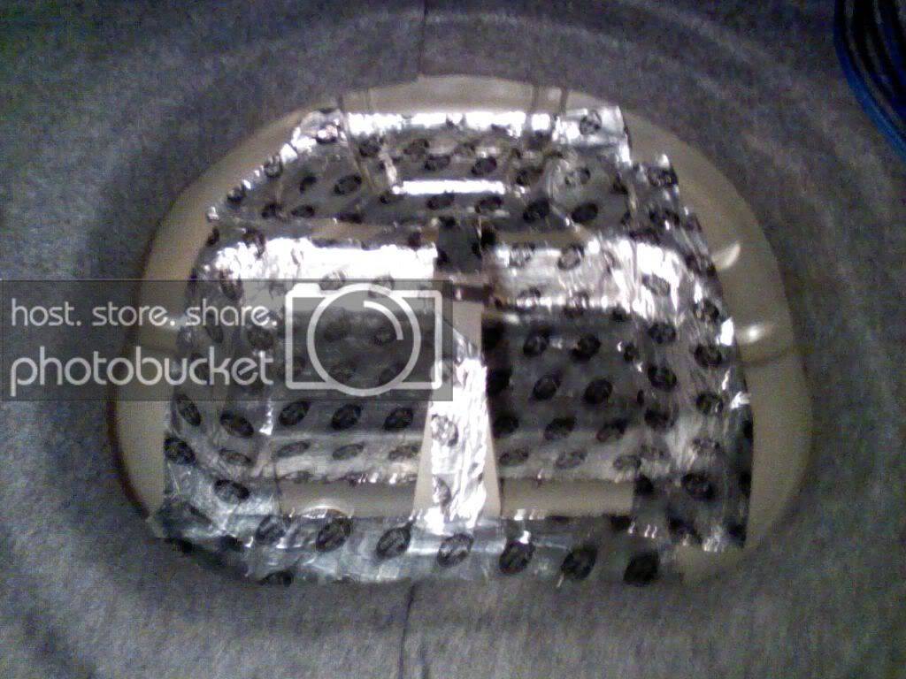

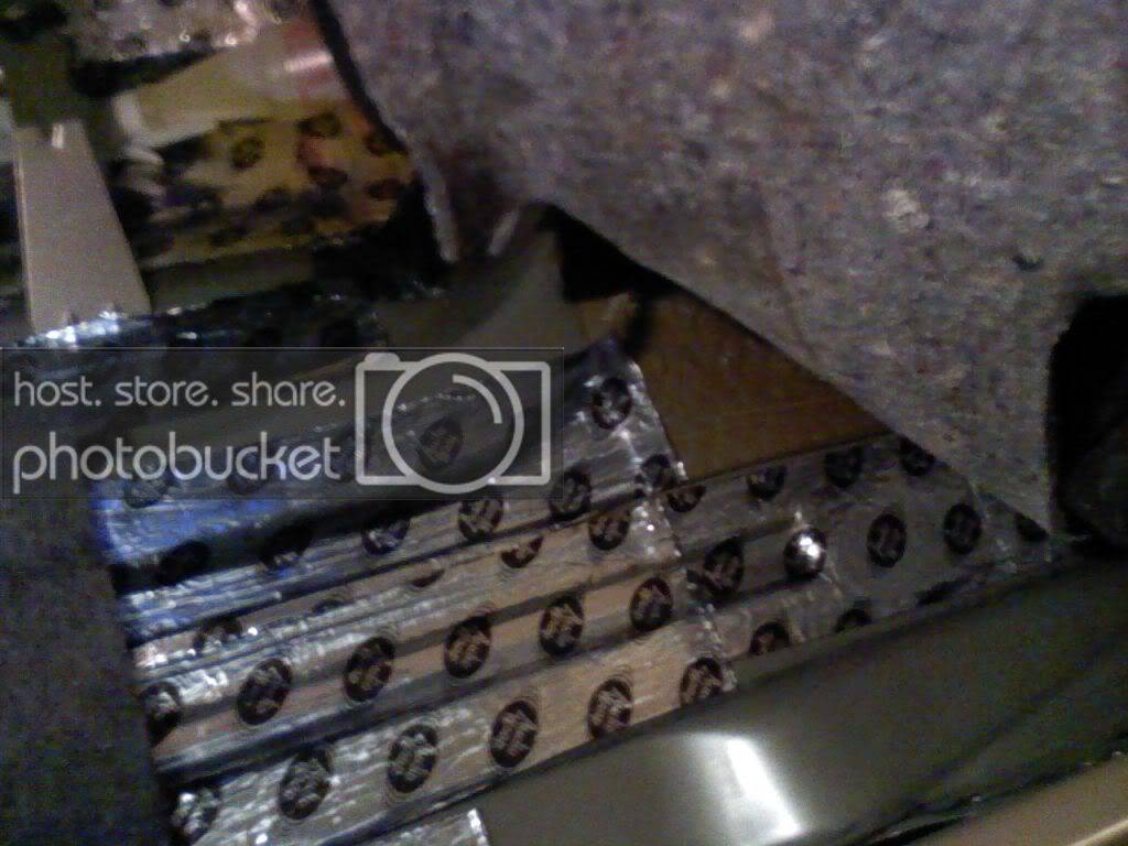

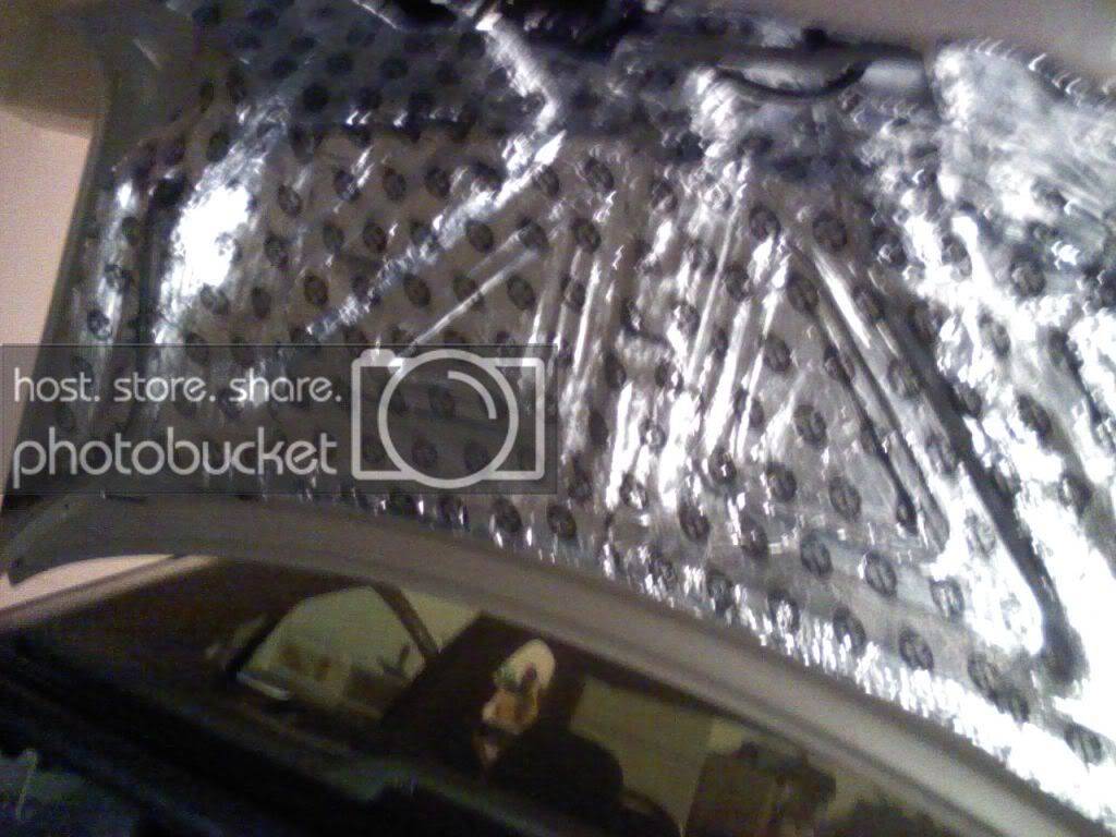

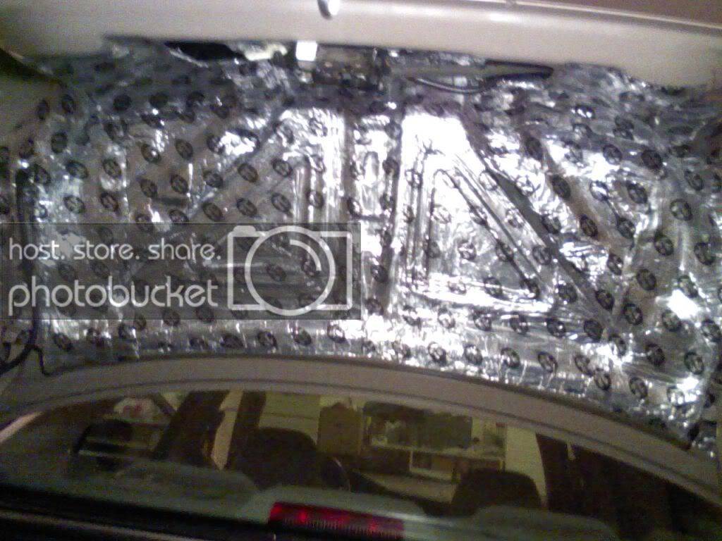

12.5 sqft. of AudioWrap (Review coming soon!) Then buying another roll for trunk

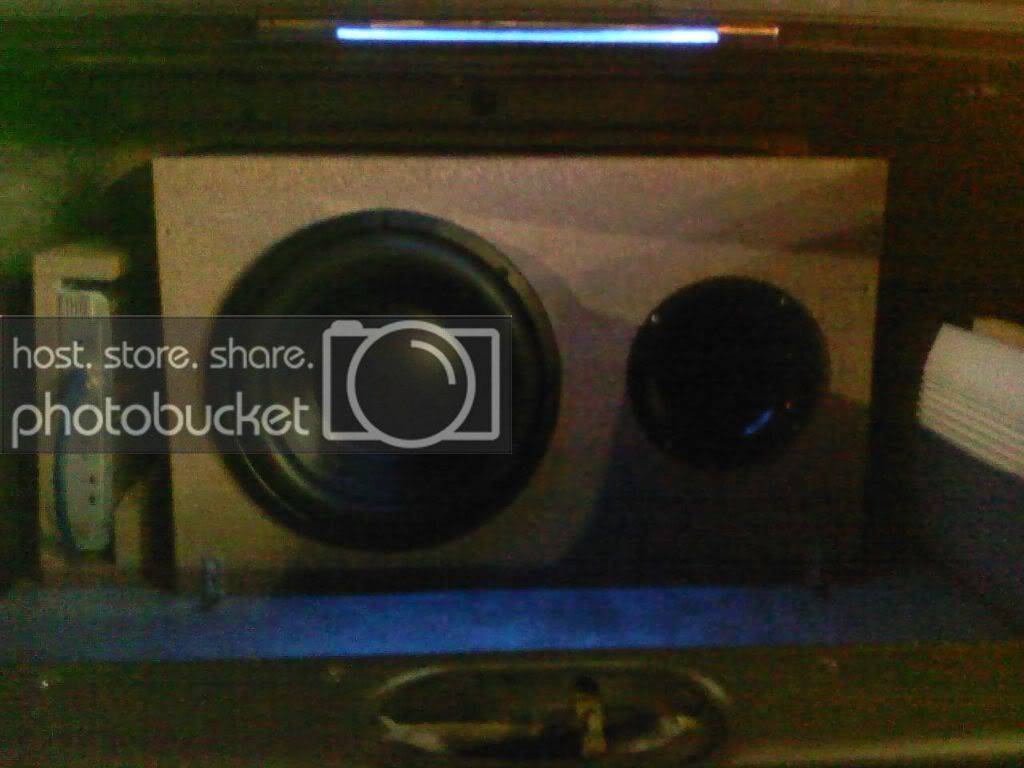

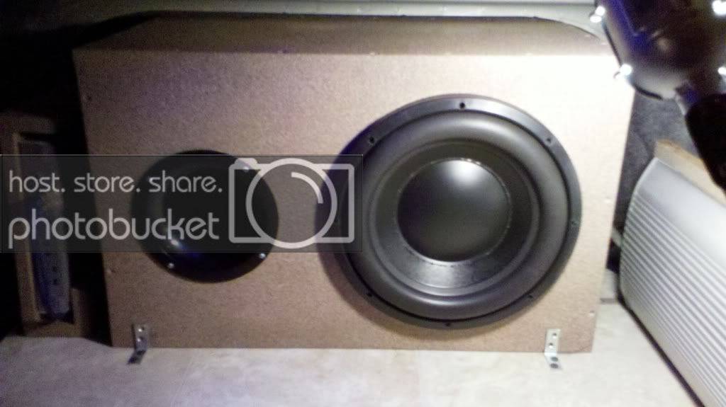

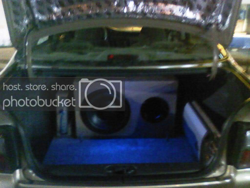

UPDATE: Finished product below...for nowww //content.invisioncic.com/y282845/emoticons/smile.gif.1ebc41e1811405b213edfc4622c41e27.gif lol Building a 2.0cuft @ 33hz in the spring. Along with doing the Big3 and adding a battery in the back.
What you guys think?
Just an fyi, a 4" aero isn't enough port area for a 2.5 cube box. Everything else looks great though. //content.invisioncic.com/y282845/emoticons/smile.gif.1ebc41e1811405b213edfc4622c41e27.gif
Yea I worked at Tontine Carpet One for my first job. I always go back in there and pick up leftover supplies. I glued it down to 1/2" playwood. Works for a perfect false floor and looks clean.
