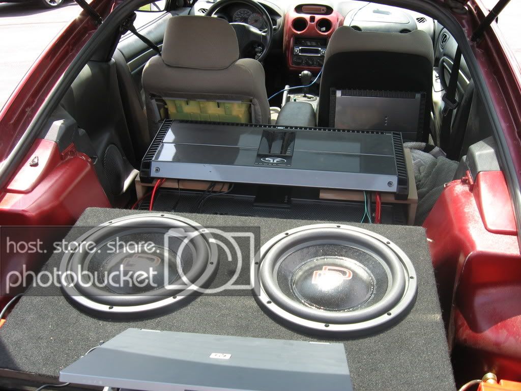

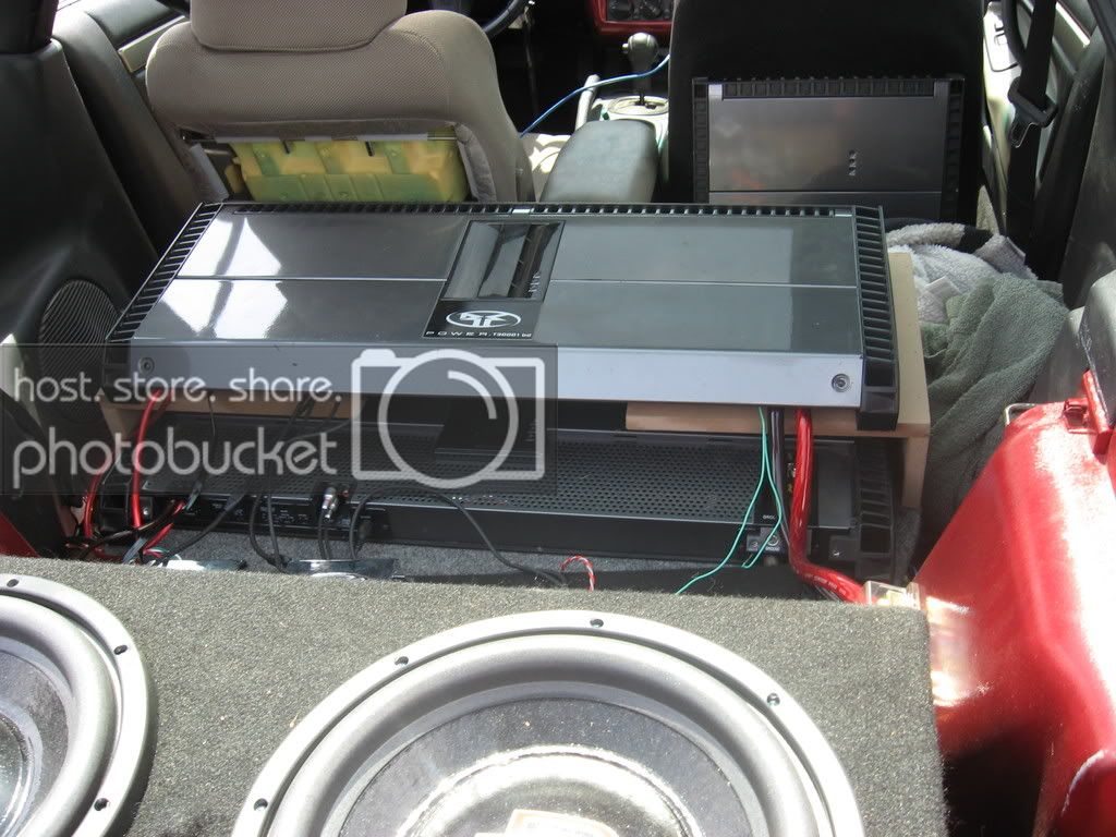

Pics as Promised:
I still need to screw the ports to the box and glue in the port braces in those pictures, I have since done this. Seeing everything together really makes me wish I had an extra $200 to blow on subs right now hahaha oh well.. couple weeks //content.invisioncic.com/y282845/emoticons/biggrin.gif.d71a5d36fcbab170f2364c9f2e3946cb.gif
