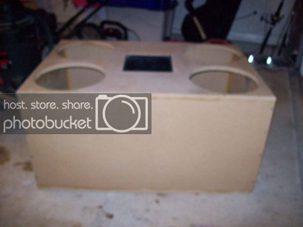

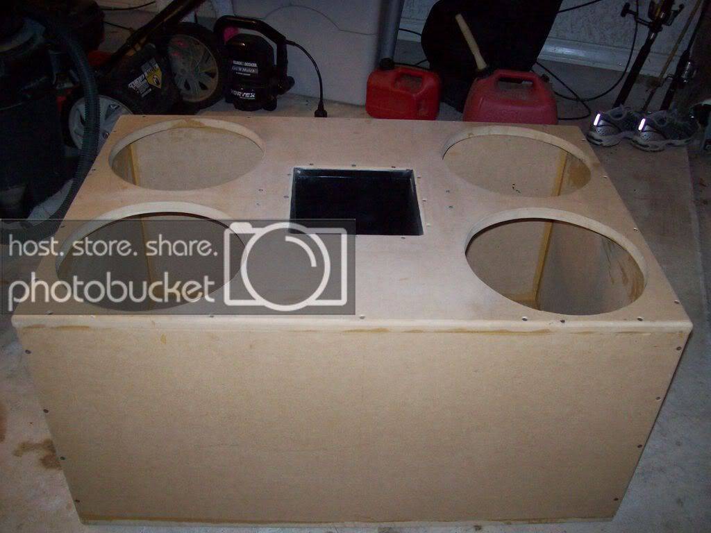

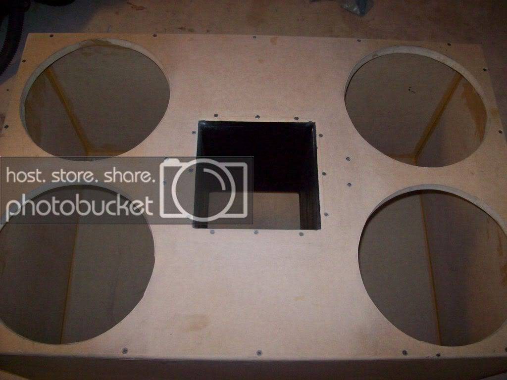

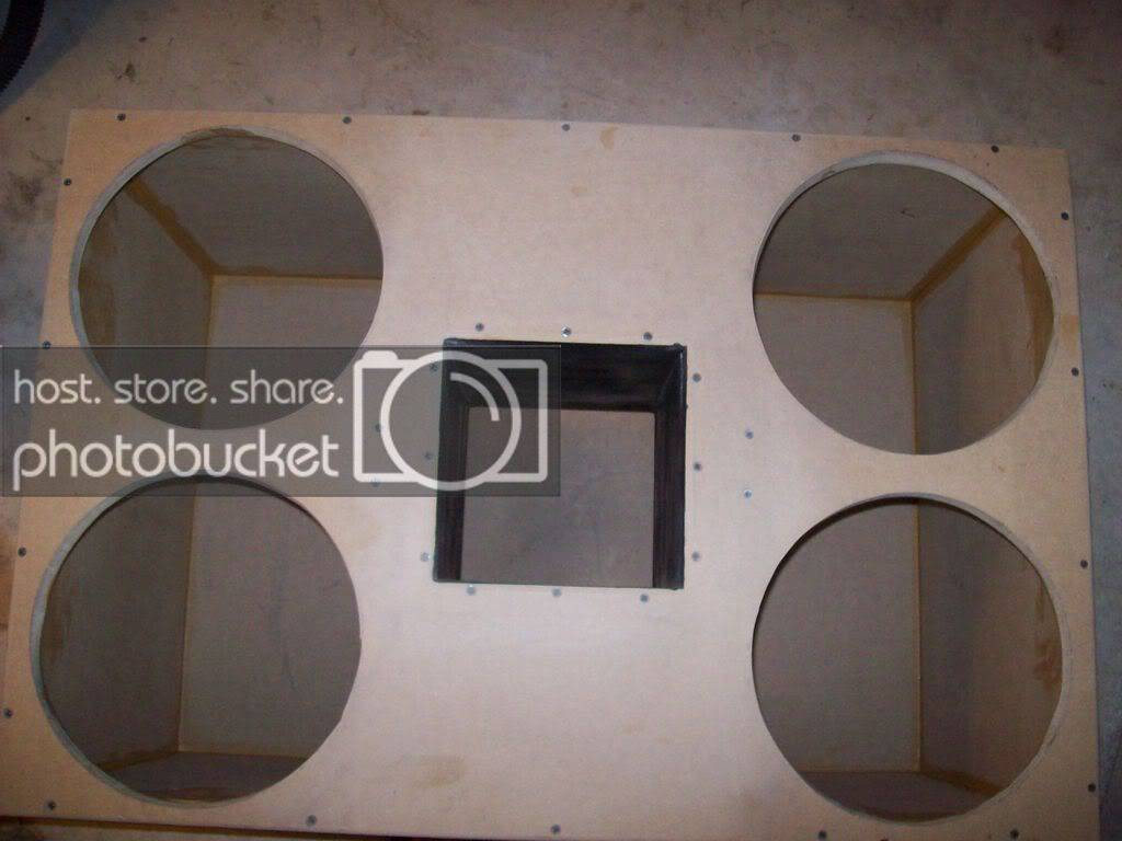

It is for 4 12's. 7.3 cubes tuned to 33.5hz with 68" of port area. I built it for a guy for his crown vic. He is going to be puttin 4 12" kenwood kfc w3011 subs in it. That is what he told me to build it for so I did. I'm hoping those subs sound decent and I'm sure they will get loud in this box.
what year Crown Vic? why port up in a trunk car?
x2, but suprising loud, I fliped my box since its the same height and depth and fired it up (sub and port) at the trunk lid.
Got alot more output into the cabin, but my rear deck has no speakers and a large hole in the center stock. More rattlling though, //content.invisioncic.com/y282845/emoticons/crap.gif.7f4dd41e3e9b23fbd170a1ee6f65cecc.gif

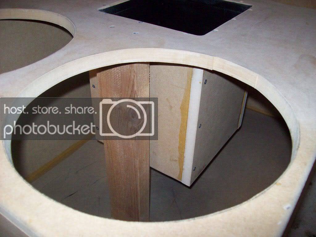

You can't see it, but there is another 2x4 on the other side. I wouldn't just put one 2x4 in it.
That's what I meant; I could see the other two screw holes. The key to bracing is to couple the widest expanses of each panel to the opposite side, or ideally, to the surrounding four sides via a shelf brace. That means, you need braces between the subs on all sides and above/below the port instead of just aside it.
I will see how it does with those subs and hopefully he'll get some better ones. I will look in to the bracing it's just that **** port is right in the middle and I can't exactly do a shelf brace now whoops. I will see if I can conjure something up. Thanks for the advice.
