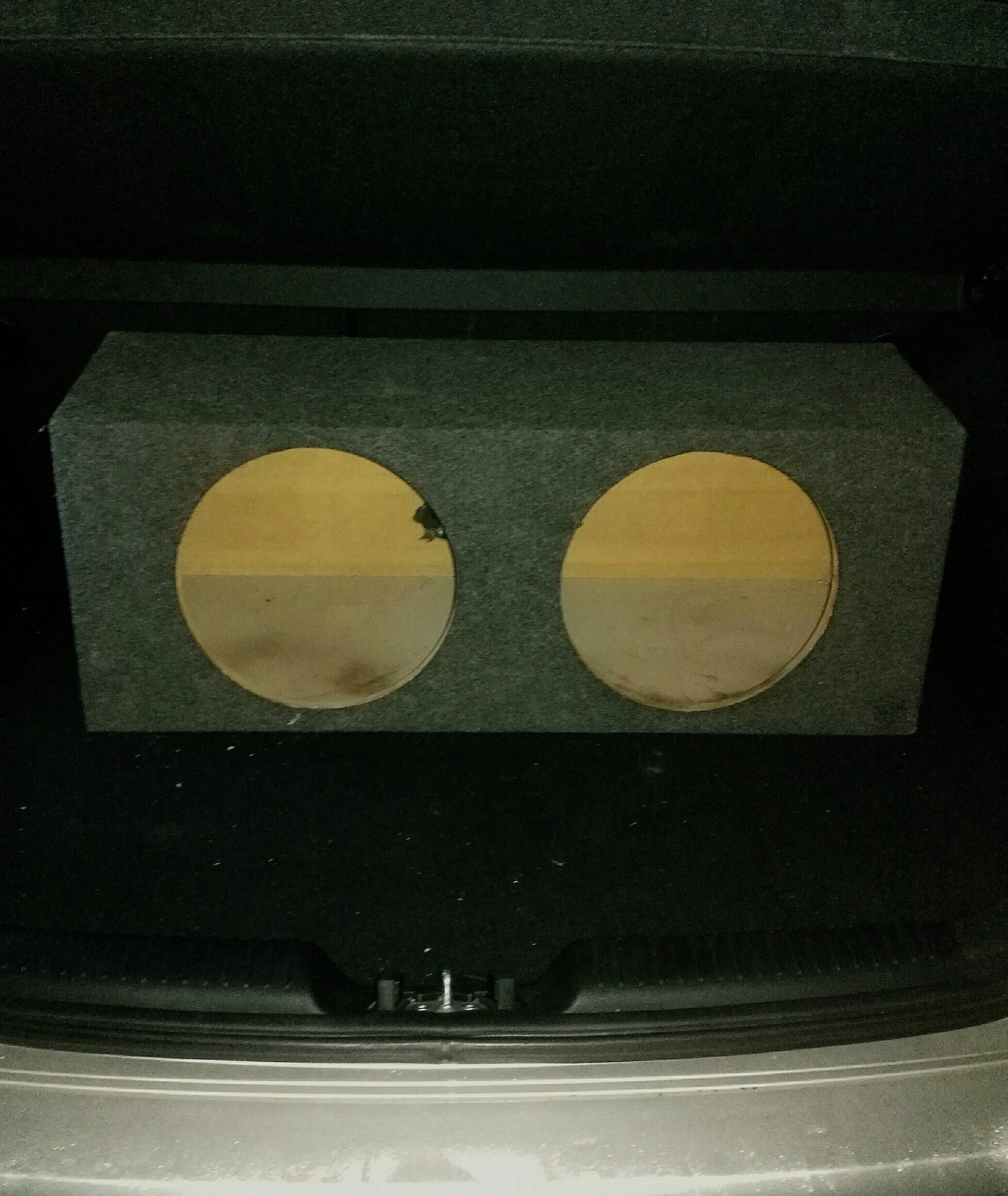

The enclosure is a slant(wedge 2) dual sealed enclosure with seperate chambers.

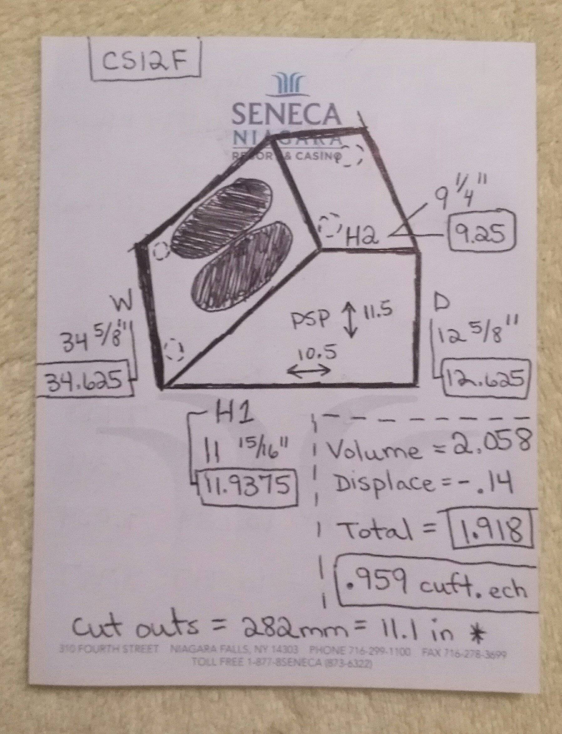

Dimensions are:
34.625"W X 11.9375" H1 (Bottom Height) X 9.25" H2 (Top Height) X 12.625" D
Thickness = 5/8" MDF.
I figured my subs will get 0.959 cuft. each. If I go ported, I was thinking a 2" flared port in Each chamber @ 9.35" long will give me 30hz, but that would leave me with only ~1-2" from the wall depending on what sides I cut into. I am worried about port noise, especially if I throw more wattage at them.
If someone can check in bassBox or winsid, I'd like to see what has a better frequency response and higher output; sealed or ported (and what Hz is best). I want to get low for movies, but still sound good for music (rock and rap). Or tell me what size port and length I should get.
Here is my design (the slant is not that prominent):

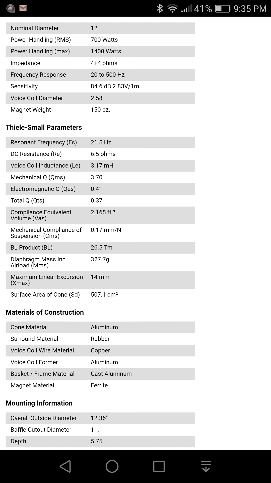

Here are my driver parameters:
