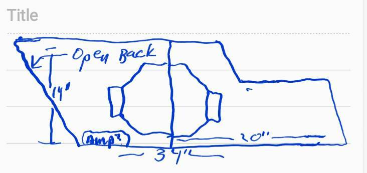

I am finally designing the console I have been envisioning in my head sense I bought my truck 10 months ago.
I saw a clamshell isobaric setup when I was a teenager and have been stuck on the idea of having one ever sense.
I recently put in a JVC kw-v31bt head unit and purchased a couple used kicker c10's. Is there any reason I should not do this and would they be wired in parallel or series?
I am open to pros, cons, or flat out other ideas. I like rich ful sound not distorted crappy bass.
I did find a set of MB Quart marine speakers that consisted of a 10" sub and 2 tweeters on the grille that I thought about as I can get a pair for 150 brand new. I would have to have them both facemounted to either side of the console though.
This will be installed in a daily driven work truck.
Sent from my SM-N950U using Tapatalk
Isobaric loading is the output of 1 sub in 1/2 the space. They have to be wired out of phase. Personally I would run both subs downfiring with port going out the back. You wire the subs series or parallel depending on your amp.
yeah isobaric is just doubling motor force and reducing enclosure size. it wouldn't be as loud as just 2 drivers mounted normally.
