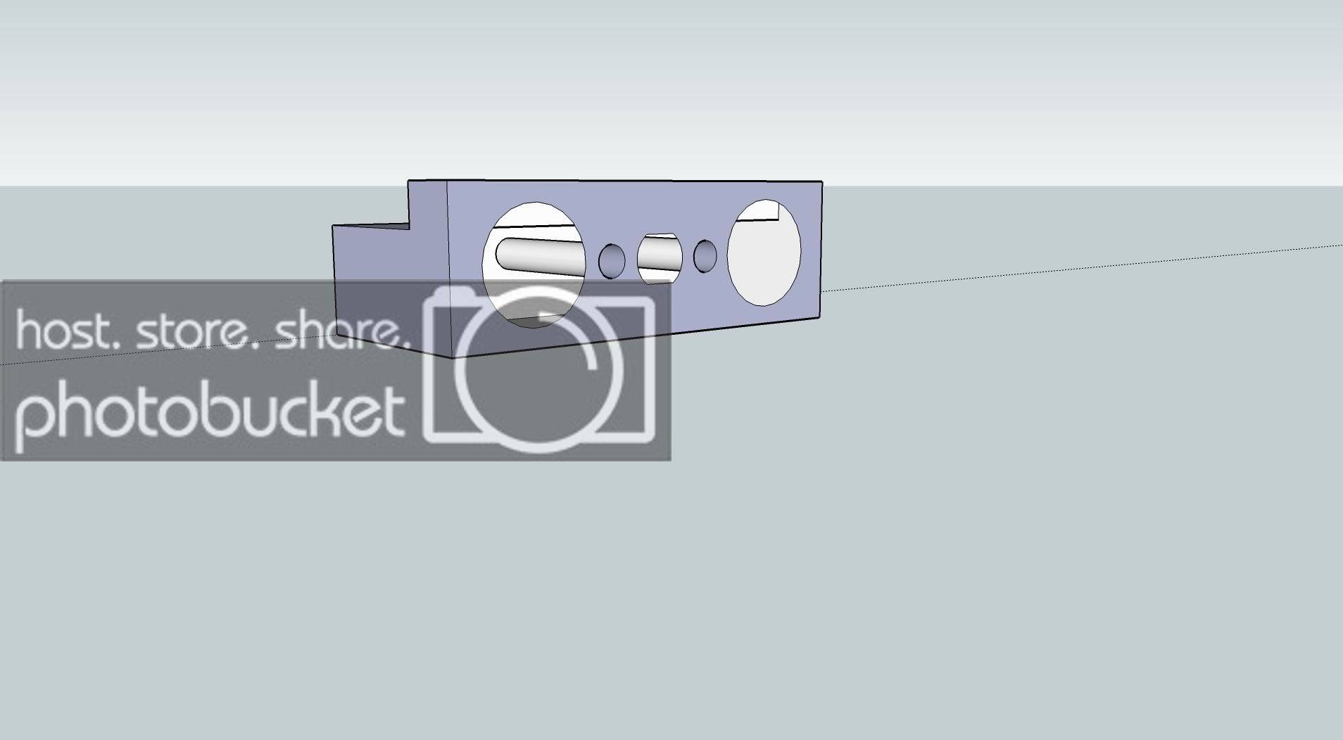

This is a sketchup of the enclosure I have planned. It should be about .4 cubic feet tuned to 55hz after displacement. I used WINISD to do the calculations as I've never build a ported box for anything but subwoofers, but the response curve looked good for the woofers. It will act as a monitor stand also, that is why it is taller in the front, to fit the 5.25" woofers but keep my monitor at eye level. Anyone see any problems with my little plan? The center channel of the amp is rated at I think 69W@8ohms RMS.
I don't understand the fascination with an MTM center channel. It makes absolutely no sense to me.
One of advantages to running MTM setups is you reduce dispersion in the vertical plane, thereby reducing reflections caused by the ceiling- and more importantly- the floor ( floor bounce cancellation).
What happens when when you tip it on its side? Reduced dispersion in the HORIZONTAL plane. So what happens when you are not sitting directly on axis in the horizontal plane? uneven response and a reduction in volume.
But meh, do what you wish //content.invisioncic.com/y282845/emoticons/smile.gif.1ebc41e1811405b213edfc4622c41e27.gif Better idea would be to do 2.5 way, with one of the woofers only playing midbass if you really need the extra output and reduction in distortion.
Well first of all, I'm not very educated on the subject and have very little experience.
Second, as far as I can understand, I'll be exactly on axis for the center channel. It will be probably 3-4 feet from me, at about chest height. Off axis response is not really a concern when the speakers are all pointed at a single chair, right?
