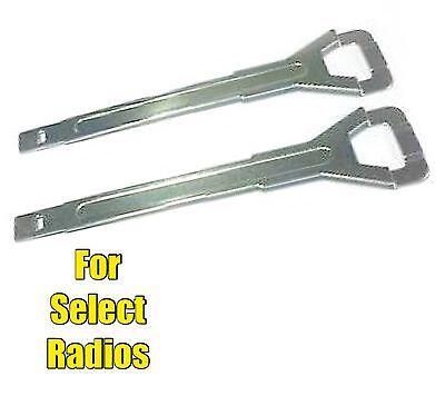

You had trouble trying to remove it for lack of tools. If it has two small holes on each side of the radio or trim ring, you can insert four long nails (or similar objects) into them and pull out the radio. If you have to get get a new radio, most use a standard connector so it will most likely be plug & play.
Radio is after market (from Best Buy no less) Sony Xplod 52w x4
What you probably need is a need is a set of removal keys.
With the unit powered off, you push (kind of quick snap-push to get the face to pop off on one side) the face on the right or left side (right side on my Pioneers) and the face should pop out, then you unlatch it.
They go into the sides of the unit with the face off.
