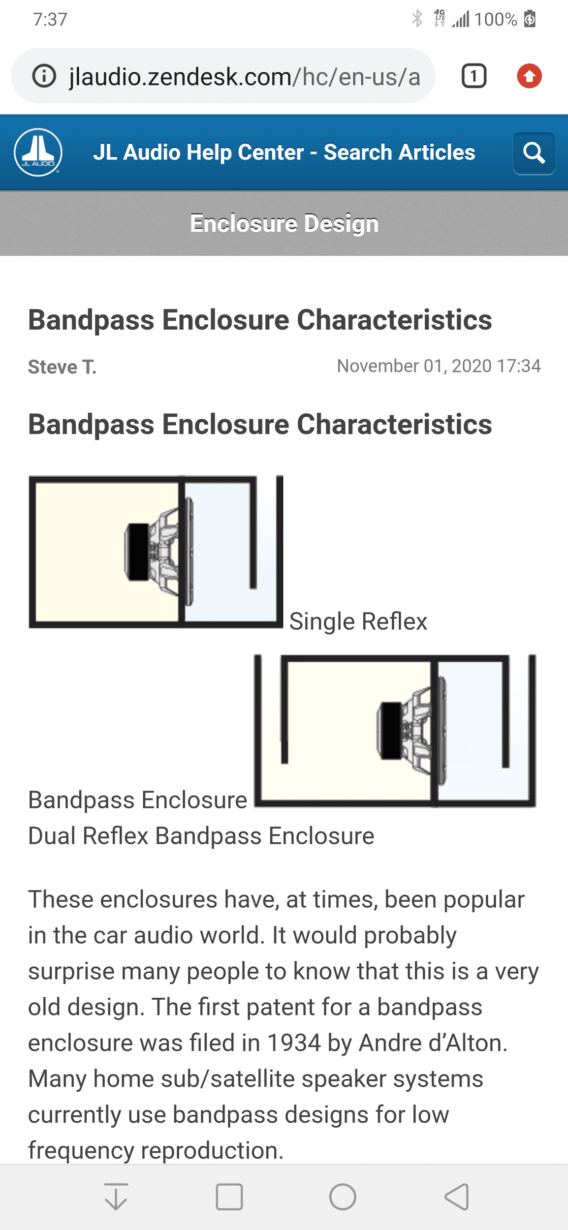

What you are describing here is known as a bandpass enclosure. The sub is mounted in a sealed box with the opposite end firing into a ported box
Alot of users love the loud boominess while others opine that it is mostly a one note wonder. Meaning that it plays a small band of the spectrum very loud while lacking on the rest. I would personally advise using a sealed enclosure. You would be surprised how low it can go, and uses less space.
