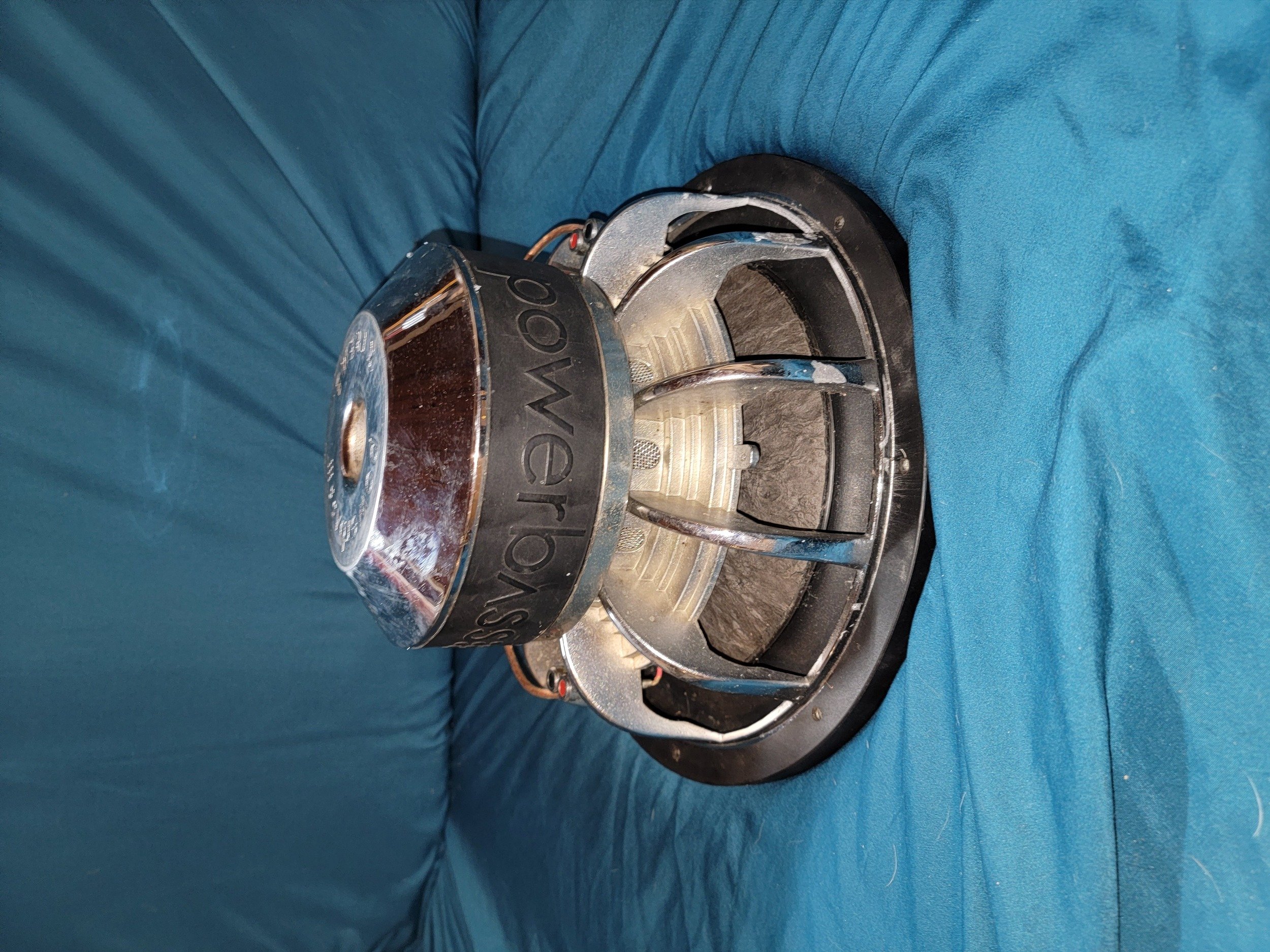

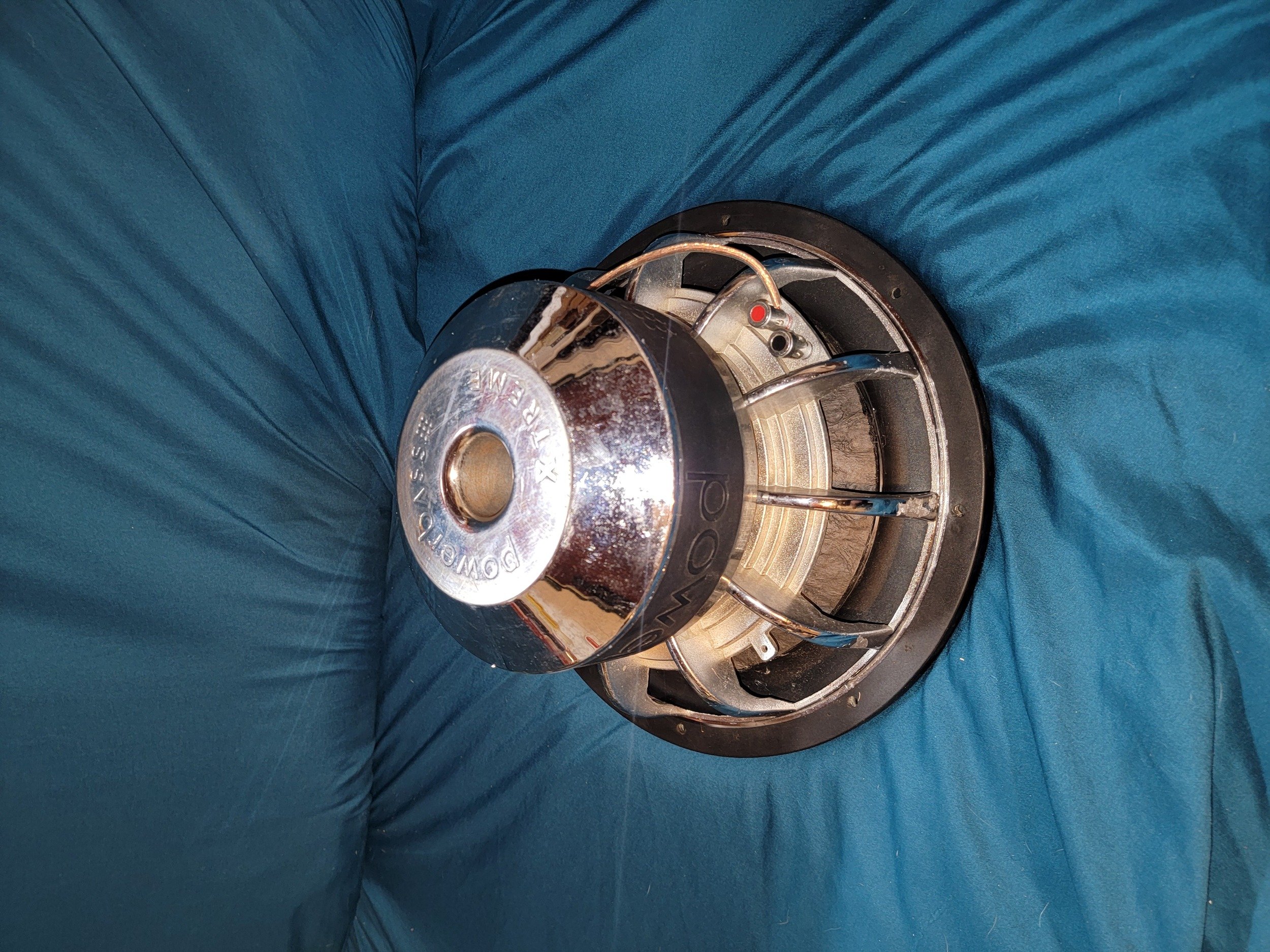

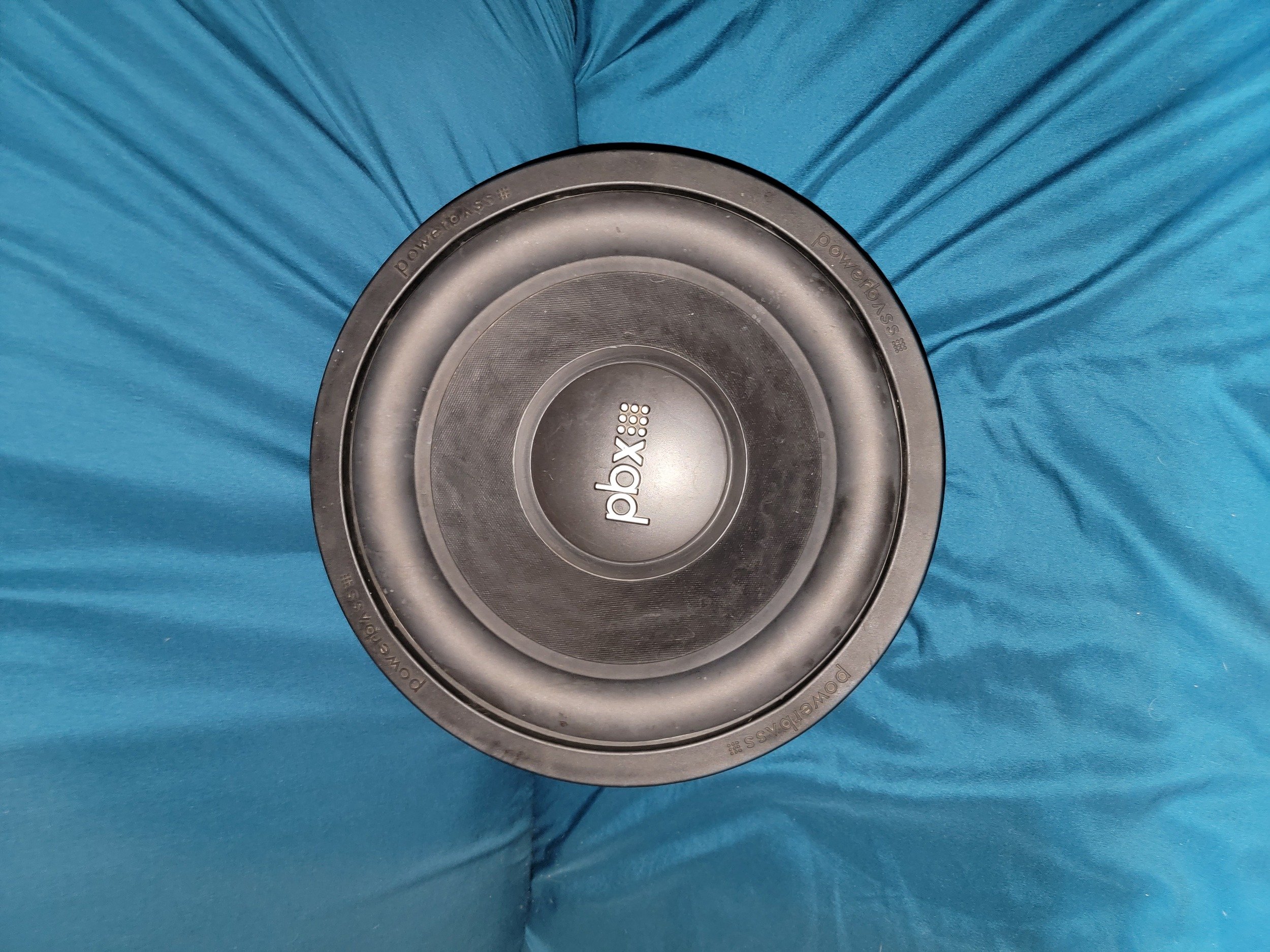

So i have an old powerbass 12 that i just can't seem to find the specs on.
I think it is from roughly around 2005. Powerbass xtreme 12. Has the chrome 12 spoke basket and motor. It's a 2ohm dvc. I don't currently have pics but can get some later. I believe it's based off the old tc sounds 3hp?
Anyway, i just need to know specs so i can build a box for it.
Thanks!

Apparently; it's a PBX XS12 v2. Not sure if those are the right specs.
Power Handling (Rms / Peak):
800 / 1600 watts
Frequency: 25Hz - 500Hz
Nominal Impedance: 2+ 2ohm
Sensitivity (1W / 1M): 90.1 dB
Fs: 31.5Hz / Vas (Liters): 36.96
Qts: .33
