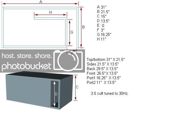

can you guys confirm this box design?
youngstunna
i got this design from scott from fi and i was just wanting to make sure its legit...before i got a incorrect box so i just wanna know what you guys think?
yea he did it for free for me...i know he the owner of fi and all its just before i got a wrong box design thats why i came on here to see if you guys would kno if its right..not that i dont trust him and all..i just dont want any mistakes you know?
