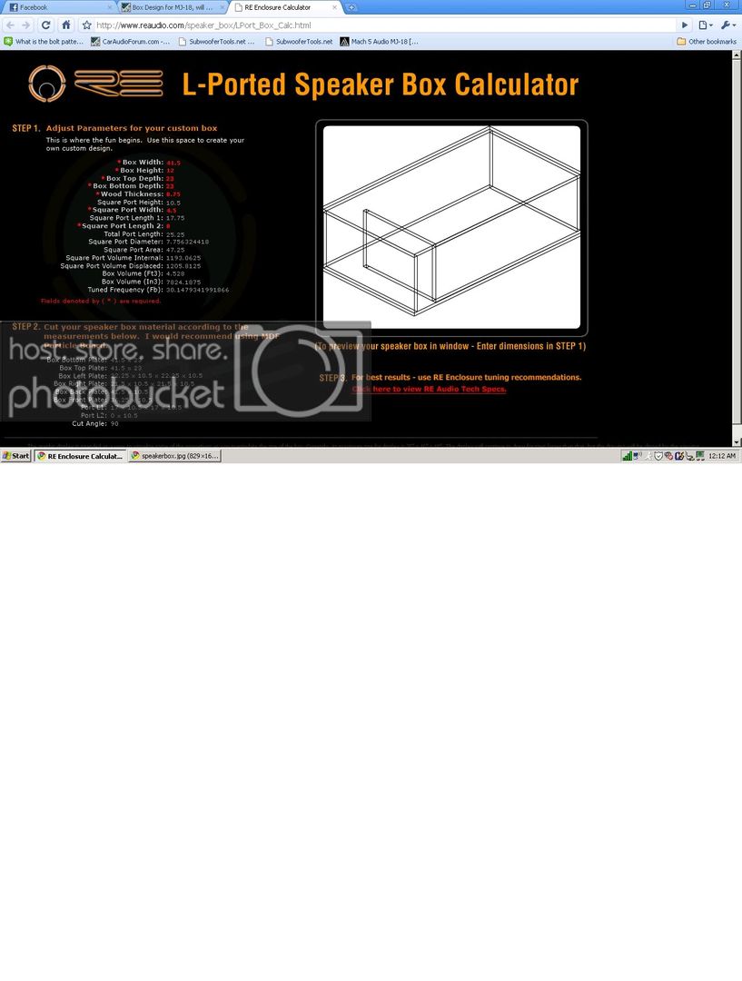

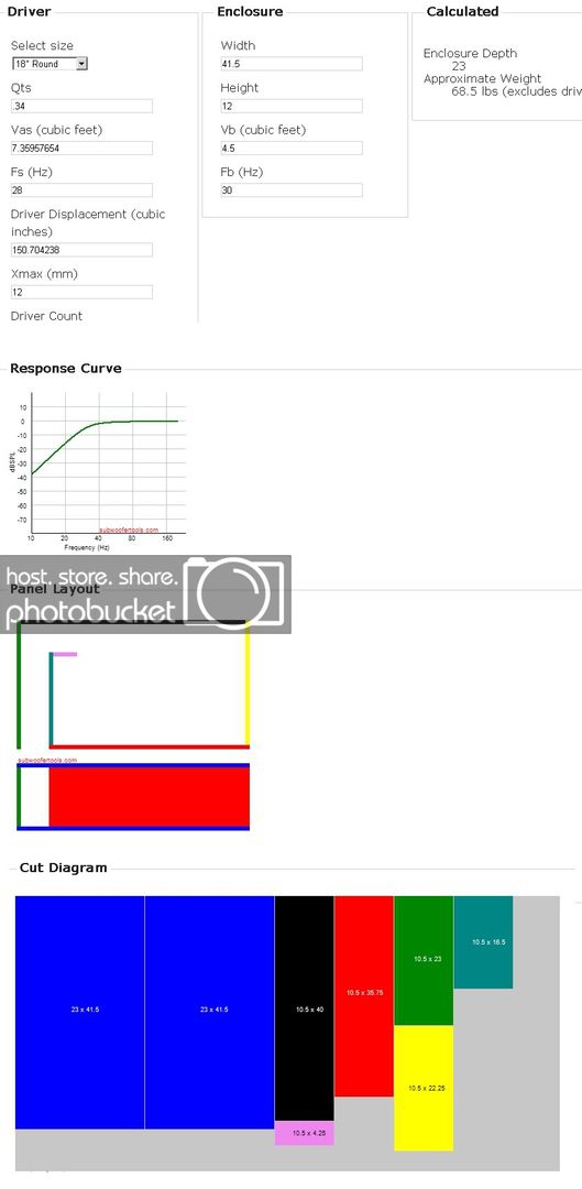

I tried to design a box with subwoofertools and the RE Audio box designer, can someone verify for me? It's been a WHILE since I've done this!

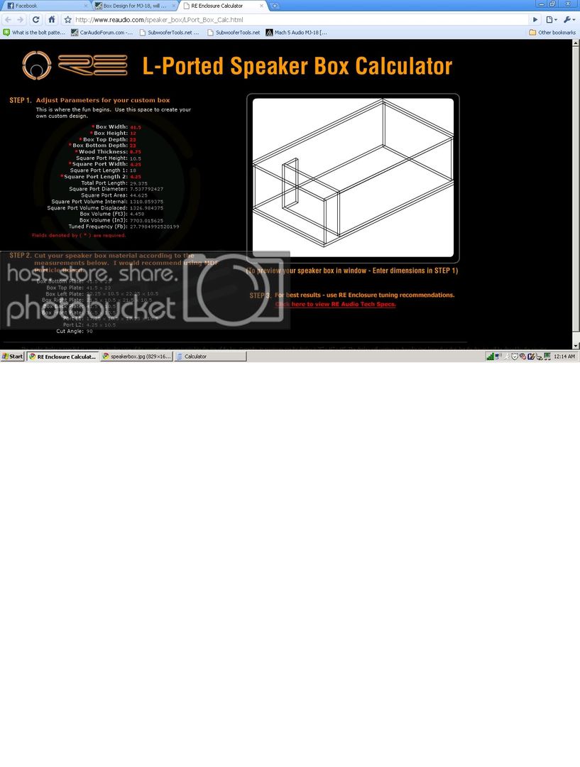

Any comments, suggestions or advice are very much appreciated.
port area kinda low
Maybe I'm doing the math wrong, but I get 10.01 cubic inches of port area per cubic foot... Isn't it recommended to use in between 5-12 cubic inches of port per cubic foot?
