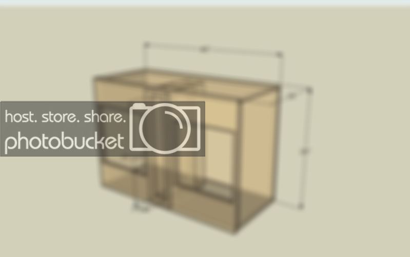

Here is the box I was gonna use, which I believe is tuned to 50 hz for comp:
(Doesn't include extra 3/4" baffle on front)

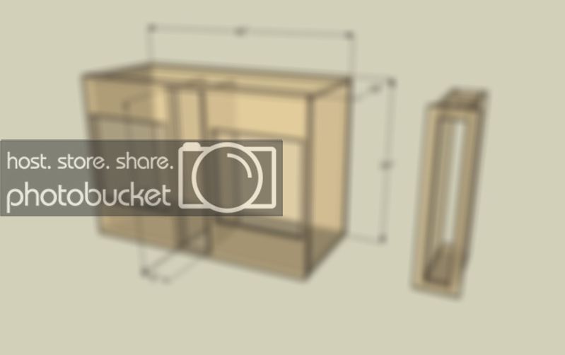

Then I was gonna plug the port so it was this size for daily which cut the tuning down to 35 hz I believe:

Well with 2 subs sharing the port if you do a 4 inch wide port its going to be aprox tuned to 40hz i believe.
I'm wanting to do a 5" wide port for SPL.
Then want to make a plug to make the port smaller to lower the tuning for daily.
SPL:
Slot Vent Width: 5.00 inches
Slot Vent Lenght: 12.00 inches
Net Volume: 5.23 cu/ft
Tuning Freq: 49.94 Hz
Port Area: 97.50 sq/in
Daily:
Sq Vent Width: 3.00 inches
Sq Vent Height: 17.00 inches
Sq Vent Length: 11.00 inches
Tuning Freq: 37.25 Hz
Port Area: 51.00 sq/in

Per you PM, here is a multi port design for your drivers.
SPL
Net Volume: 8.25 cu/ft
Tuning Freq: 50.00 Hz
Port Area: 132.50 sq/in
Daily
Net Volume: 8.00 cu/ft
Tuning Freq: 36.00 Hz
Port Area: 82.25 sq/in
That looks awesome rpfuror! You need to teach me how to make sketchups look that good. What program do you use to make your calculations?
Only thing I'm really worried about is havin too much port area on the SPL setup.
Edit: Also what is the lengths on the port?
