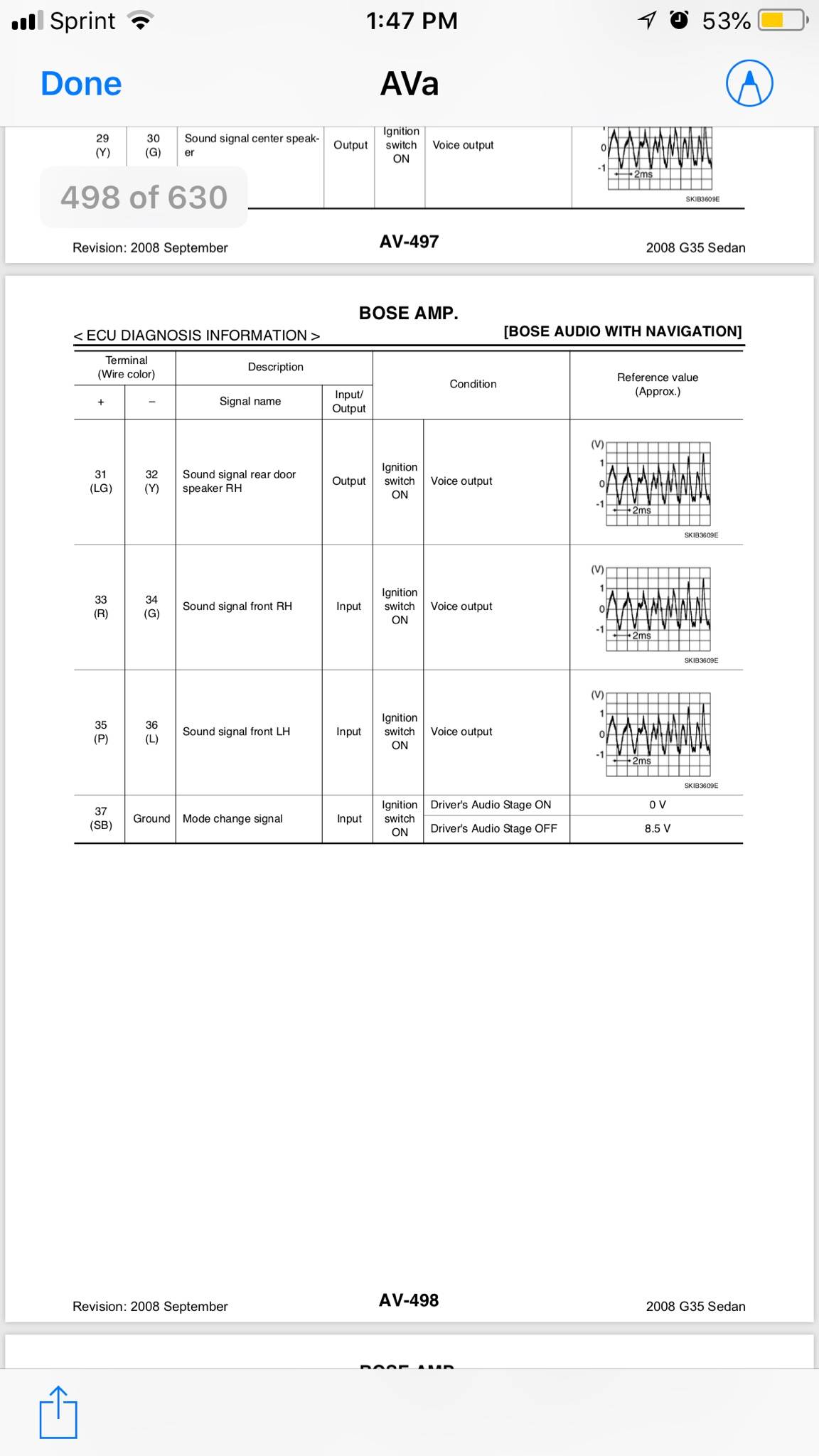

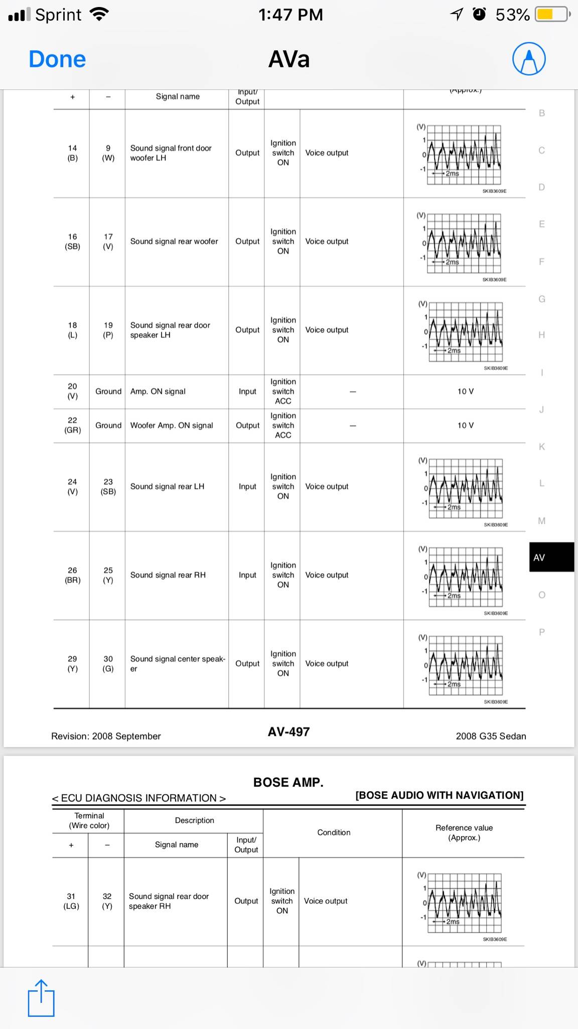

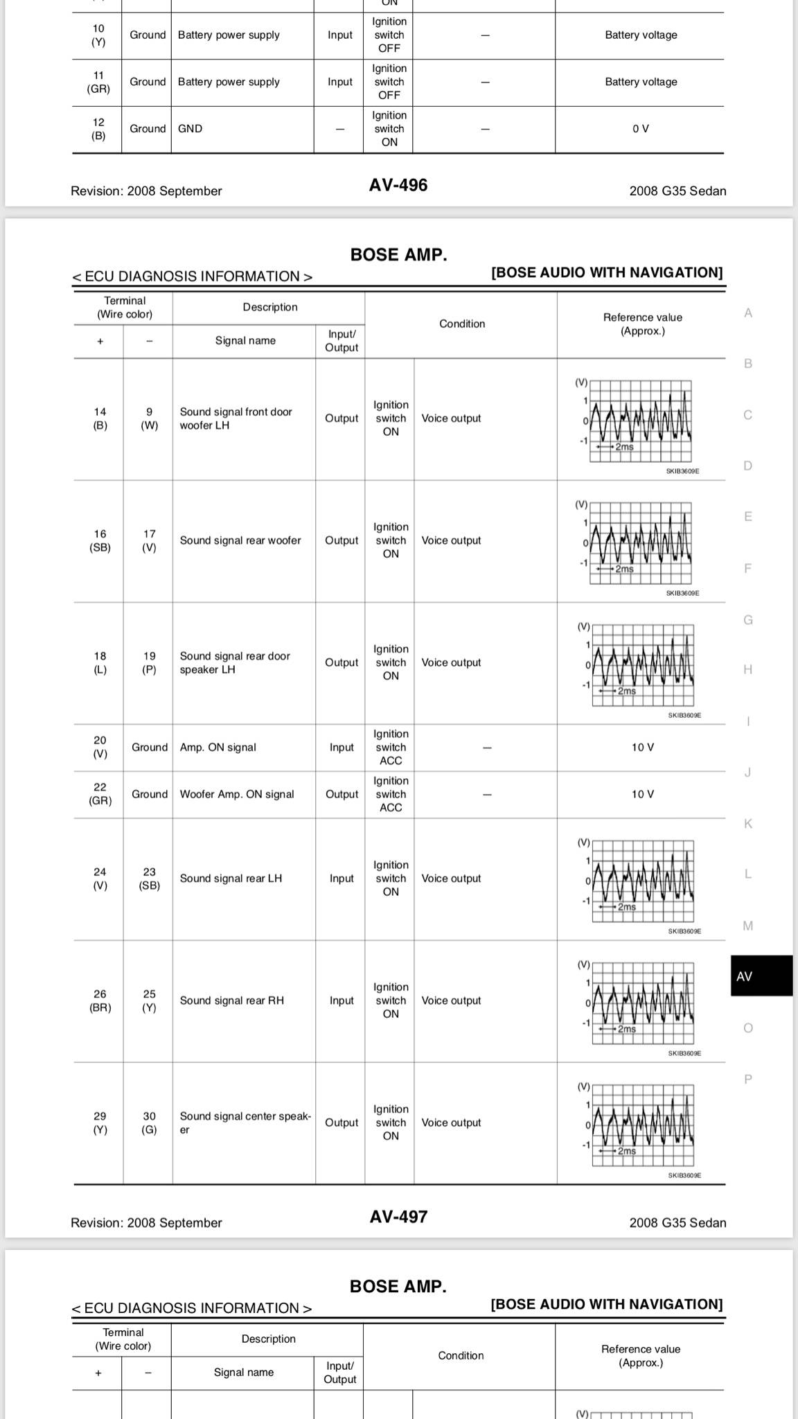

Can u tell me what wires go into the 4 channel loc and what ones go into the wiring into the amp it's a 4 channel amp running to 6.5 kickers I had installed in the doors the sub works fine on another loc and amp it's a 2008 g35 I have included what i am going off and it's tapped in to the bose amp harness the bose amp is long gone
Well ty grandpa I am gonna guess that the inputs go to to loc I cpuld be totally wrong but i am gonna try it and see
Ive never seen this amplifier before. Can you take a pick of the back? Interesting amplifier.
