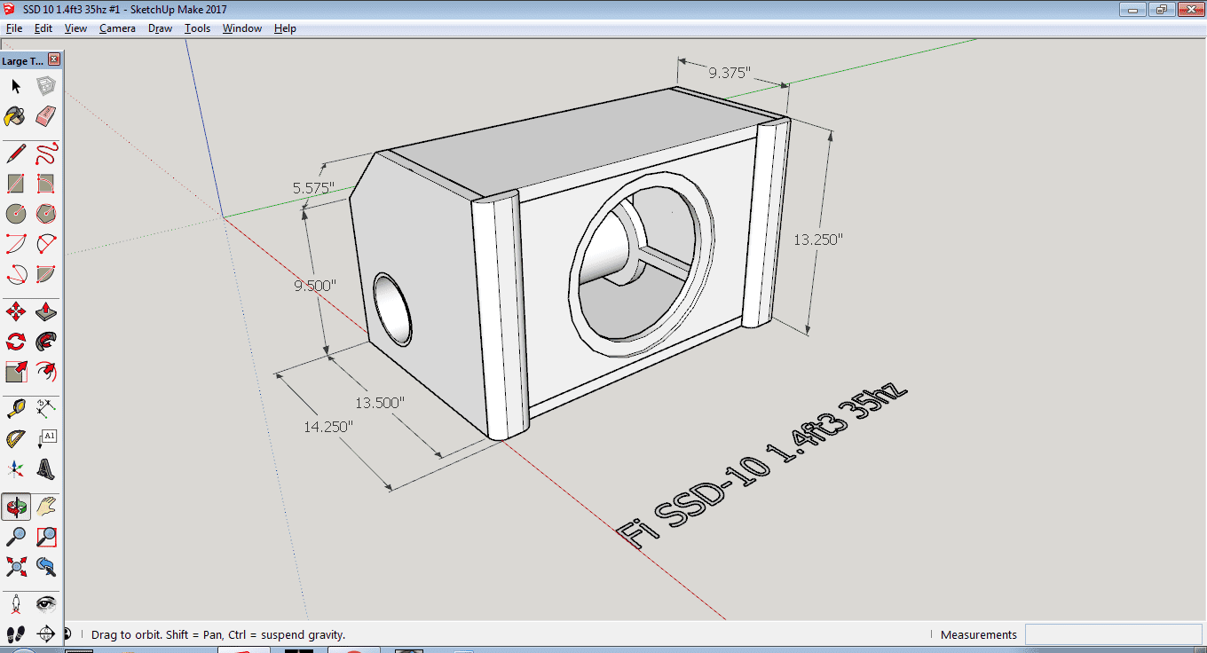

Its been a long time since Ive designed a ported box and I really don't have the time to relearn everything I forgot. So, If it is even possible, I would like someone to design a ported box (Round port preferred) and I will pay you whatever you think the design is worth.
I do not have alot of room to work with and I included the dimensions of the sealed box I built and am using now with my DC LVL. 3 12"
The only dimensions that can be changed is the length of the box and would like to stay around 22" or 23" but can go a little longer if necessary.
Subs I would like to use are the FI SSD NEO Q 10" which is my first choice or the FI SSD 10" which is my second choice.
Definitely want it tuned more toward SQ and I listen to mostly rock, pop, techno if that matters.

Yes, that box should work perfectly because it is the same dimensions as what I am using now for my sealed box. What is the length of the one you made? Looks beautiful. If you want to PM the plans and the size of the port I need I will send you whatever you charge via PayPal if that's ok?
I'm guessing you couldn't get the ssd neo to fit? The depth of that sub looked like it would cause a problem with trying to fit the port behind it.
It's 22" long... and I don't charge... tomorrow I'll expand it and dimension the panels... pm me your email and ill send it over then... my pp is my email so any donations appreciated but not necessary... are the .75" standoffs on the baffle gonna be an issue?
Glad to assist... just email me some pics of the box being assembled and once installed please.
I'm sorry... I had the driver in my database already and I whipped it up and knocked it out quick-like.
And the port IS offset so it could fit possibly, I will look tomorrow.
No, those standoffs won't be a problem, as my box sits now I have about 2-1/2" to 3" of room between my sub and seat.
