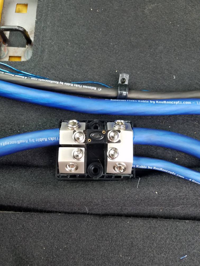

Should I connect another fuse going across the 4 gauge to the blank spot with no wire going to would that do anything ? I have an extra 150 anl fuse

The way you have it wired now it won't make any difference. If you flip the distribution block around and use it as intended you would need to fuse it. I would recommend flipping it and adding the appropriate fuse for each amp.
