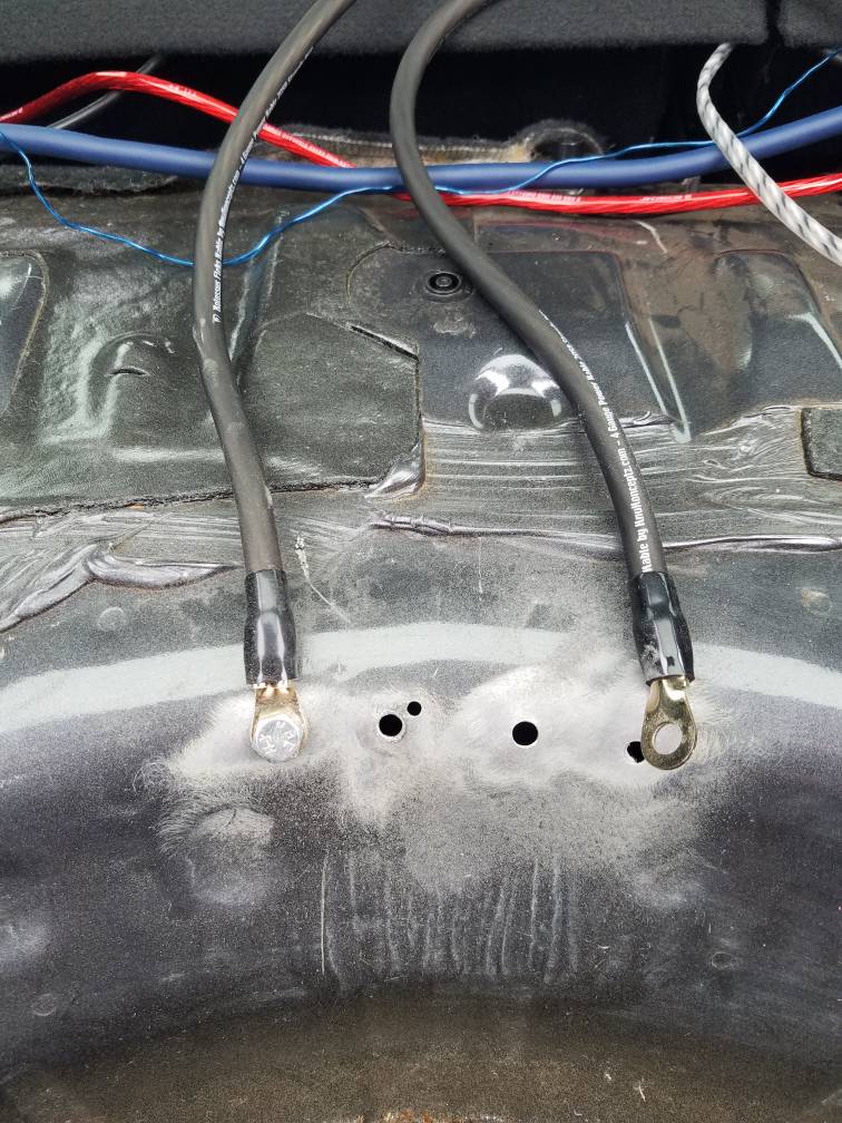

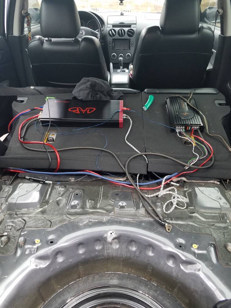

Can my ground be 3ft for my amp?
ekah
Seems that's the shortest it can be since its bolted to my back seat and using my tire well as a ground
Sent from my SM-G935T using Tapatalk
My amps are 10 feet away, up a 0AWG cable to the neg battery post. I had what I thought was a great chassis gnd 1-2 feet away but it caused weird unloaded amp heating! Gone with the 0AWG to the neg battery post!

Yea. Grounds are funny. I have had alot of trial and error over the last year. Basically what is found out was, some places sounded better than others. Try a few different spots. One of the best tips i can give is to make sure the metal is very very clean. And the threads of the hole you make.
Sent from my LG-H910 using Tapatalk
Threaded holes in sheetmetal??? I've used bolt/nut combo.
Bare metal to bare metal is always and will be best.
And after the ground is complete, there's some sort of spray can that you shoot a little of to prevent rust. I have no idea what it is but is def recommended. Maybe a rust prevention or something...?
If he was using a existing bolt hole i meant.
run it directly to the negative battery terminal lol
you couldnt run it directly down and to the left/right grounded to a subframe piece by the doors ?
It should be a couple of mounting bolts to the seat on the same side as your ground output on your amp have you thought about using them?

Installer guy already installed a 0AWG 10 foot cable to the pos battery post. It was easy and good and did the job as intended!!
And me and installer guy first found a big ole bolt like a seat frame bolt and installer guy removed the bolt then wire brushed down to bare metal and put a crimped wire terminal to 4AWG wire to the amps, and my PDX-V9 amp got weirdly way too hot so I decided to quit playing aroujnd and have installer guy run the 0AWG cable to the neg post on the battery, and PERFECT! Amp overheating disappeared.
