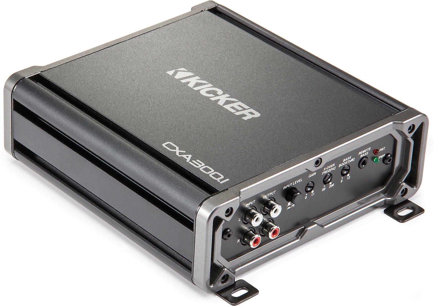

This the amp

Well that's a mono block, not a 4 channel. It says it's 300w@2ohm, doesn't mention 1 ohm so I wouldn't go lower than 2 ohm impedance.
With that amp, you'd want something that is dual/DVC 4 ohm coils so it can be wired to 2 ohms and get 300w.
Pretty much you'll be looking for a 300 watt RMS sub thats 4 ohm DVC.
