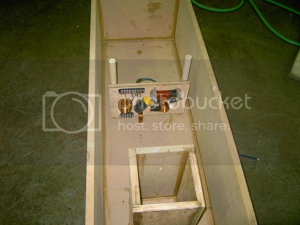

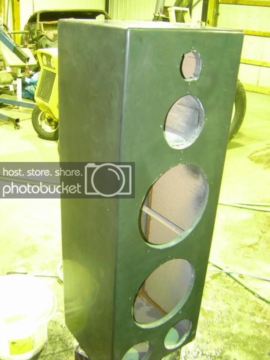

The following pic shows the two dowel rods that have two purposes. These purposes are: to act as bracing and to mount the x-over. I think it looks pretty good, and it holds up really well.

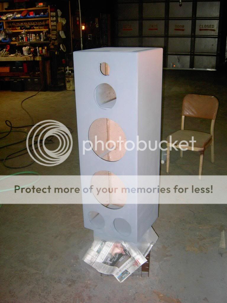

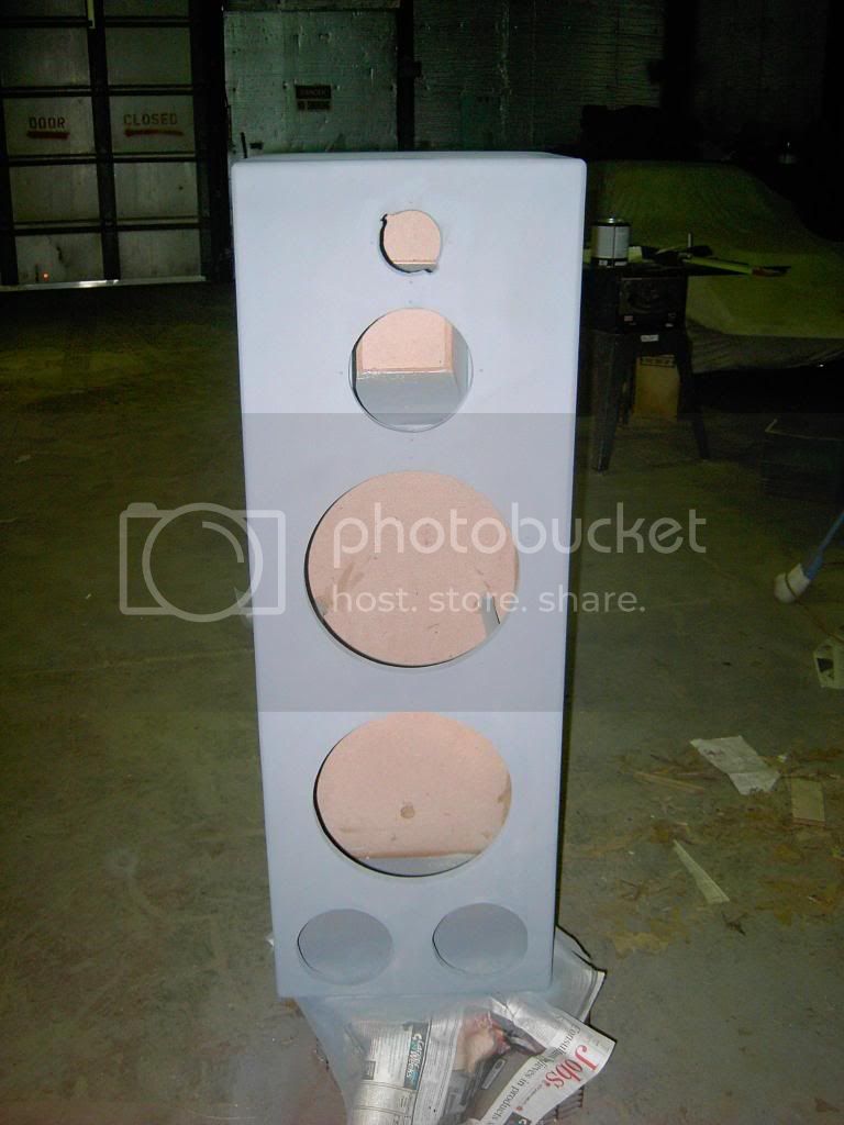

The next two pics are the cabinet primed. I put about 6 aerosol cans of primer on this *****. I also sanded it with 220 grit sand paper. Let me tell you, the primer gunks up the sand paper so many pieces of paper are needed.

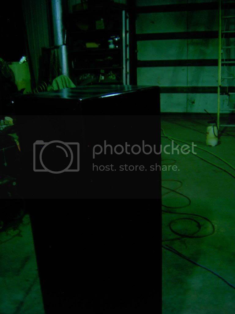

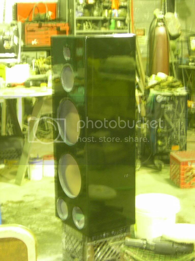

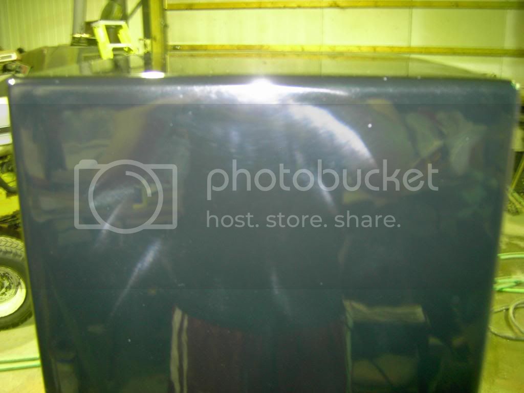

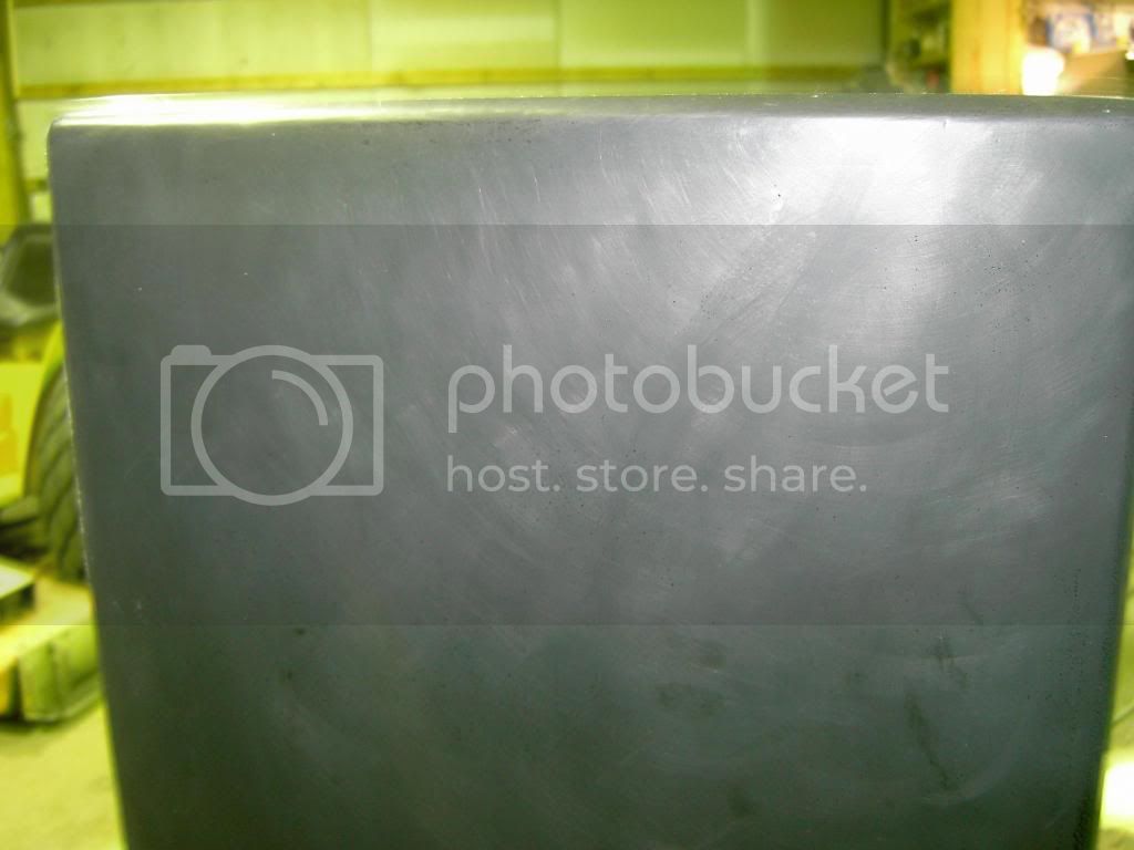

Painted about 4 coats of gloss black, and 4 coats of clear. I then wetsanded starting out with 1500 grit, then to 2000 grit. I got it to to look somewhat like the following pics throughout the surface of the box. From these pictures you can see some flaws on the surface, I attempted to sand those out, and got most of it smooth as silk.
Before buffing:
Right after you get done wetsanding you get kinda depressed because you worked so hard painting and clearing to have your "masterpiece" look like a piece of slate. It only takes a little more work to get that brilliant shine. Next I buffed using buffing compound and an electric buffer with a buffing pad. The results are very nice I think.
There you have it. I will post more pics tomorrow once I get it wired, get the ports installed, etc... I might even post a video soon. Until then, don't be a fool, wrap your tool.

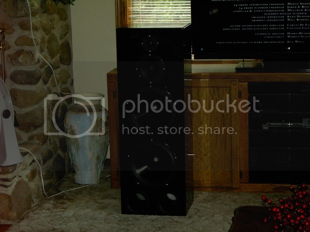

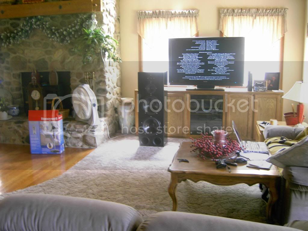

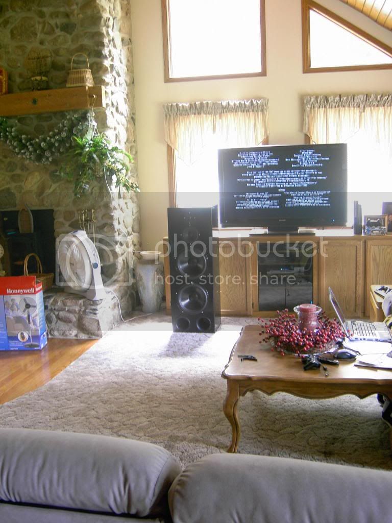

Here's 3 more pics of the cabinet with the speakers in. My dad built that tv stand, and the TV is a 52" Sharp LCD, I think it's LC52D92U. Anyways, the cabinet does have some detail flaws to it, probably because I'm not a professional painter, but I must tell you it does look good, and they sound even better. I highly recommend building a set of these if you are curious about it. I'm very impressed on the detail of the TB, and the bass is pronounced. The tweeter is a bit harsh, but turning down the treble will fix that.
Very nice work man
Thanks pal. It seems like I build everything slow, so it took me about a week and a half. I think it's worth it. I'm gonna start building on it's twin soon, but I promised my dad I'd build him the Noah 8's as displayed on PartsExpress.com and one of the small satellite speaker sets on there as well.
and props for a real nice house it looks like to.
Yeah, I don't like bragging about anything, but I will admit my parents did a good job rebuilding the house. My family is by no means rich, and they don't take anything for granted. They work hard as hell, so I think they deserve a lot of credit for the house.
