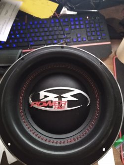

Well I decided to build the hx2 again. I'm just going to keep the motor and do a 12" 6 spoke frame, 1800rms 4" dual 2 ohm coil, 9.25" 3 layer nomex progressive spider and a big roll cone. Should be a nice sub, the HX motor is 300 oz so there is plenty of horse powers there. Will post pics, waiting on parts from Lord of Bass. Pics of the 10 I built while we wait lol.

This is the frame I went with, taller than the HX frame but very similar. I wanted to go with a TI frame but this coil simply does not have the winding length for the amount of excursion the 10" spider will produce. I'm looking to have a solid 20 Xmax with this setup and should be happy for a little while as that's a nice upgrade from a stock HX.
I don't believe that motor has all that much depth either. Rockford used a frame with a rather low landing height on those and 8" spider for a reason.
They're a great 1000W platform but I personally wouldn't try to step too far off the reservation on trying to out-think or out-do the OEM parts. There's been a fair few of those circulating up in my region and they all perform admirably for what they are when they're rebuilt with OEM coils and soft 8" suspension.
I had the opportunity to talk with a guy who dealt with PSI on several old school fosgate builds and I am following the lesser of the 2 popular builds. The other uses a custom longer PSI coil with the Ti frame and a quad stack of very stiff 10" progressive spiders.
I wondered what had become of this sub. Did it not meet expectations? IIRC, when you were about to sell it, you heard a noise and decided to take it off the market. Did that play a role in deciding to rebuild?
Yeah I used to much glue on the center cap and it infiltrated inside the coil and was rubbing. The build went great just made a rookie mistake and used medium instead of thick ca glue. I have repaired quite a few subs for friends since then. I know I could just buy a sub but I love these old things lol.
