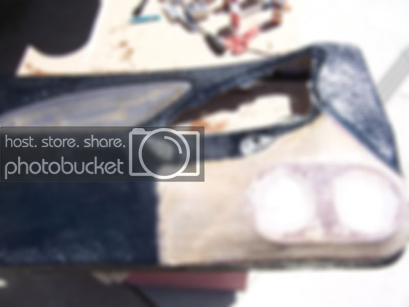

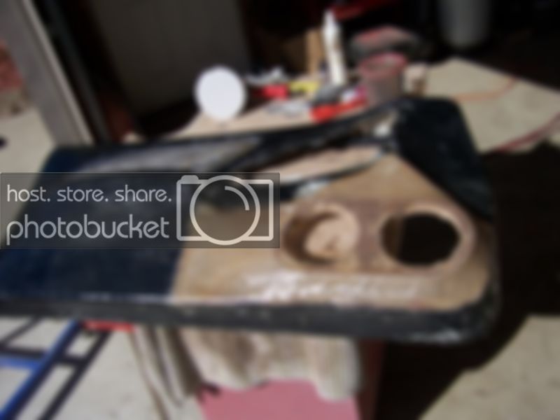

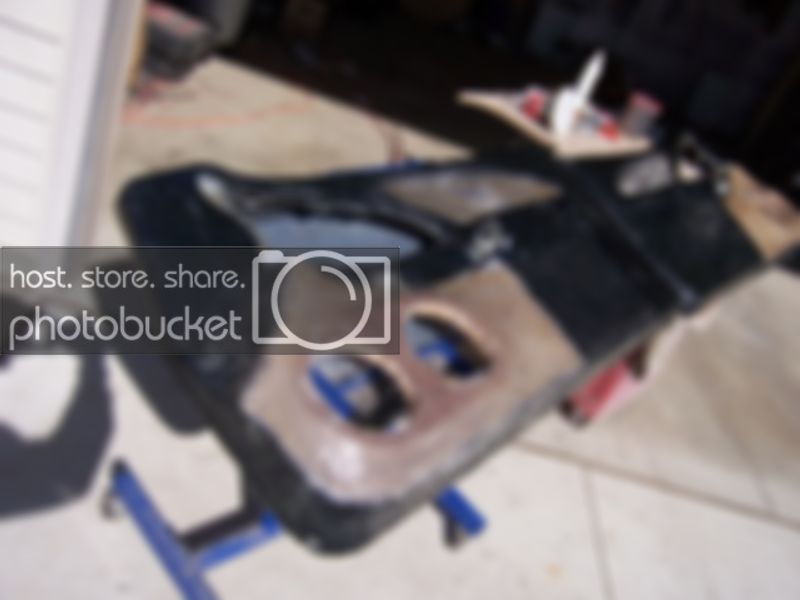

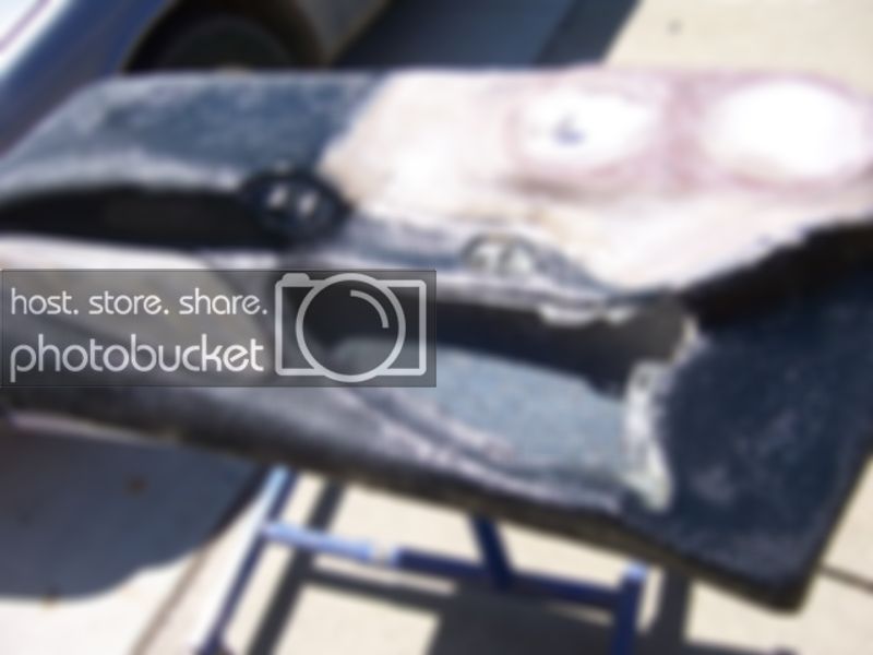

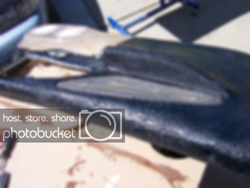

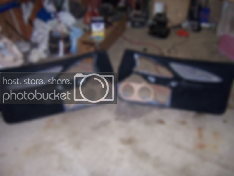

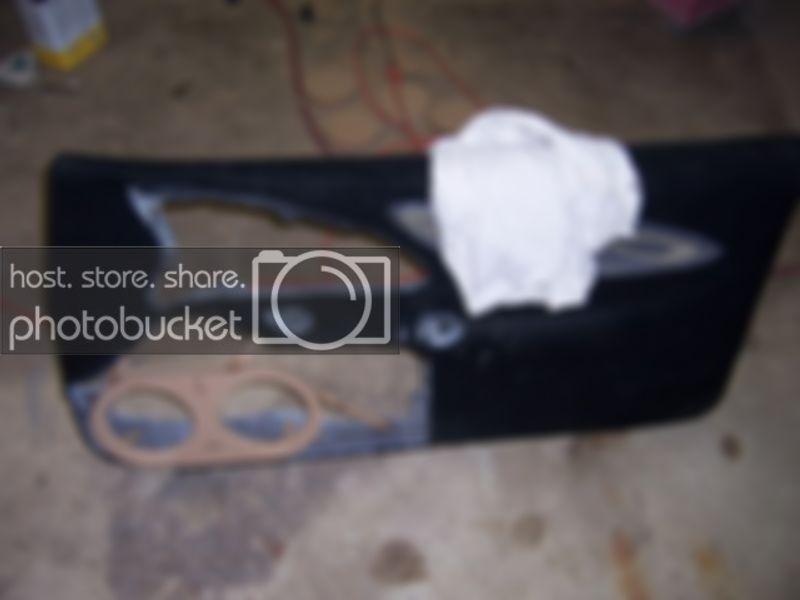

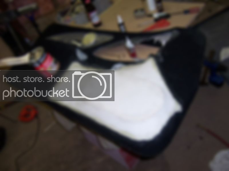

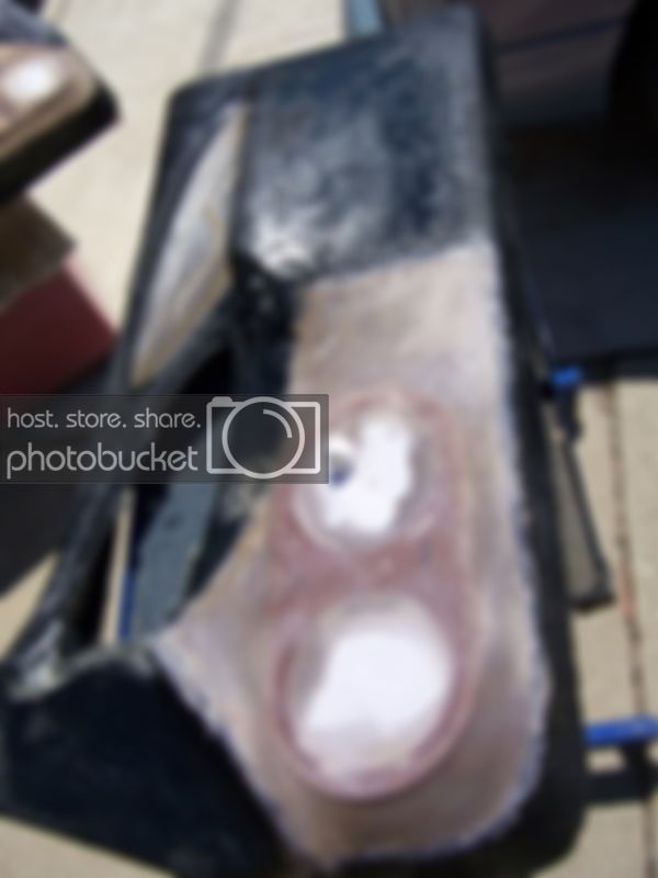

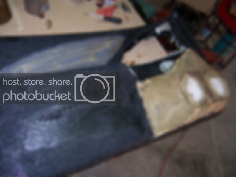

**** cold weather is putting a damper on things. I was able to get both sides all resined up but now Im going to have to wait a day or two for them to dry.
I wish I would have stretched the fabric on the drivers side one a little tighter, or glued it a little more since I ended up with a couple little waves in it. Just a little more sanding and filler work, fortunately I made up for it with the passenger side and that is looking pretty good.

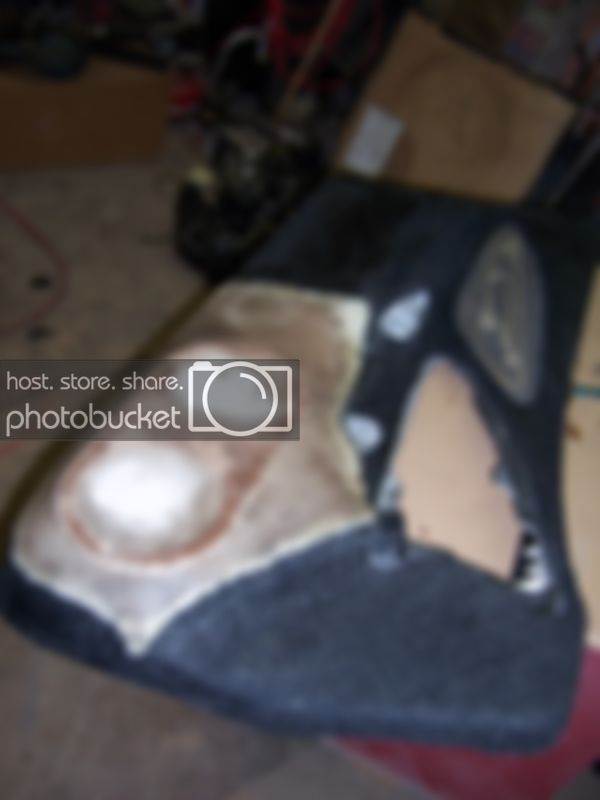

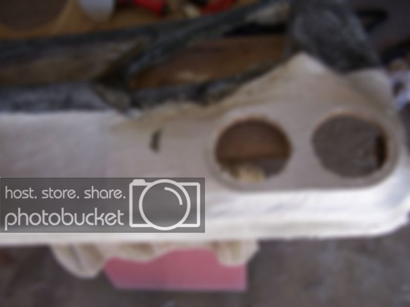

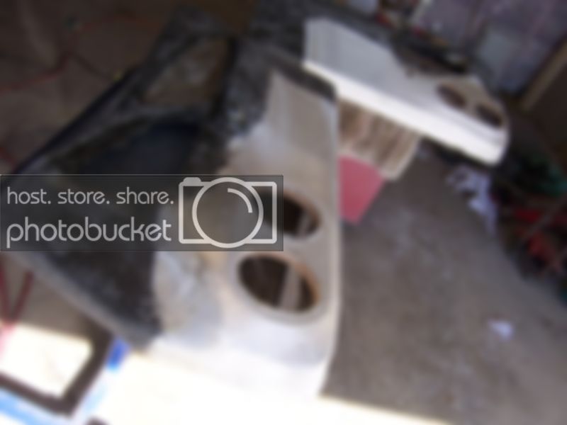

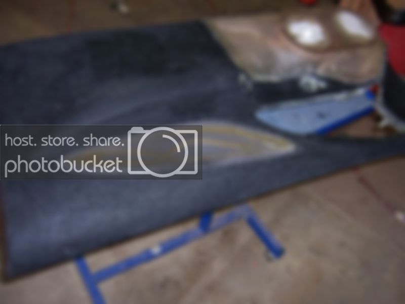

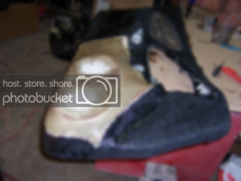

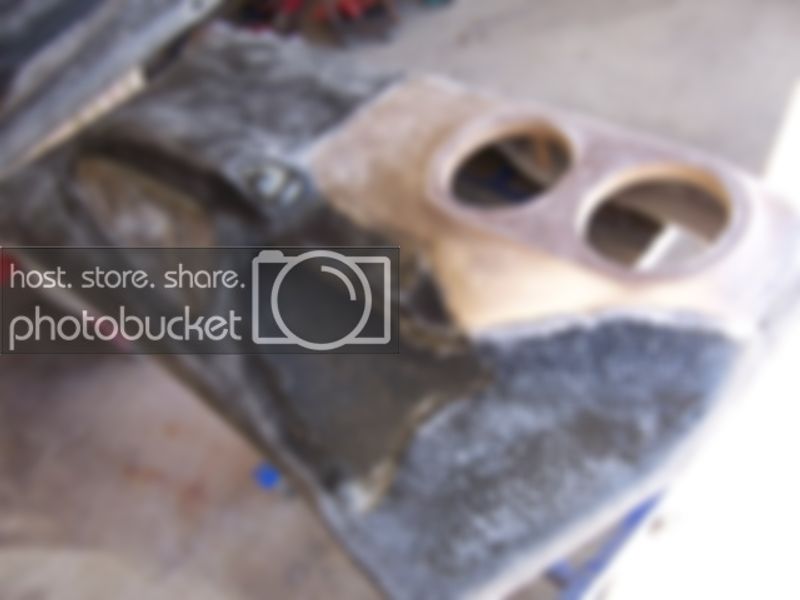

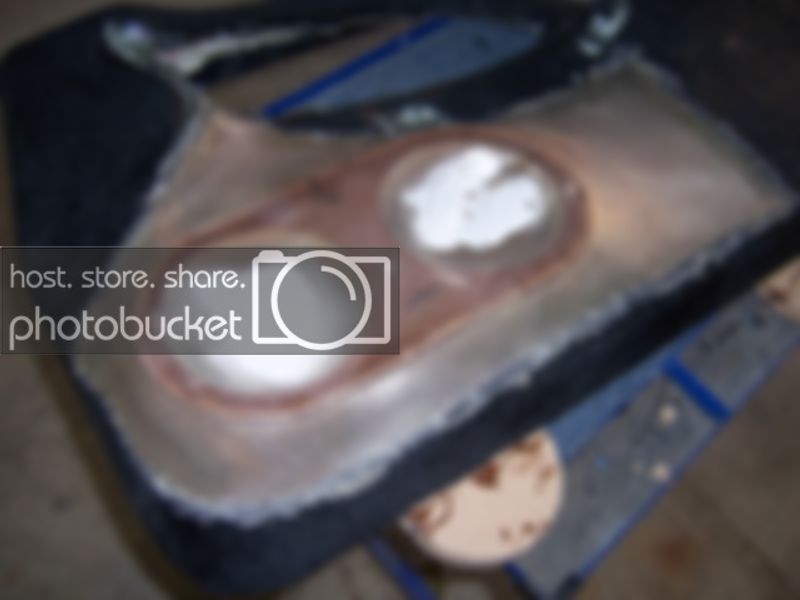

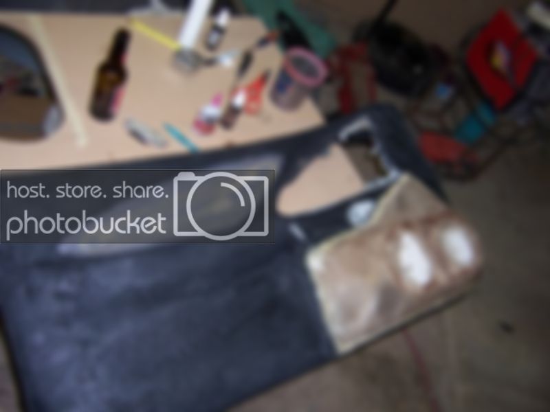

^ Started sanding //content.invisioncic.com/y282845/emoticons/smile.gif.1ebc41e1811405b213edfc4622c41e27.gif
Its a breeze with my 6" DA and the roll of 80 grit pads I bought!

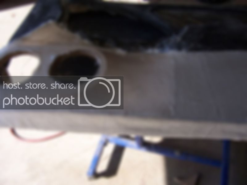

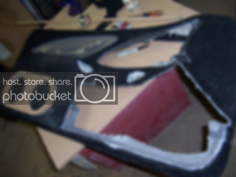

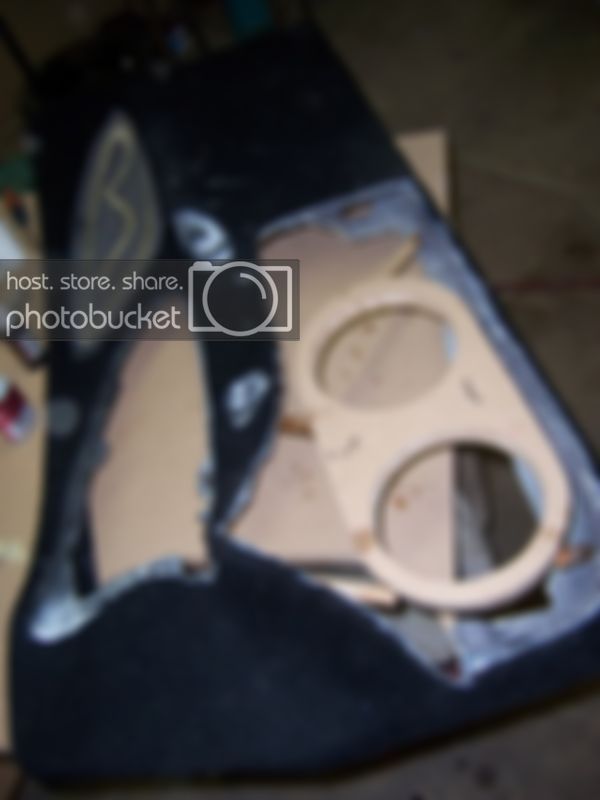

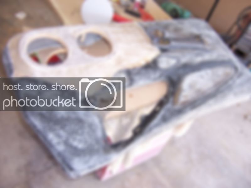

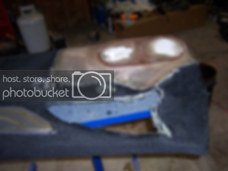

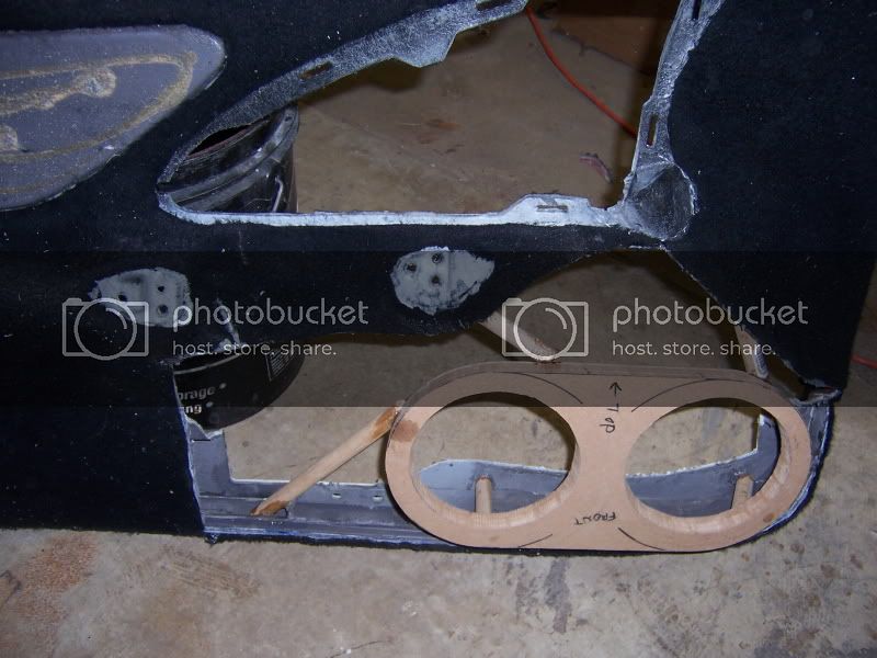

More progress, need to go pick up some more fiberglass and hardener. Im probably going to lay down some fiberglass reinforced filler and then another layer of glass, more filler, more sanding, filler, sand and cover.
