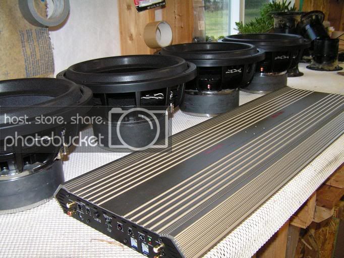

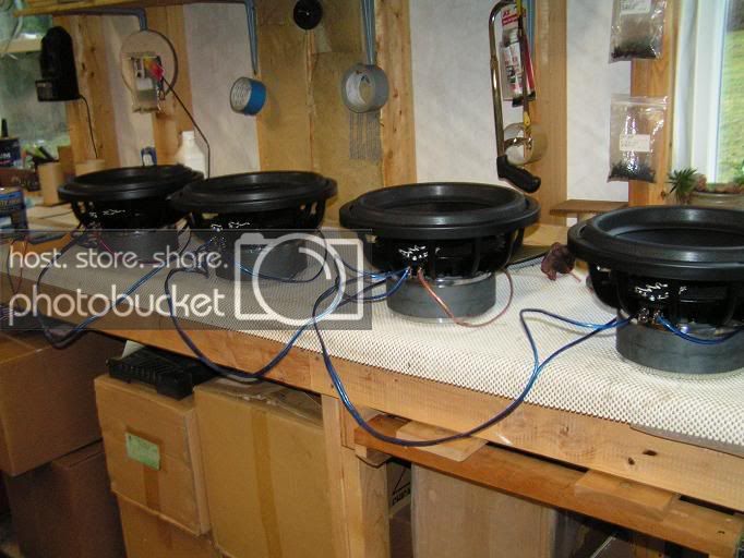

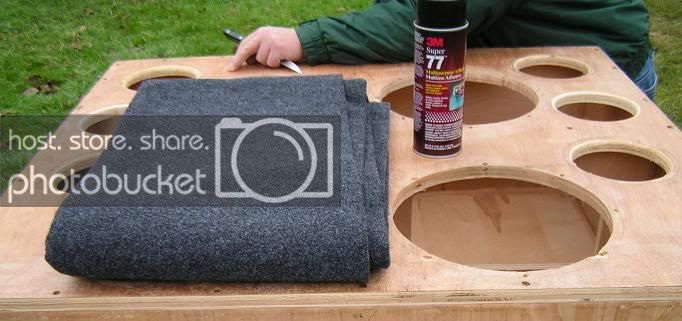

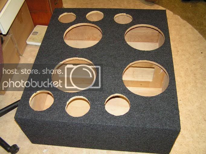

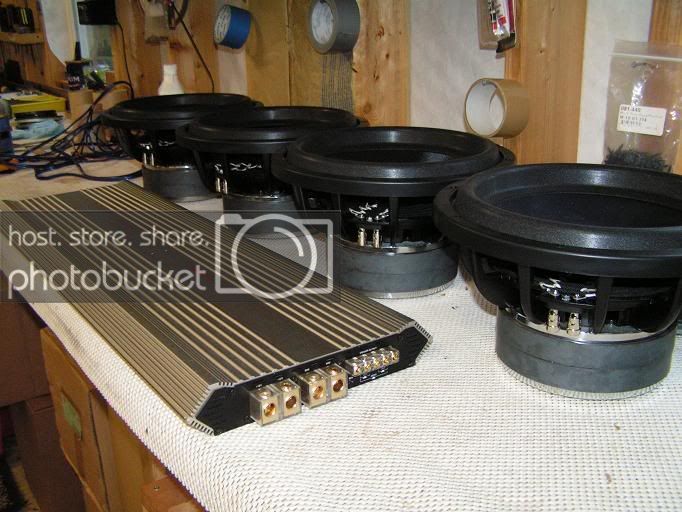

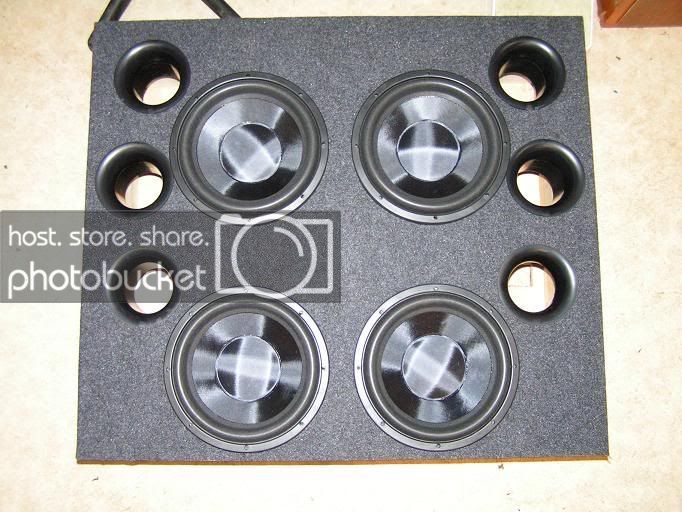

We are doing a new build featuring 4 2009 WMD 12's with 1,500 wrms on tap per sub.

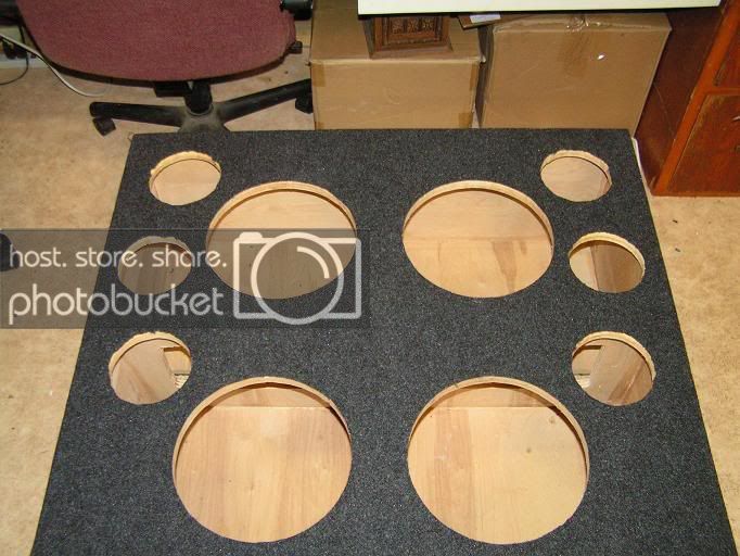

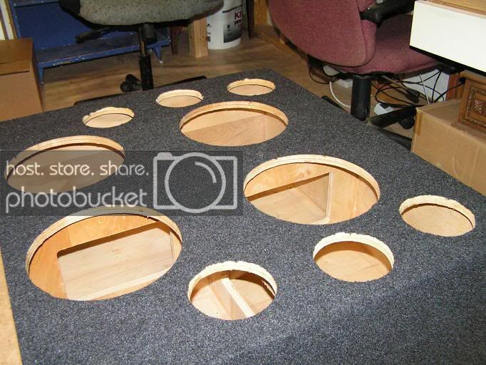

8 cft birch plywood enclosure with 6 - 4 inch aeroports tuned to 40hz
The 4 12's come to a 1.5 ohm mono load
Extensive internal bracing

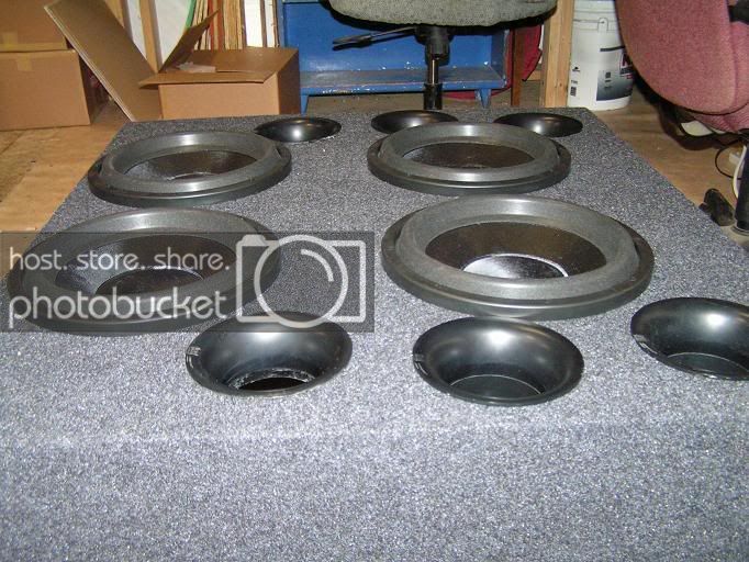

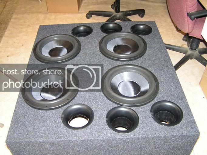

Test fitting subs and port flares
2 more port assemblies are on the way, then we'll have all 6. When they get here it's test time. //content.invisioncic.com/y282845/emoticons/smile.gif.1ebc41e1811405b213edfc4622c41e27.gif
