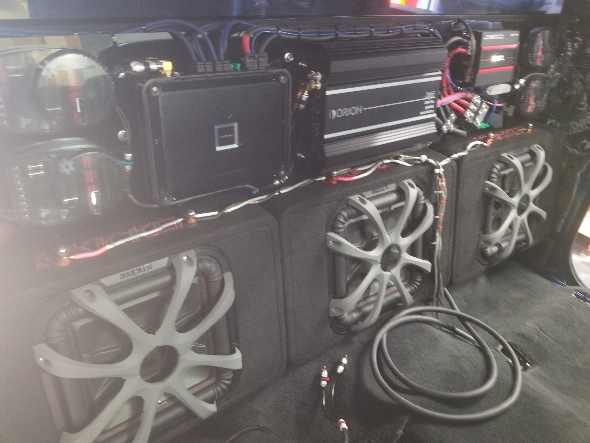

Yeah I have (3) 12" solbaric (square) kicker slim subs in a reg cab pickup.
They are 600w RMS, and I have 900w going to each. It hits good for what it is, but I only did this, because I absolutely wasn't willing to give up leg room in my daily driver. If I max the volume it will shake the mirrors, drop the rear view, rattle the panels; but two 15s in a ported box with lets say 3-4K watts, would make this feel like it's only half of that.

Talk about 10 pounds of shit in a 5 pound bag. :oops: That wiring is clean.(y)
