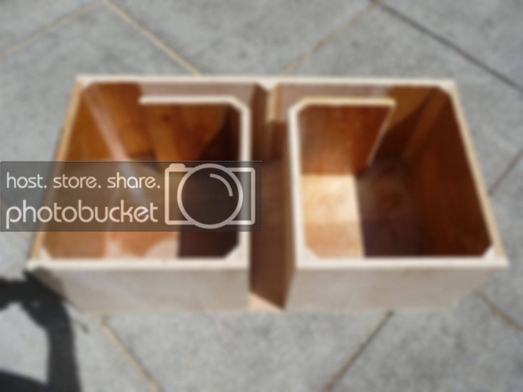

i havnt been on here for a long time but i thought you guys might like to see this little build. pretty basic but the kid is very happy with it.

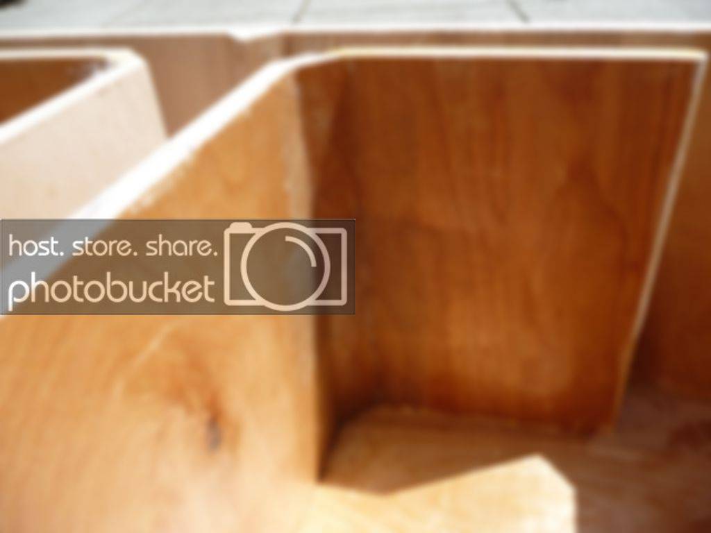

box: 1.6 cubes each side. tuned to 35hz. little over 13sq in of port area per cu ft.

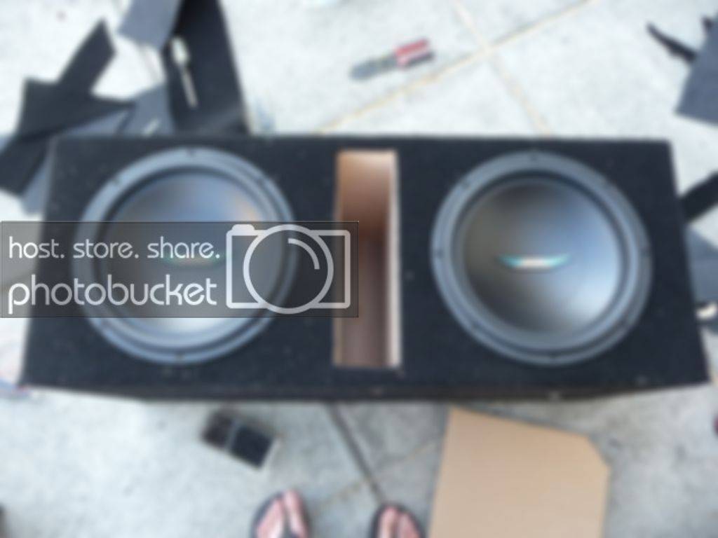

subs: image dynamics IDv3 12"s, D4 coils for a 1ohm load.

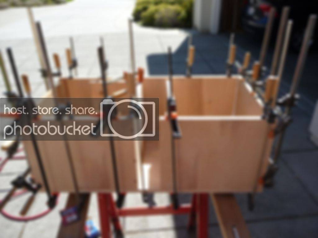

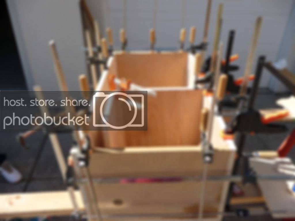

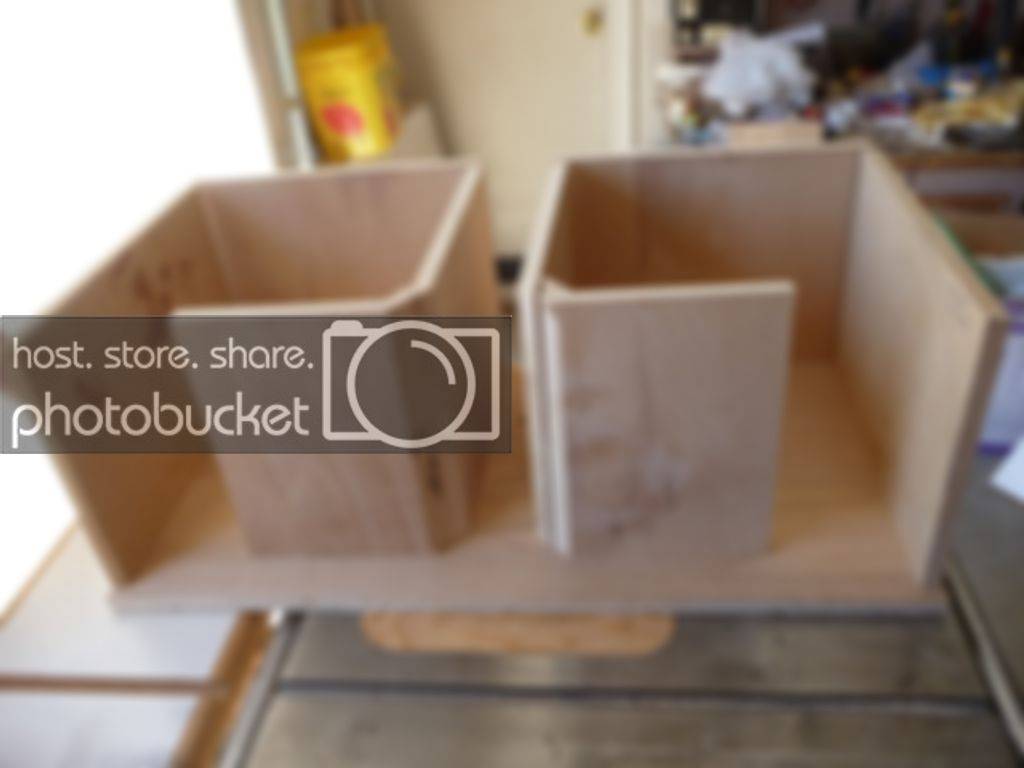

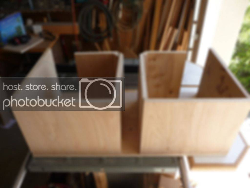

mocking it up

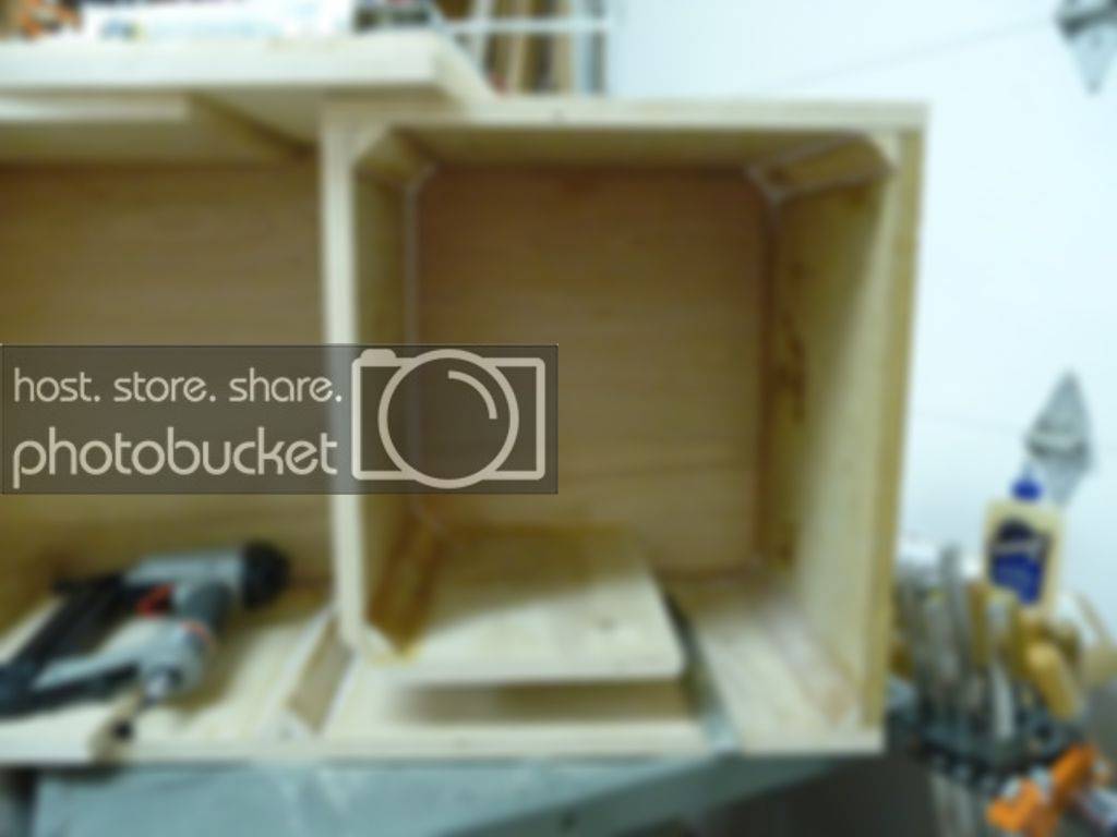

this is all we got done on day one.

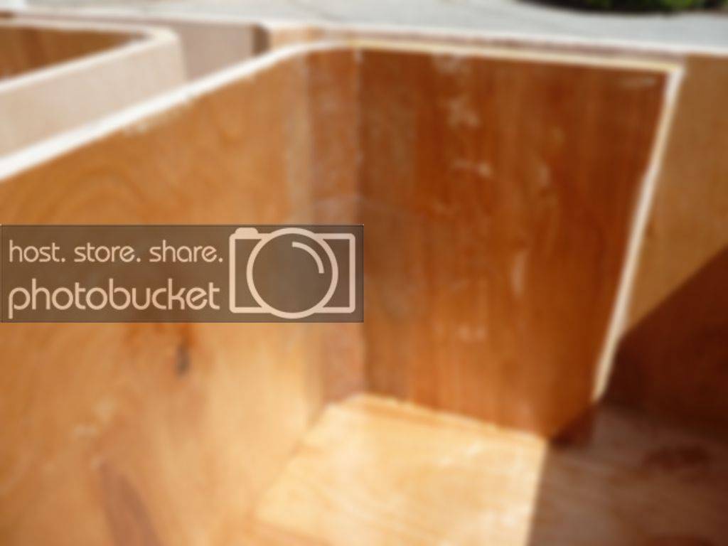

but i couldnt stop working after he left or the next day when he was working... so i gave him a little surprise.

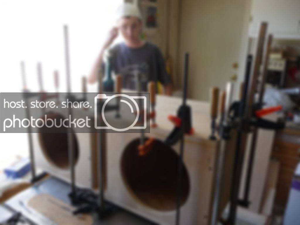

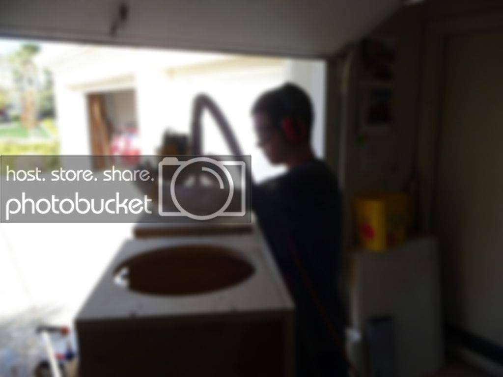

here is the owner
goofin off

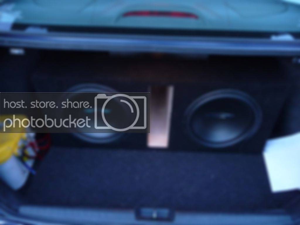

Looks good. //content.invisioncic.com/y282845/emoticons/thumbsup.gif.3287b36ca96645a13a43aff531f37f02.gif How does it sound?
sounds good. just have to stop the rear deck from making so much noise.
probably sounds like there's a piece of paper in the port //content.invisioncic.com/y282845/emoticons/smile.gif.1ebc41e1811405b213edfc4622c41e27.gif
lol, it did for a min there. scared me too because i was in the car playing with the system when i hear "turn it off!! turn it off!!" i thought something was smoking.
