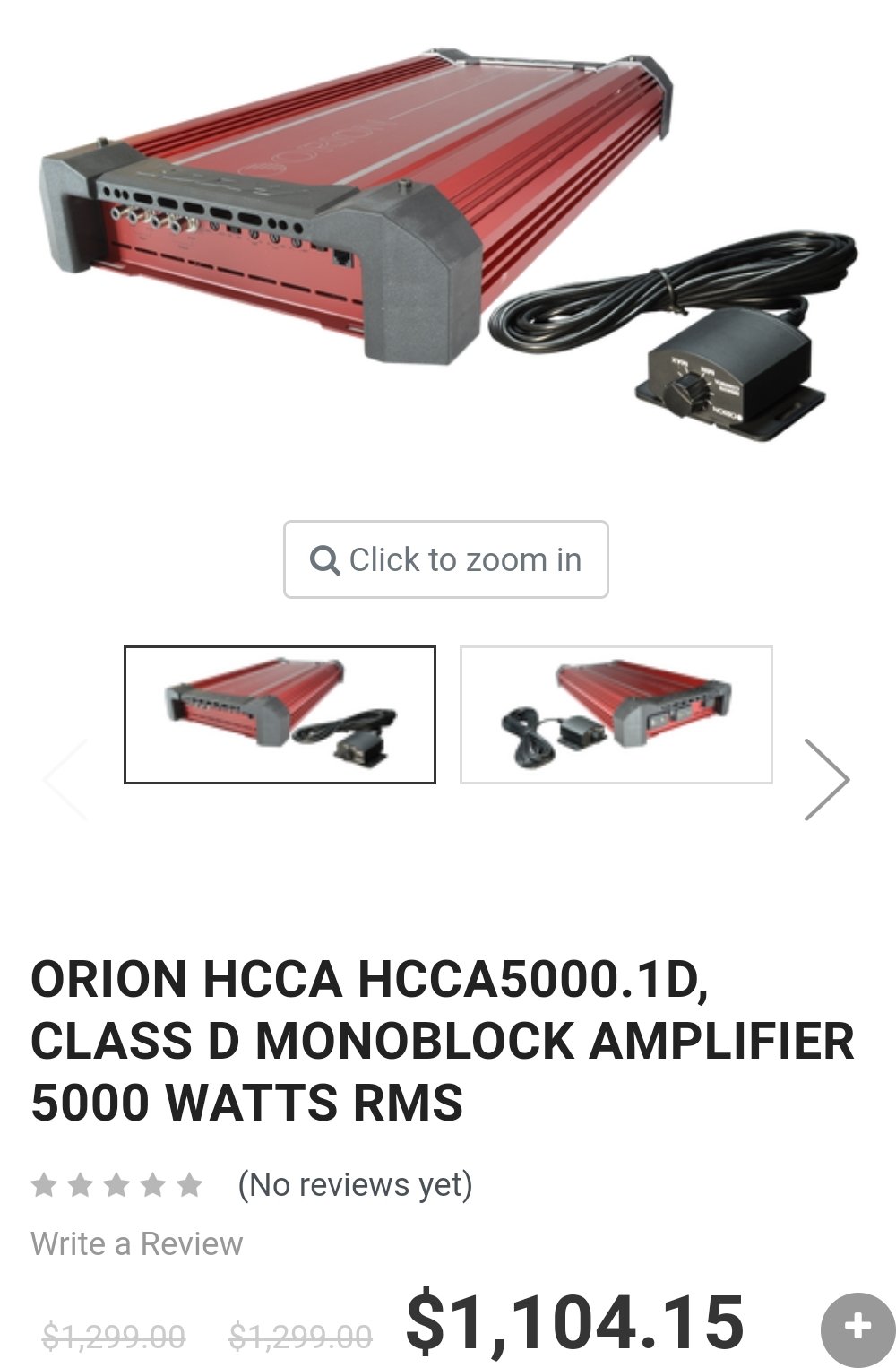

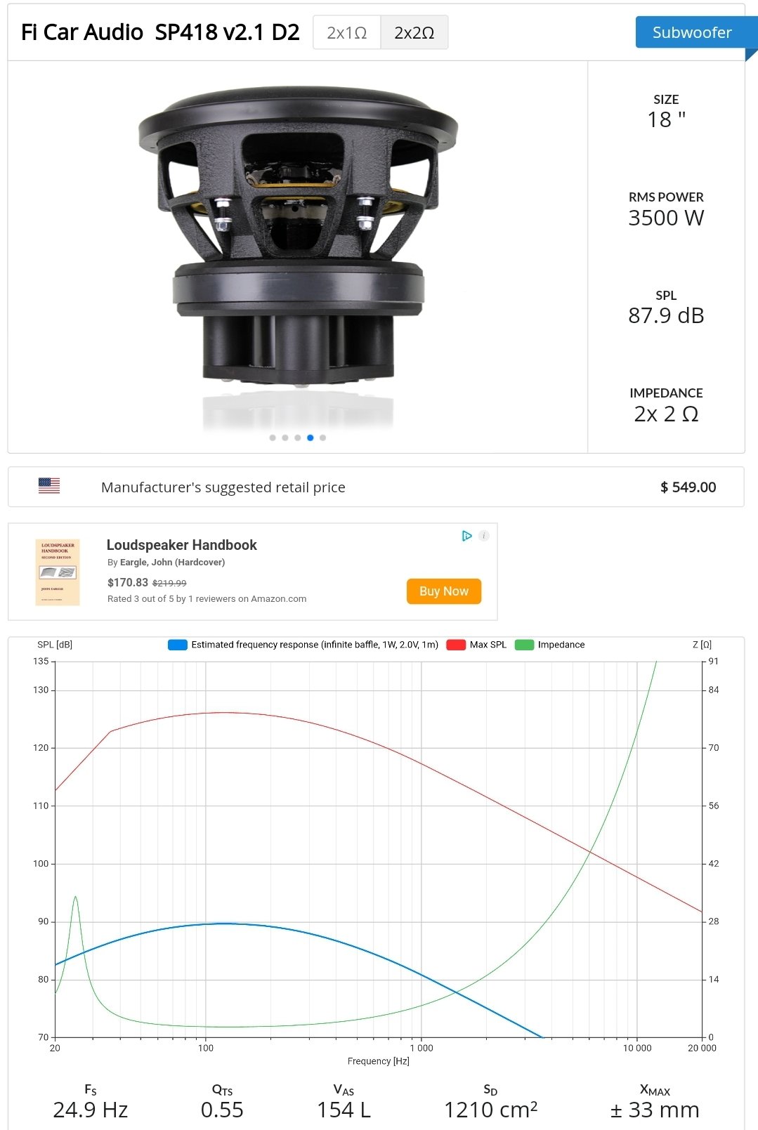

I think these would work. The HCCA will give you between 5,000-7,000 watts depending on your voltage.

im strongly considering both, thanks for your help
You could save some money ($600 cheaper) if you went with a Taramps MD8K one ohm version. It sounds like your electrical wouldn't have a lot of variation. Taramps like a consistent voltage around 13-14v. Plus, the Taramps would draw significantly less current than that Orion since it is a full bridge amp. The MD8K is 8,000 @12.6v. At two ohms, the MD8K one ohm version, is still over 5,000 watts.
