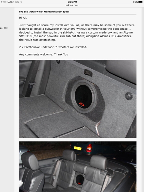

I have an 08 bmw m3 e93
I have been researching for several weeks on what to do for my car also
I purchased the following after a lot of checking
Jl audio 600 watt sub amp
Jl audio 10w3. 10 inch 2 ohm sub
Audio control lc2i line converter
Plan to install in the next week or so by tapping the lc2i into the sub wires coming out of the factory amp. Box is going to be a thru ski port design that I build myself due to not being able to find a manufactured box that fits that need.
I a, going to build it sealed due to not actually knowing how to calculate a small round port that would work correctly
This is what I plan for it to look like when I am finished , found this on a bimmer site.
