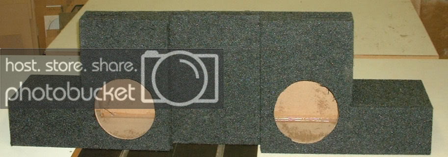

I finally figured the SOB PITA slot port out. After being out and about searching for what I would hope would solve all my ills for this design, I found NADA man, I was totally fr!ggin disgusted and quite annoyed with whole d@mn affair.
I resided myself to the fact that sometimes there's nothing that can be done to overcome a design issue when fighting against every inch of space to make it work, I was going to toss in the towel and give up, concede to defeat that I just couldn't do it.
OHHHHHH..... But I did, I took one more crack at this Biatch, turned it inside outside, twisted it this way and that way and then it just clicked.
Yeah, I know some " builder critic's " are going to say this and that and pick it apart, BUT, I don't give a sh!t because I really don't care what ya say. I beat my head against the wall for 15 hours just to solve this b!tch. if ya can improve on it, be my quest!!

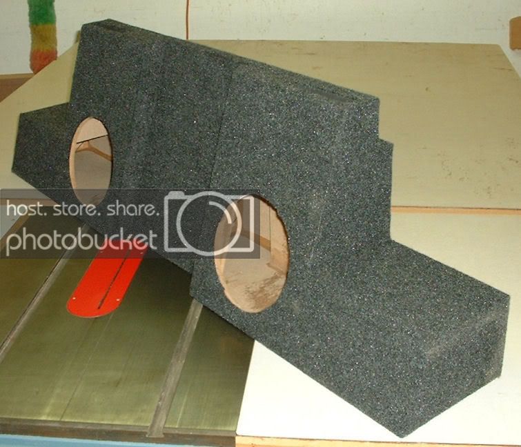

Yes, the port is 1 x 5 = 5 sq.in. of port area. So with that size port given the dimensions of the enclosure I was able to increase the net volume to .507 cu.ft. and with the rms of that sub @ 250 watts, there will be no port noise.
Here's the deal though, in order to achieve those goals of the design, the entire enclosure will be built with 3/8" MDF and with the slot port as shown/designed, it is acting as bracing as well so there is no need to be concerned about the enclosure not being structurally sound.
If I didn't think it wouldn't hold up, I wouldn't of designed it as such.
