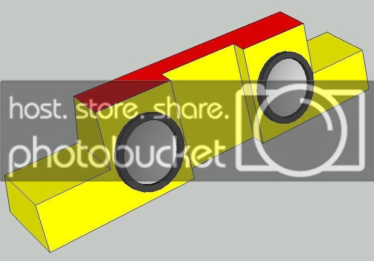

I need to know if and what is obstructing the top of the enclosure ( RED ) and at what depth the obstruction comes out over across the top??
this is the area that limits me from going above 11" but it sticks out 1.25"
this is the maximum TD at 3" above the offset of the rear cab wall
wow thats not a great pic the measurement is 2.5" at 14" from the bottom
not sure if i said this before but this is for a 2003 ford ranger

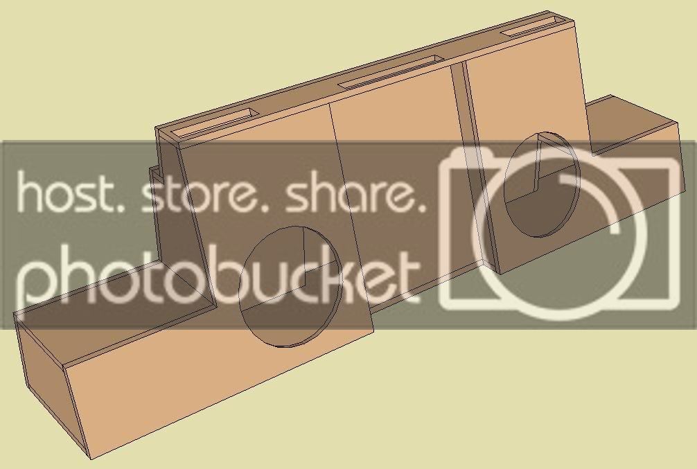

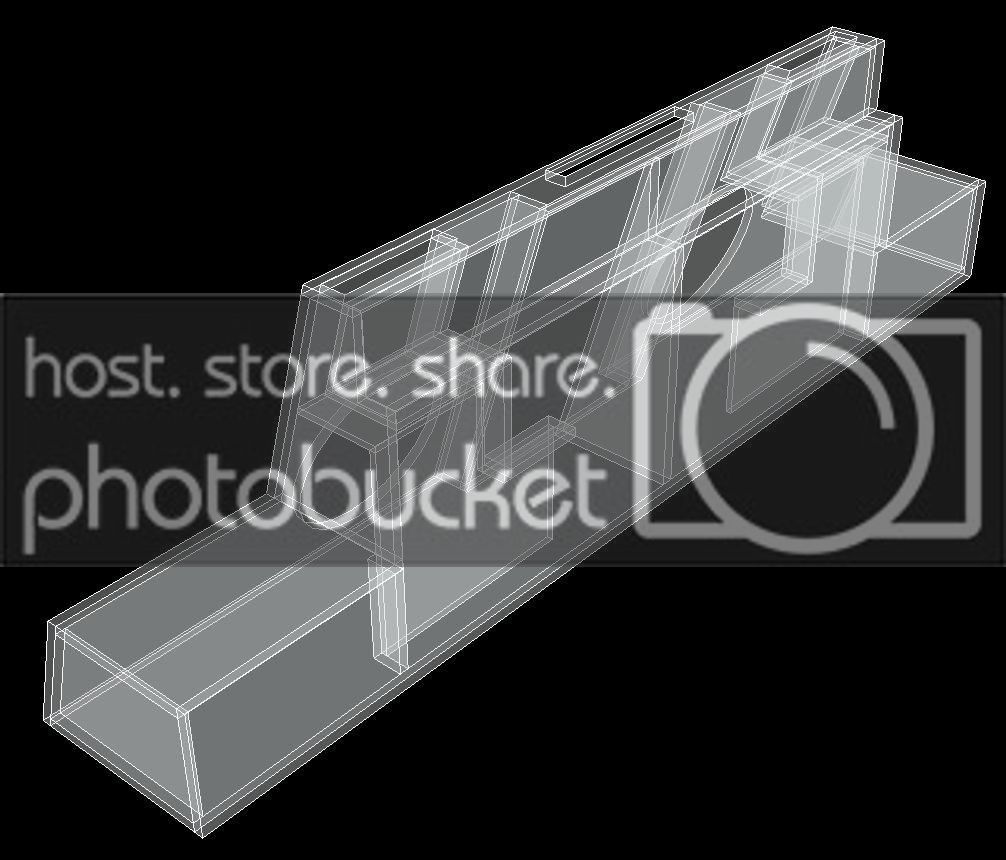

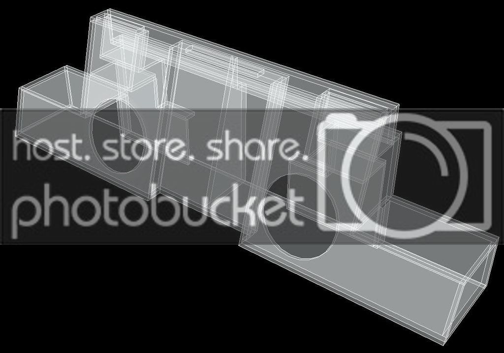

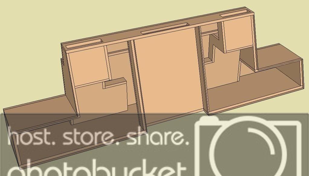

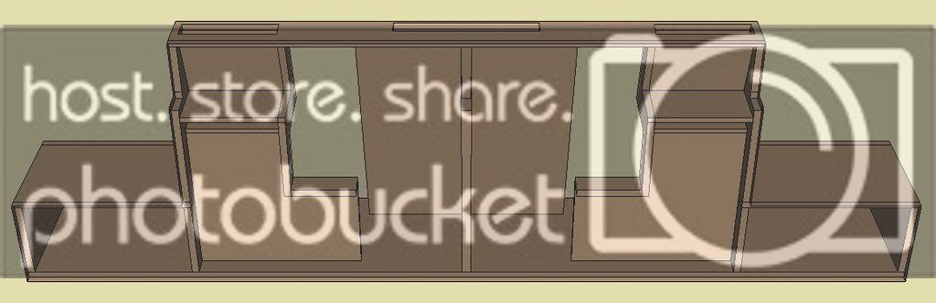

bad03ranger changed up the design alittle, but, his and my way of thinking about it sort of crossed over into we both were thinking the same thing and in the process allowed for the enclosure to gain more volume so I can do slot ports to give him alittle more port area than the 2" dia port area.
I'm working of the final revisions of the enclosure as we speak.
