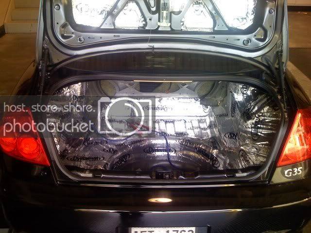

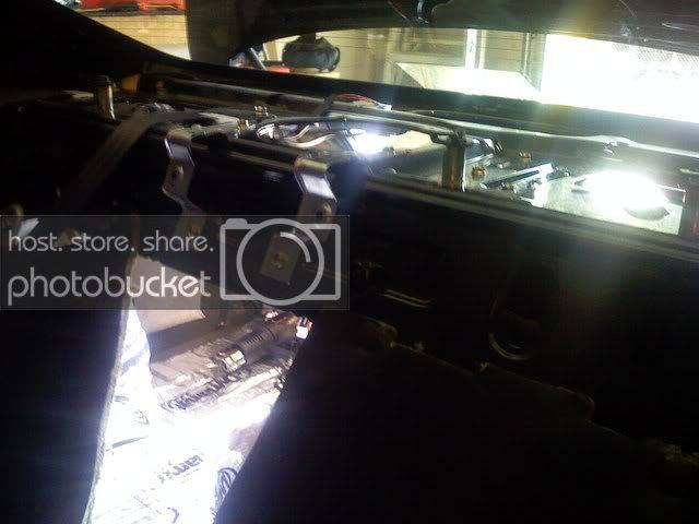

with what im starting with
took out the factory 8" bose

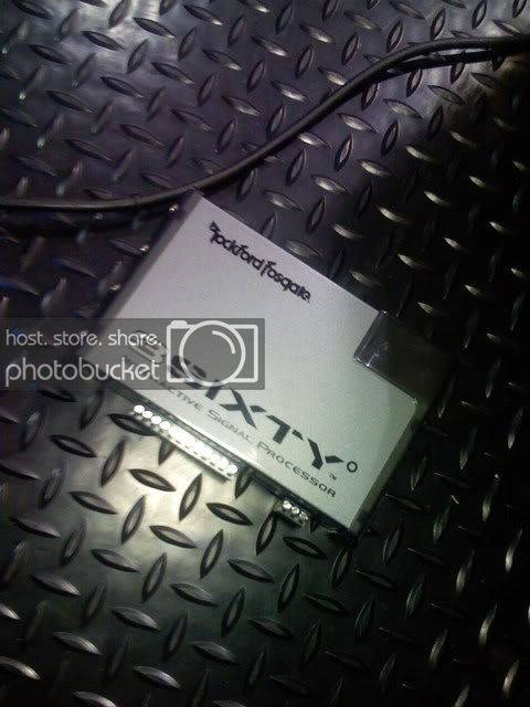

when with rockford fosgate 3sixty signal processor
3sixty take the place of the factory bose amp
more pics soon

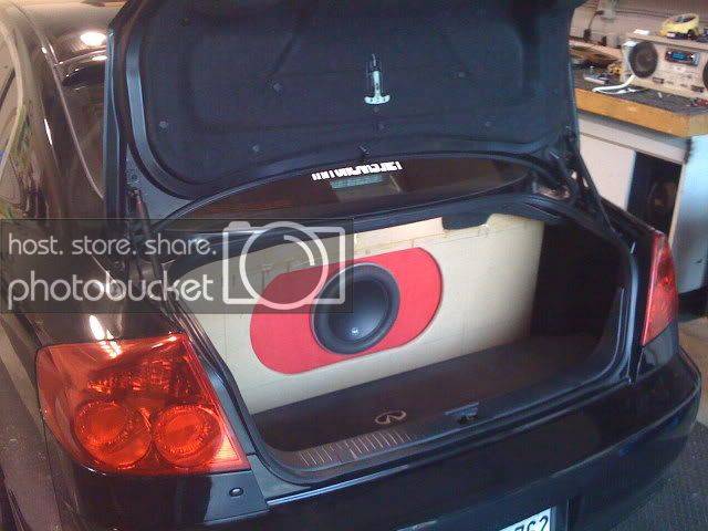

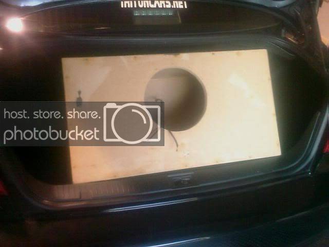

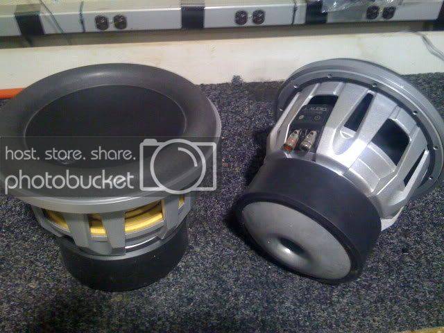

Box came with one of the subs, That box has got to go, probably gonna go with a 2cu ported enclosure with a low tune, waiting on his input
10w7's not sure to go with 1 or 2

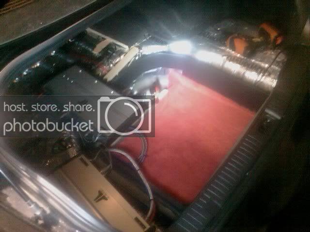

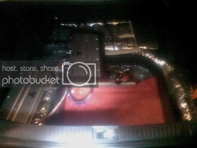

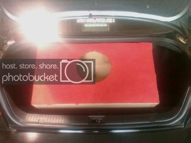

got the amp rack done and covered

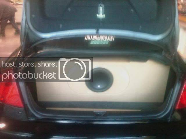

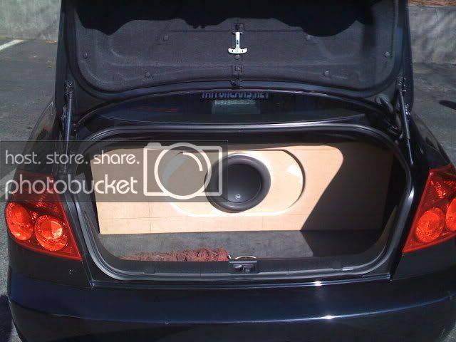

Decided to go with only 1 10W7 ported would be enough bass 4 him

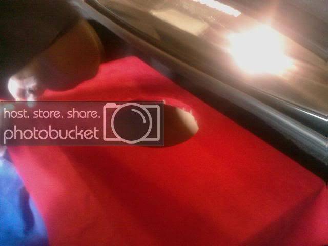

Built the box 2cu tuned @32hz sub to the rear and the port is up and threw the factory 8" cut out.
test fitted the sub in the box since w7's have a some what smaller 10" cut out

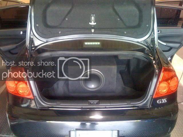

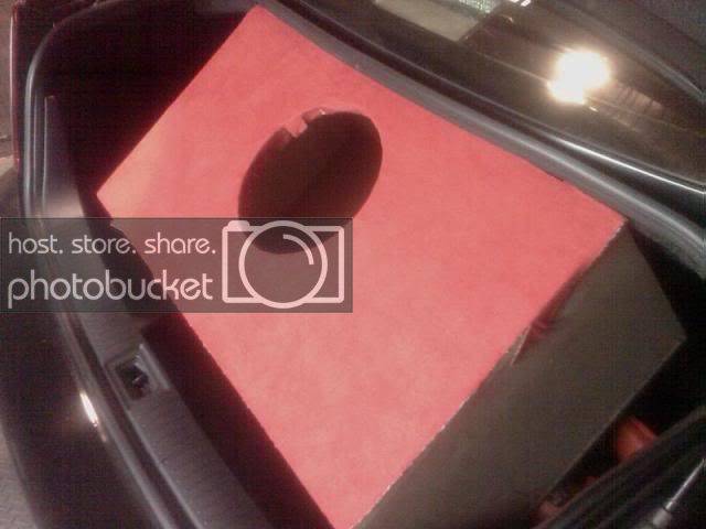

He wanted to go with a wall since it would look classy, vs a 30K car with just a box in the tunk isnt all the hot in my opinion so we agree'ed on that
Covered in the red suede
wheels look great on that car. sweet build. Im looking at using the 3Sixty, is the only way to tune and adjust is with a palm?
nope, im using his htc windows mobile phone 6.1 to do the tuning. You can also use a bluetooth labtop also
