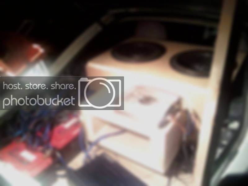

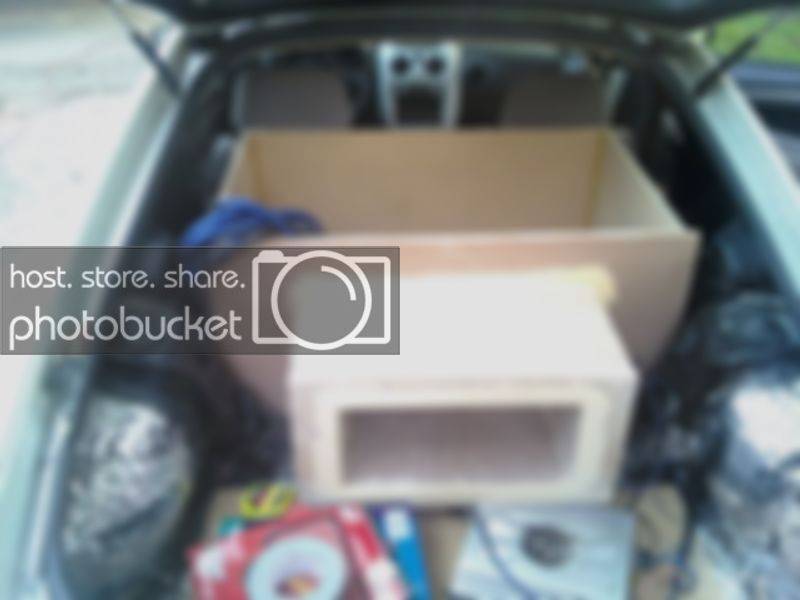

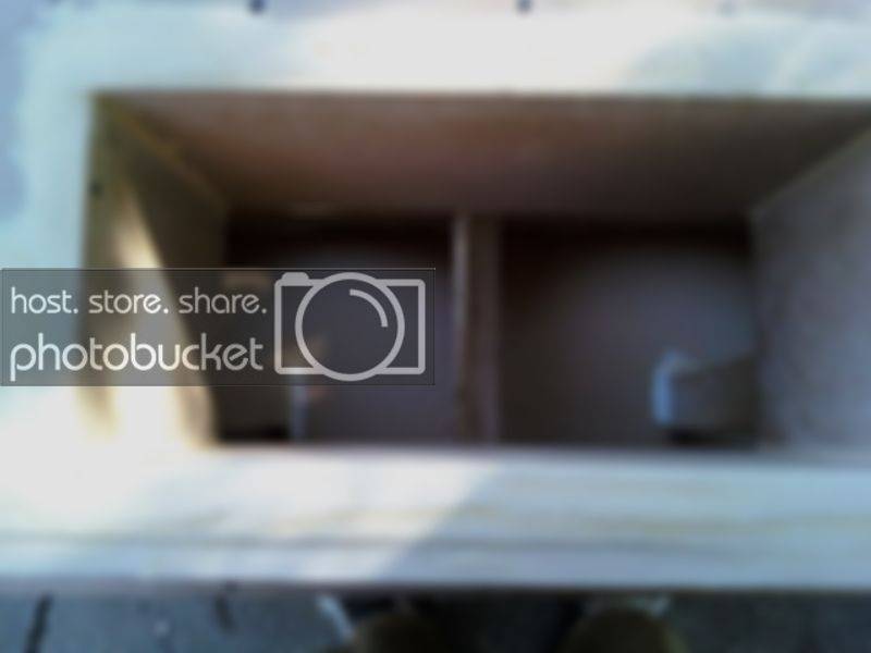

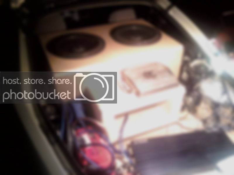

well the build is for two RD Audio HW 15s, and will be powered by my Atomic 5000.1 amplifier. the box is around 7.7 cu ft after displacements and is tuned to around 39-40 hz. The subs will be here wednesday so thats when they will go into the box. The double baffle is done, glued and screwed together to get it tight...just not mounted yet.
PICS

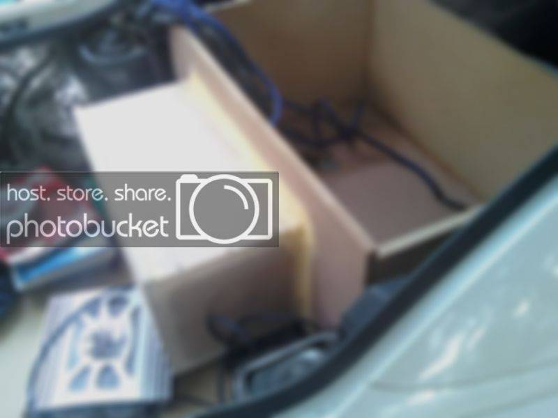

Back of box
Side View

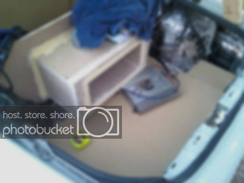

Trunk Floor Board for Mounting of batts and amps.
More to come wednesday!!!
