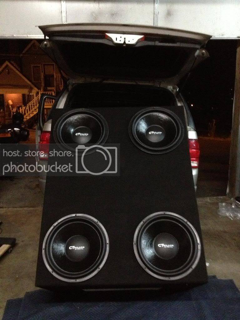

We have 10 of the V1 CT Sounds Strato 18's. I'm going to run 2 of those in the 13 cube box on my two eD 9.1's strapped (2400w @ 12.5v). I'm really going to test these hard. I had made a box for 4 of the CT Sounds but they are so stiff I didn't have enough power for them. I mean these things are STIFF. 500w rating is just not right IMO. I couldn't even get the 4 of them to break in really off my power. Here's that box (now sold/gone):
If the 2 can't handle my amps, I'm going to design and build a box for 3 of them to go in my vehicle. I'll let you guys know the results. Tell me what you think.
