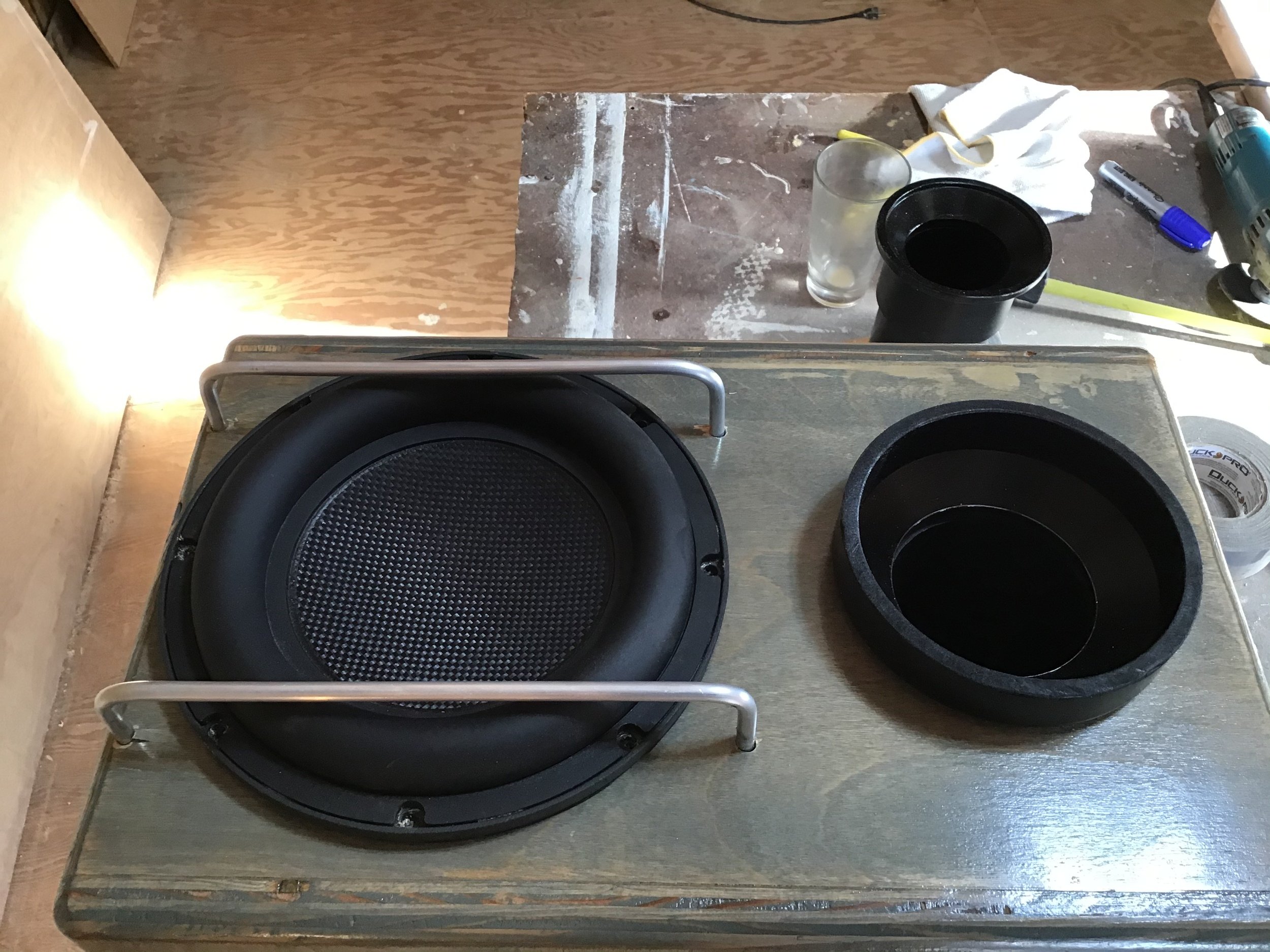

what size and type of port did you run on this?
I ran it in 1 cube tuned to 30 hz with a 4 inch round port.

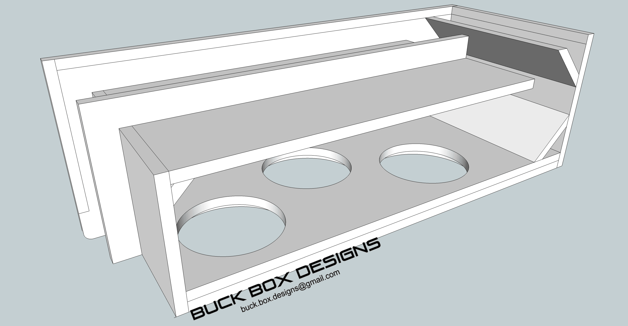

Another center console box
Sundown NSv5 10" Ported - this sub may have the biggest mounting depth for a 10. The NSv4 10 is 11.25; I think the mounting depth is close to that, if not the same. D4S told me that the sub mounting depth was about 12 inches. So, I made sure to leave plenty of depth for this sub that has a bigger mounting depth than it's cone diameter...lol
