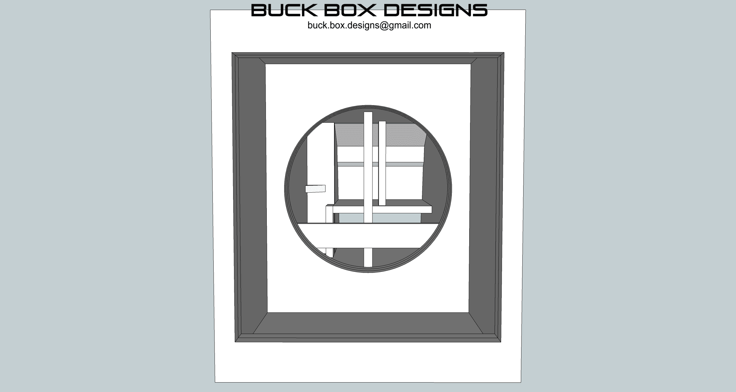

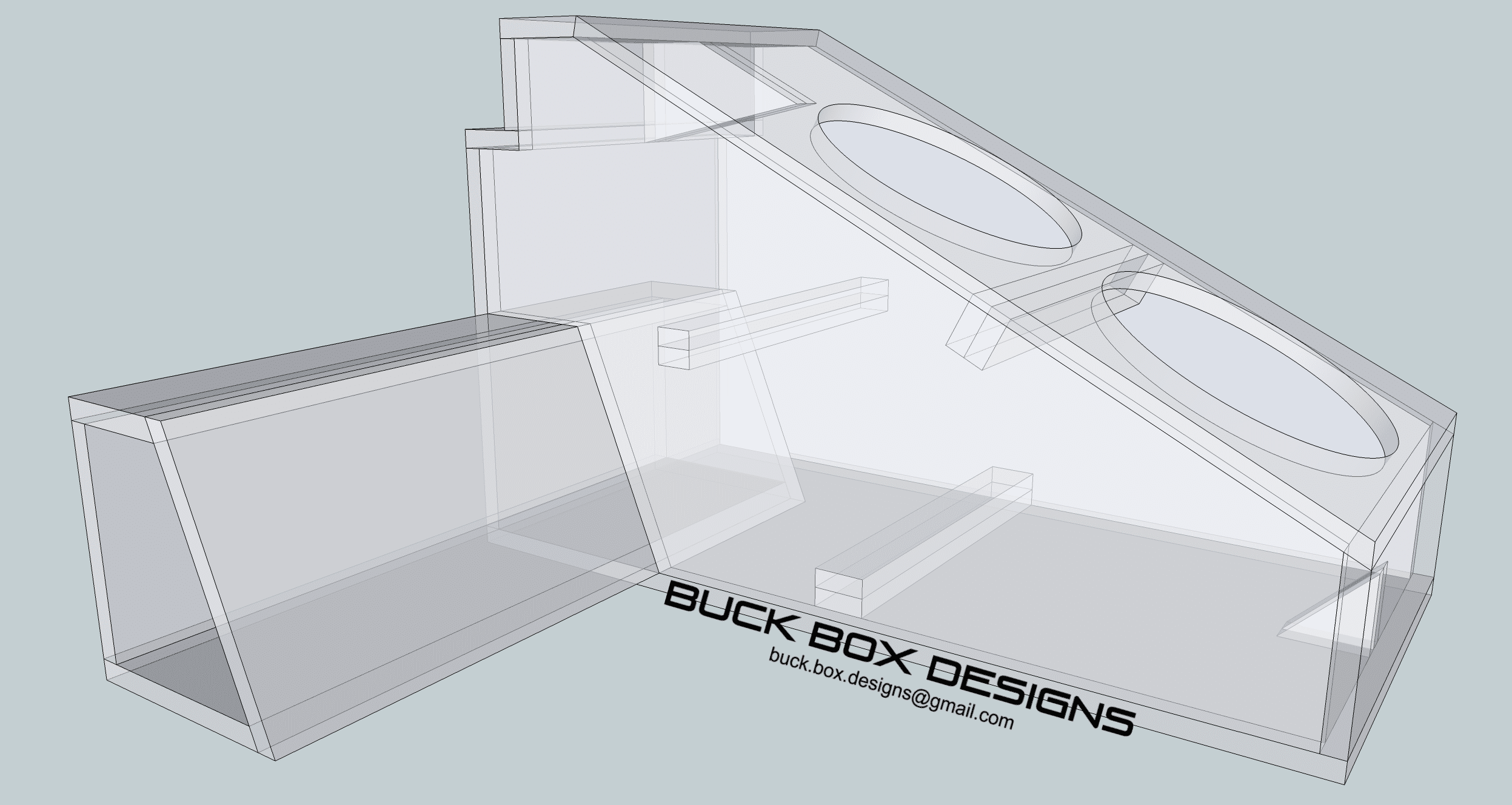

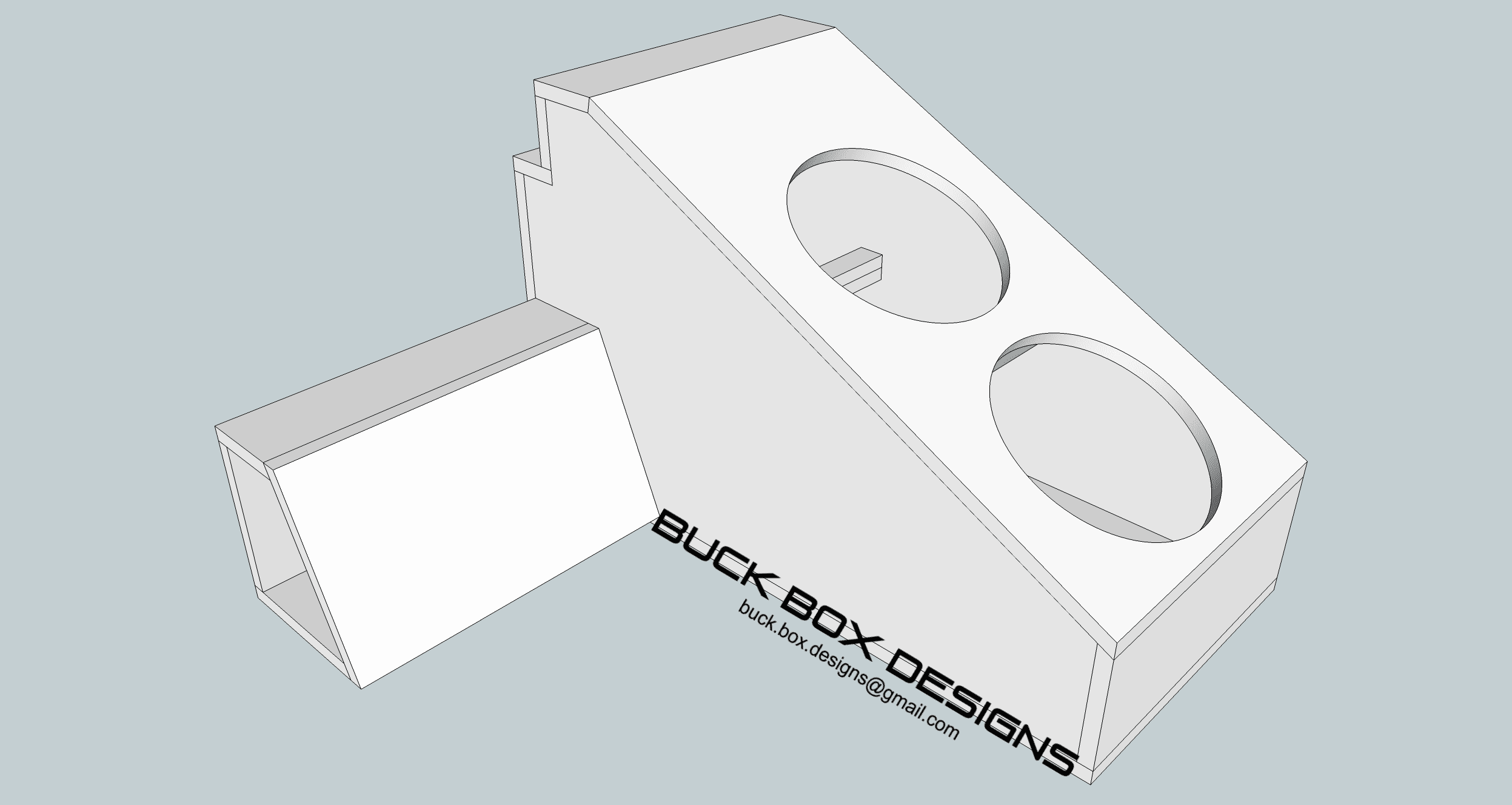

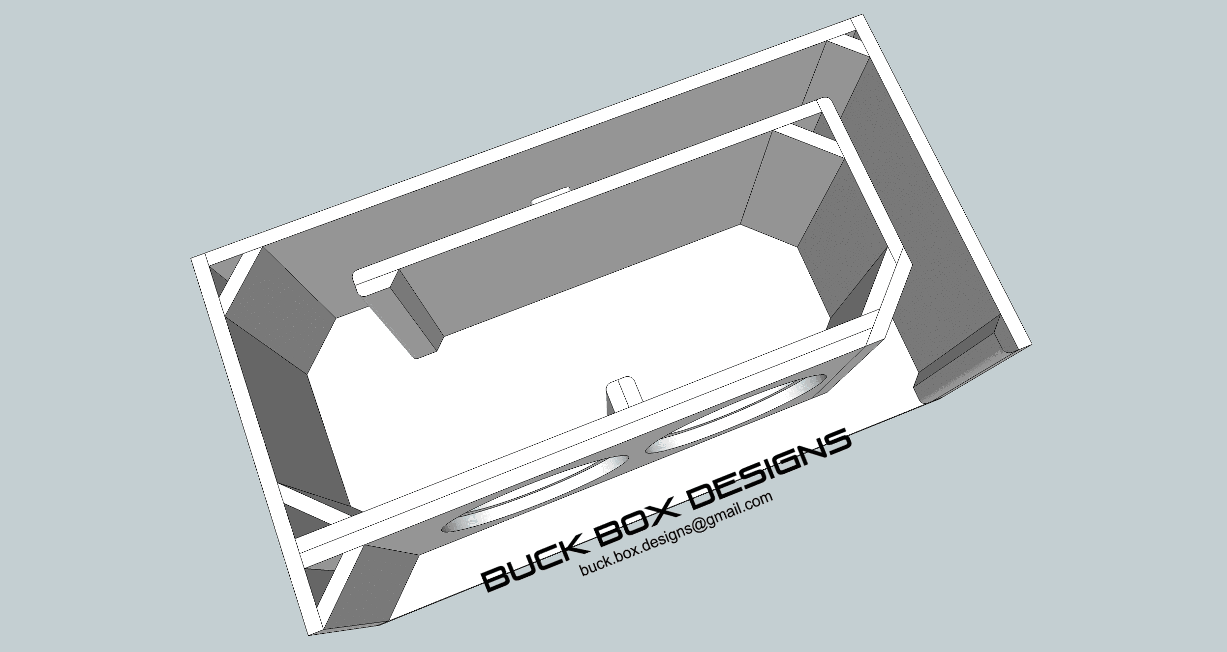

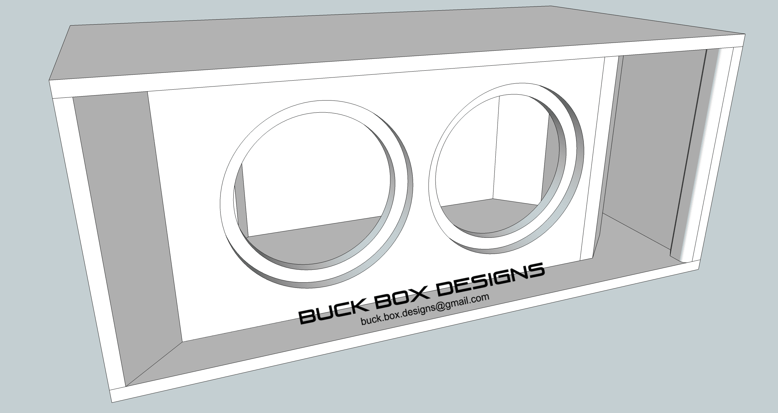

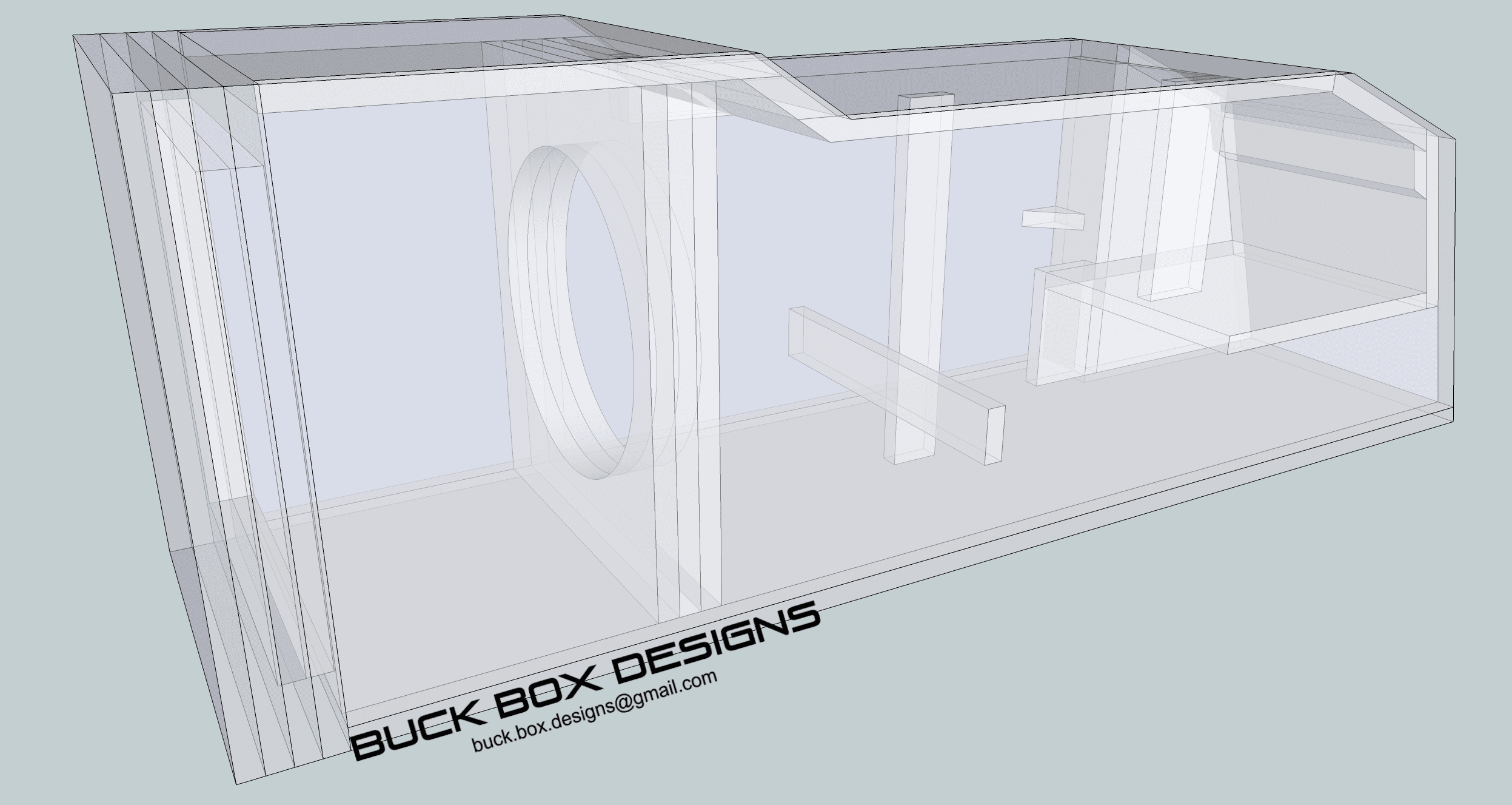

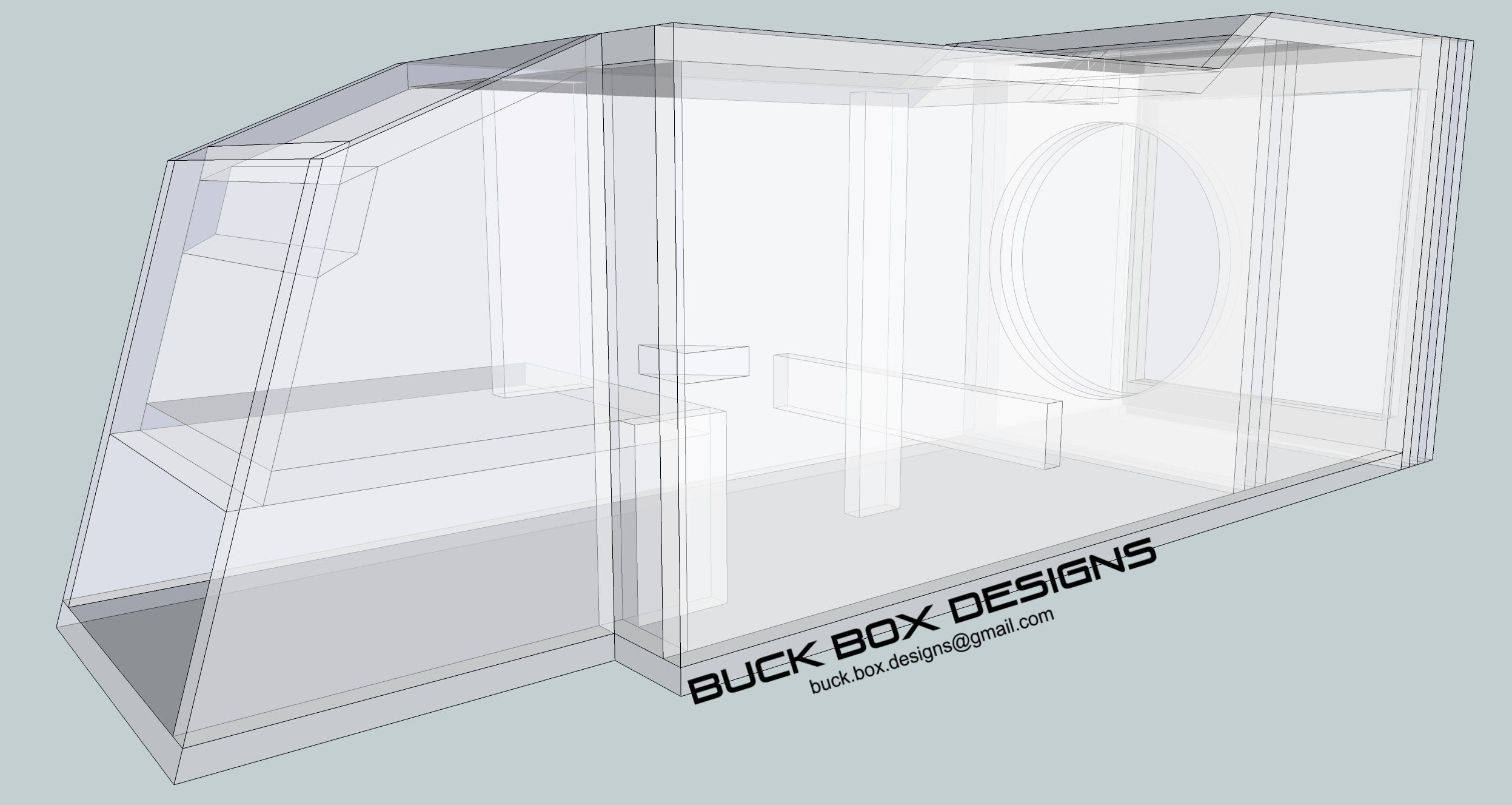

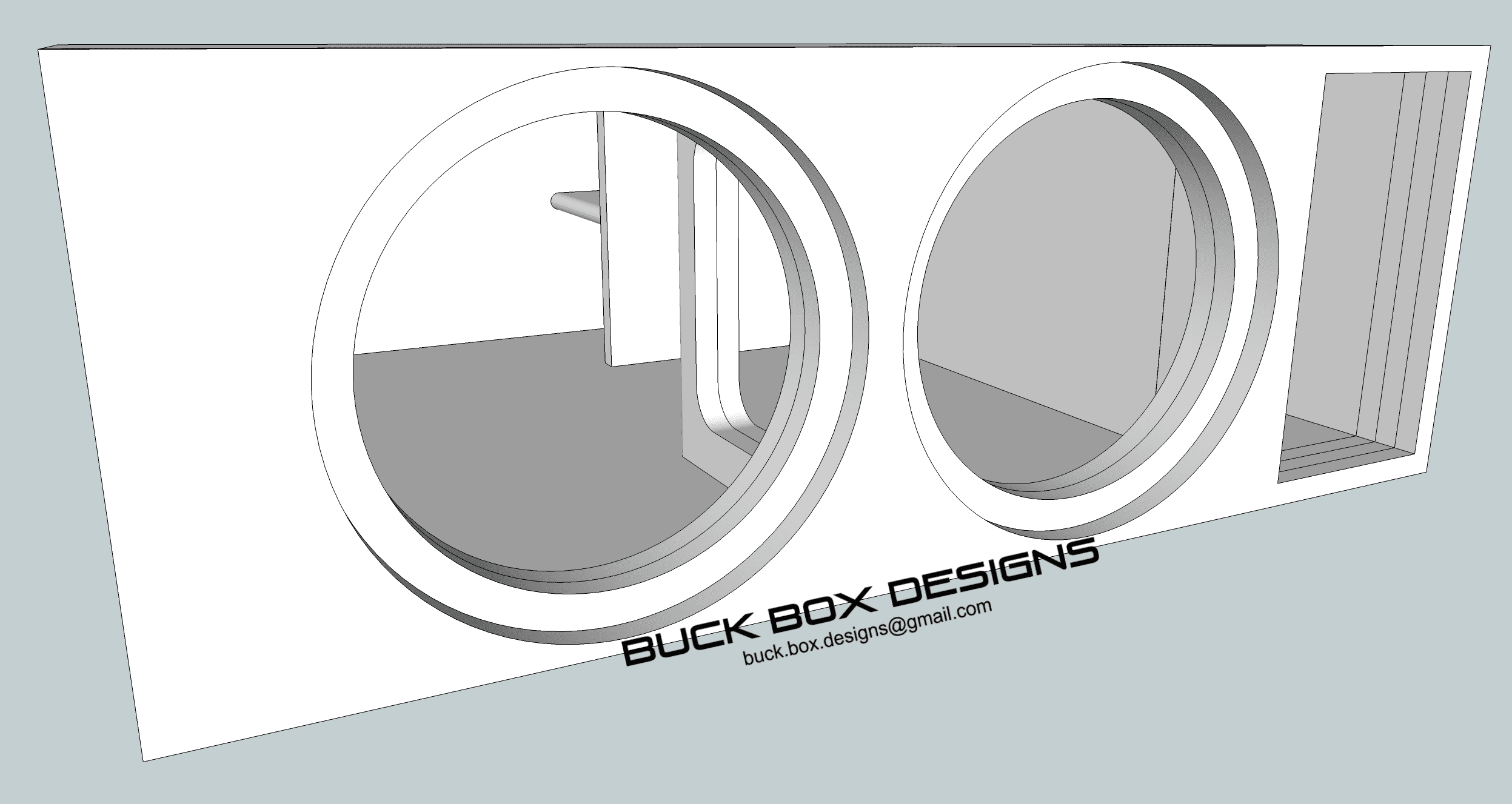

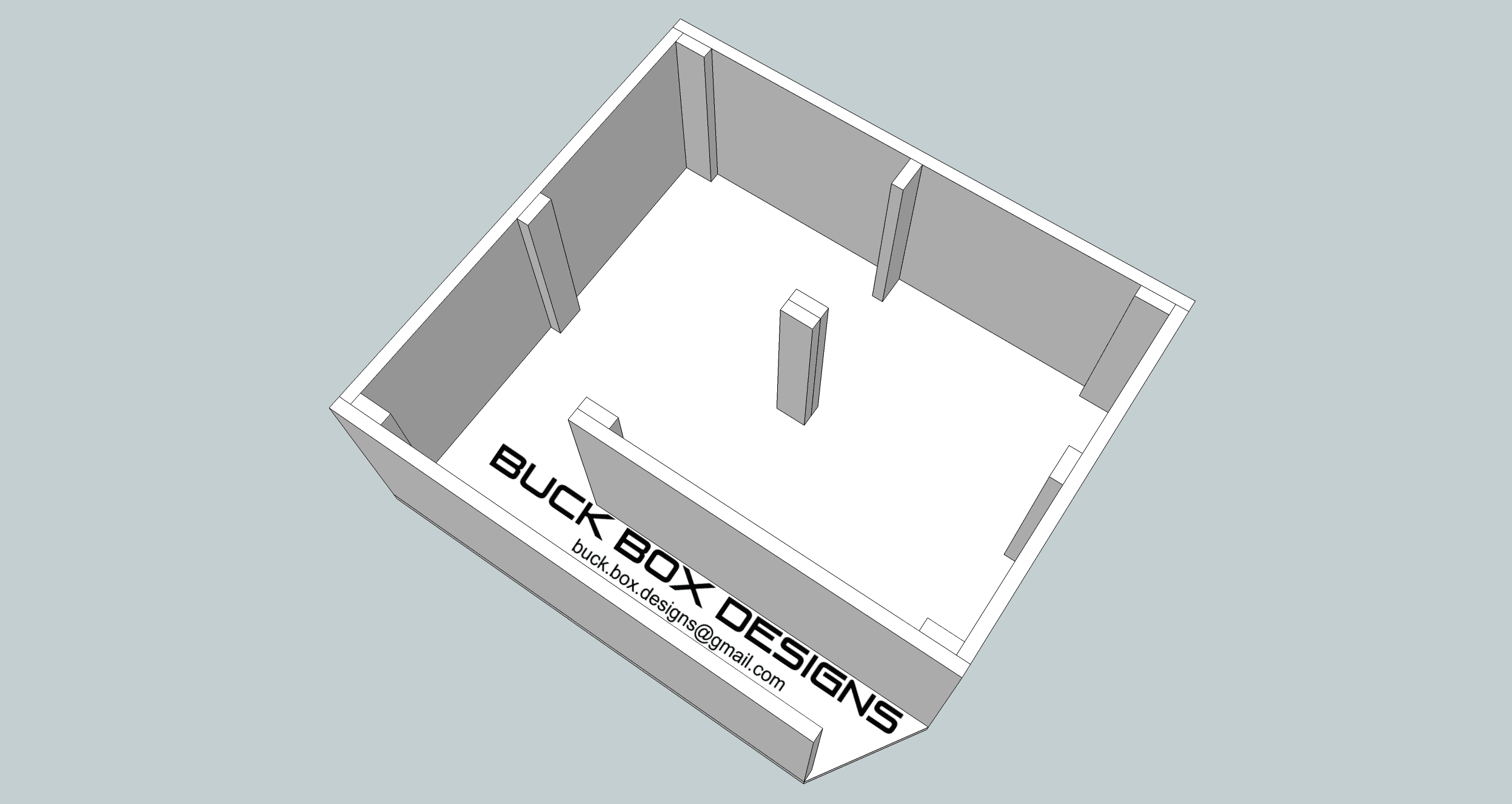

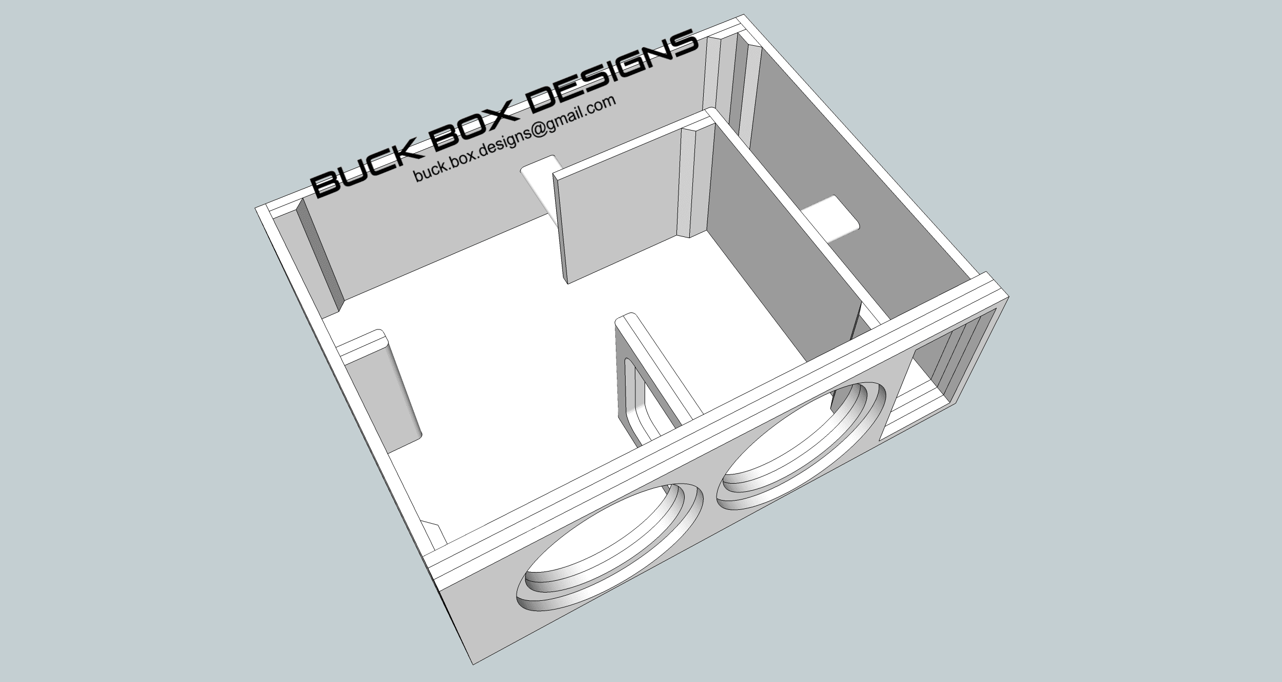

2 American Bass XFL 10's ported in a very small hatch car.
29353
29354
29355
That is an extremely long port. Why so long?
It's low tuned and pretty decent port area. XFL's can move some air, they don't have the highest xmax, but they have decent throw. The port is also flared, so the port looks a little bit longer than it actually is. It's overall what was decided on after discussing the goals and overall system.

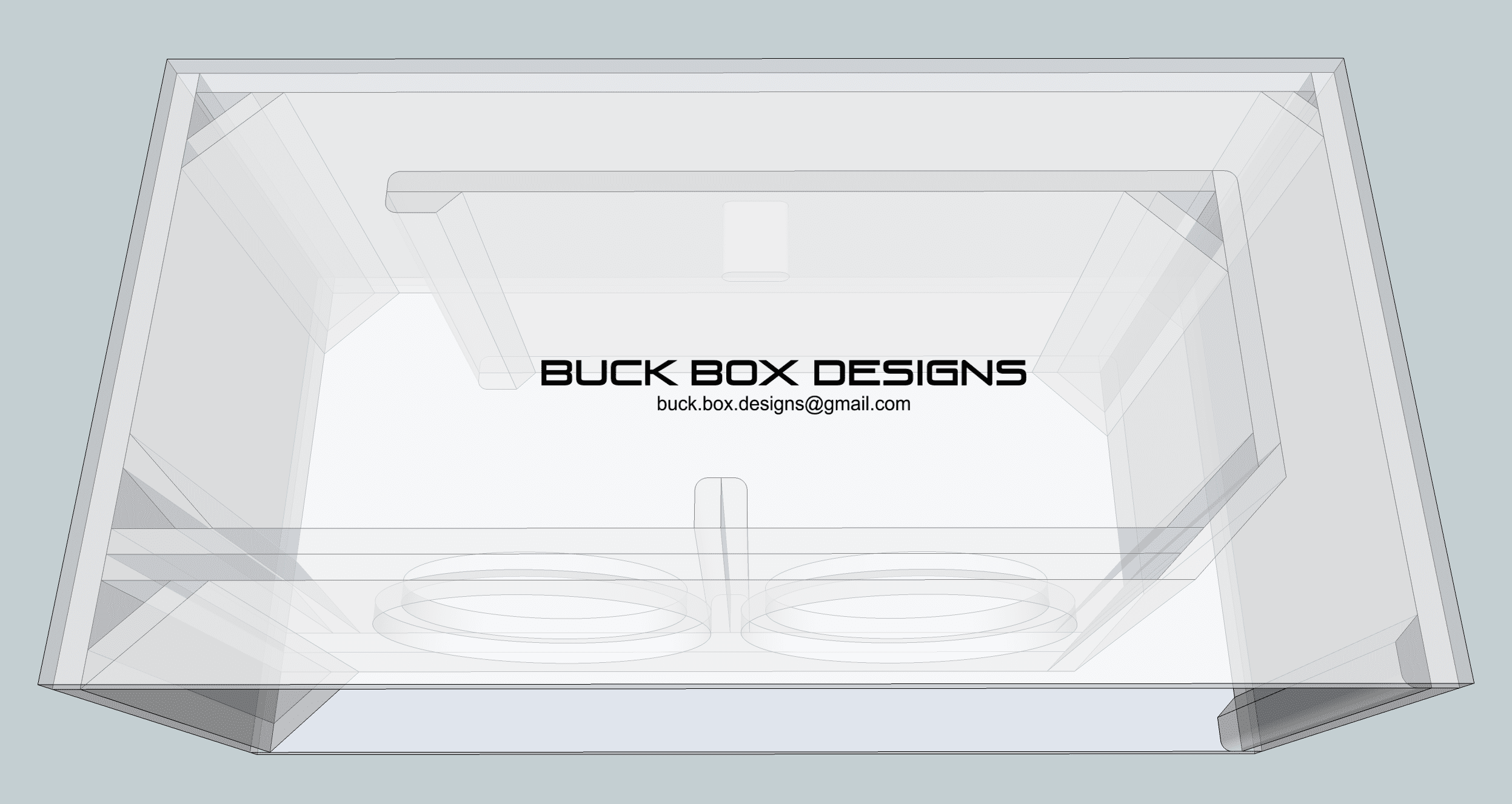

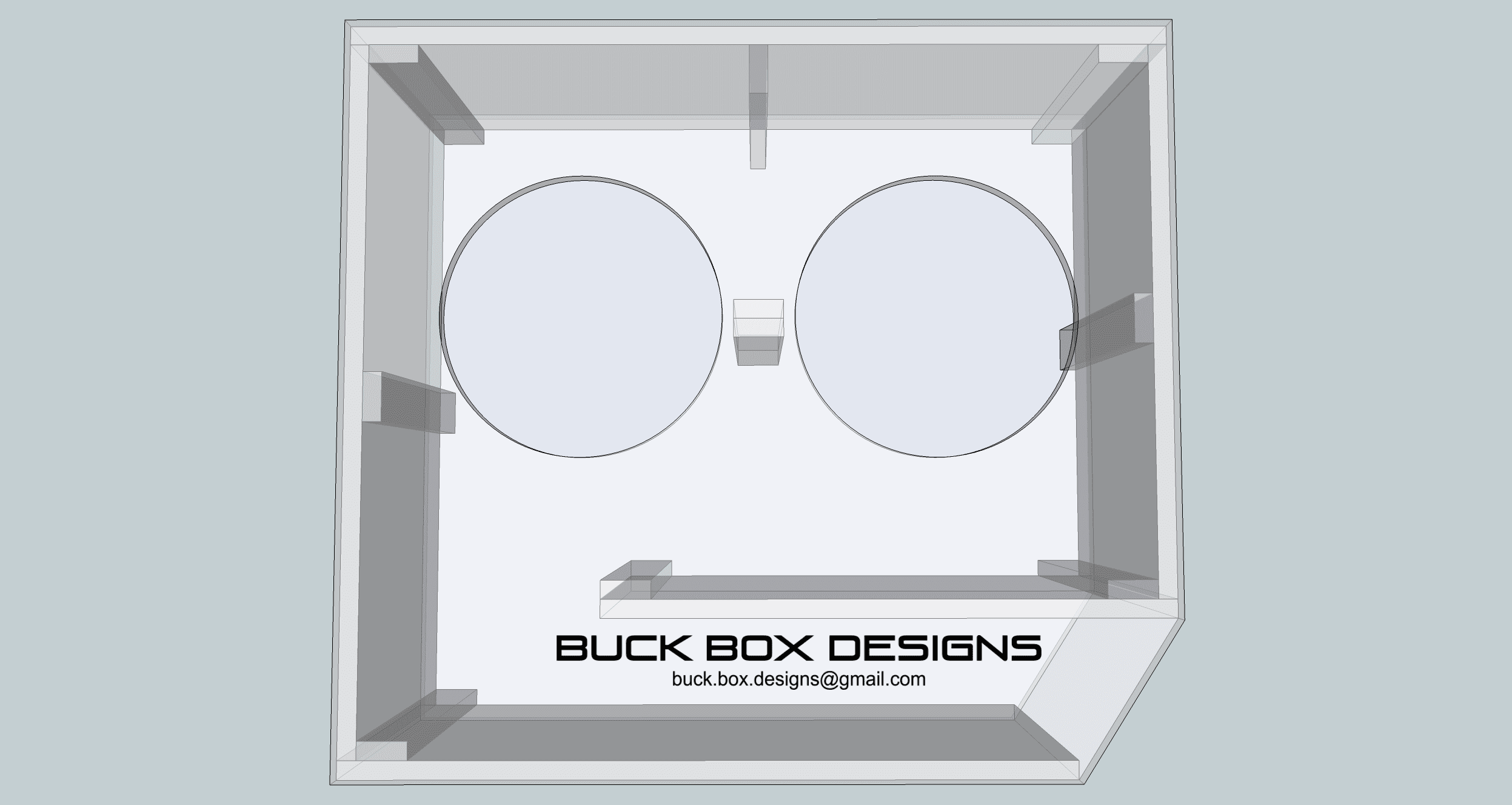

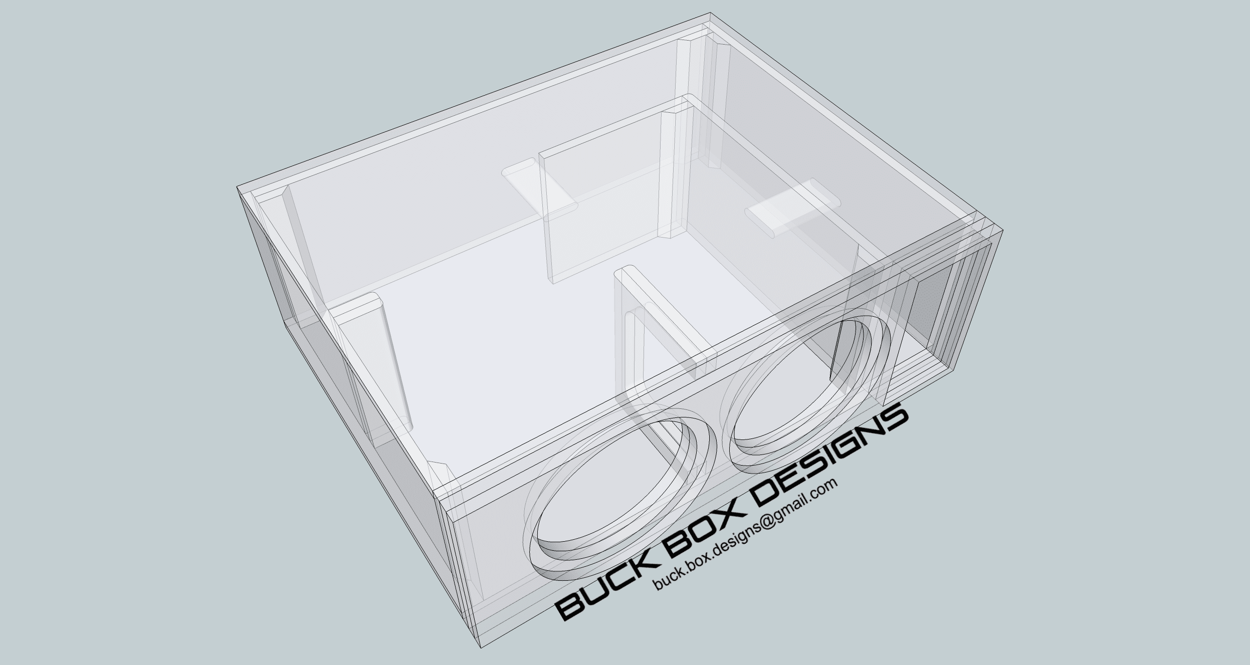

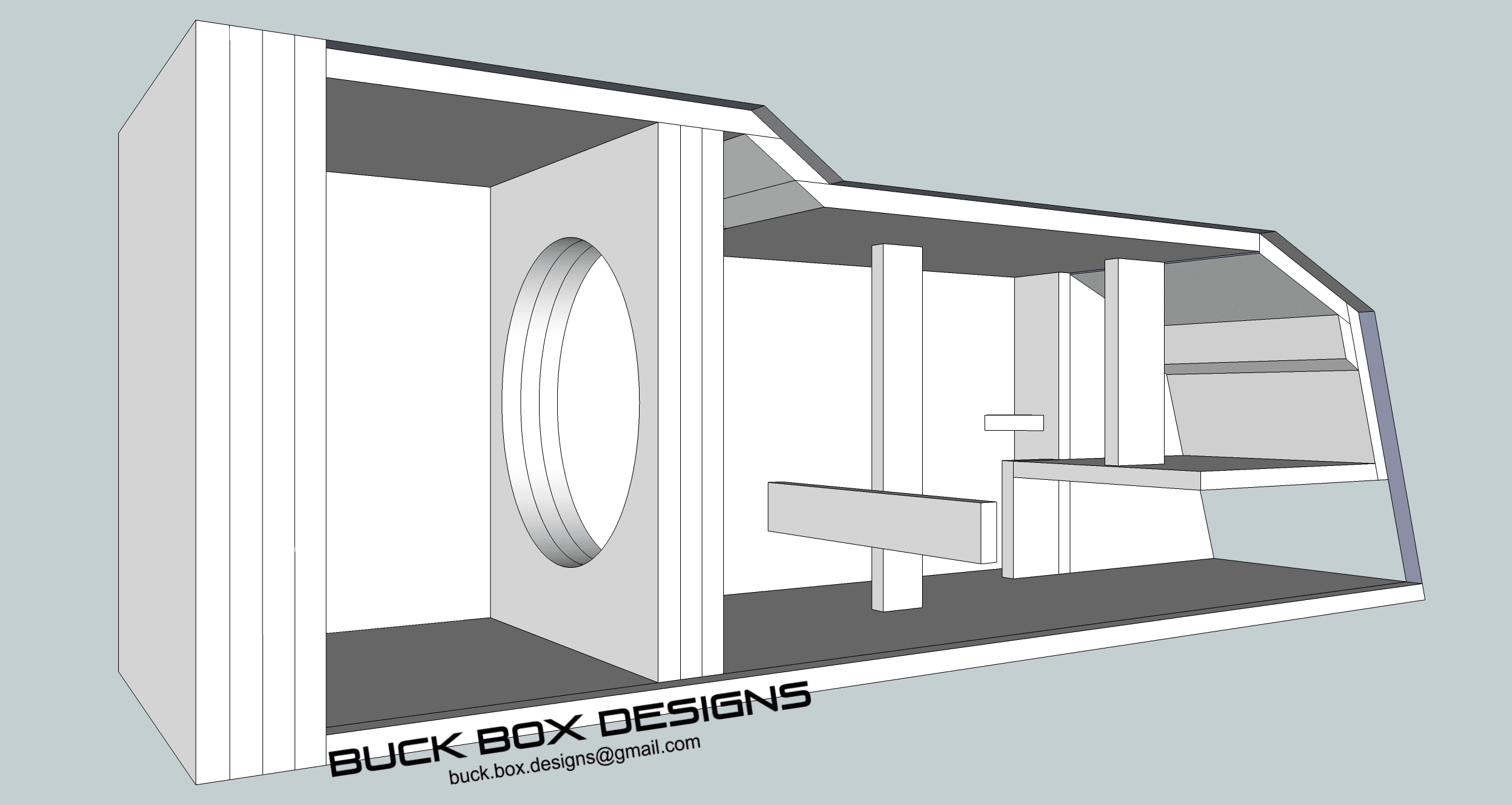

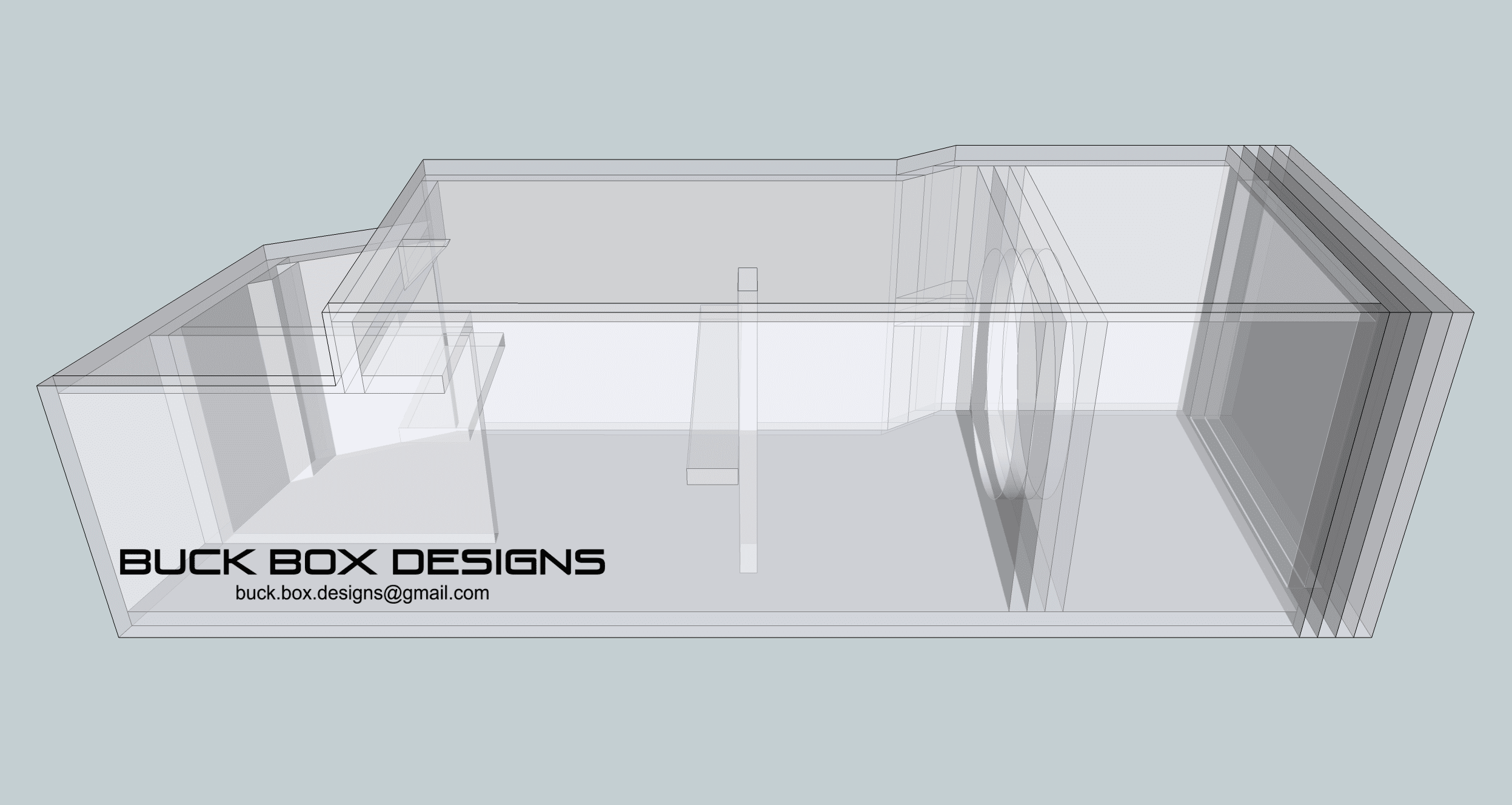

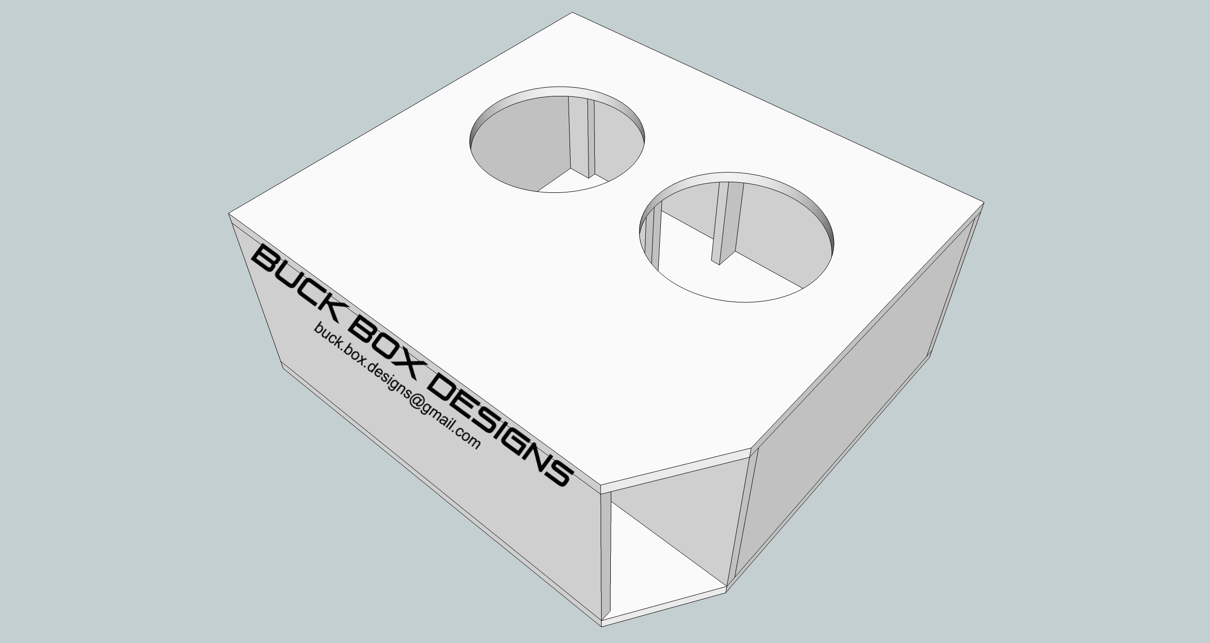

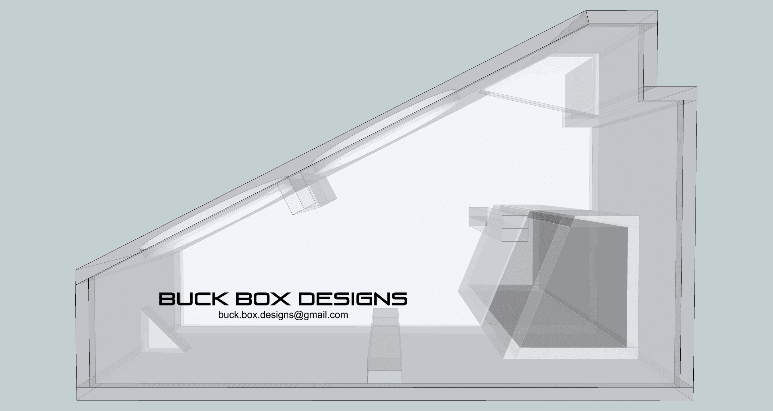

2 Sundown Nightshades ported, firing forward in a trunk, tuned low by request, aim for SPL at a certain low range, perfect subs to do this with. The face of this box will be sort of "shelled" in below the rear deck, sealed off from the trunk on an 8kw rated amp:
