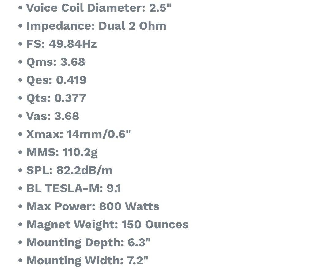

These were the only specs that I could find. The magnet weighs 150 oz. if that makes a difference. Thanks.
Ugh they give Bl but not Re. Looks like these might be bigger box woofers, like .75-1 cube per. Maybe larger, probably somewhere around 1 cube if I had to guess, with that Fs and Qms, looks like quite a stiff woofer, relatively. It would be interesting to see Cms and Rms of this woofer, as well. Like I say, that Fs and that Qms looks like it's a bigger box woofer, but I don't have every t/s I need. Knowing AB, it's probably a 1 cube 8. But let me know what they say, I'm just educated guessing off this limited amount of info.
Ya, the box we are starting with is 2.18 cubes before subs and 4" aeroport. Will be running them on 3k at two ohms. It's always tough to find all the specs on AB subs.
