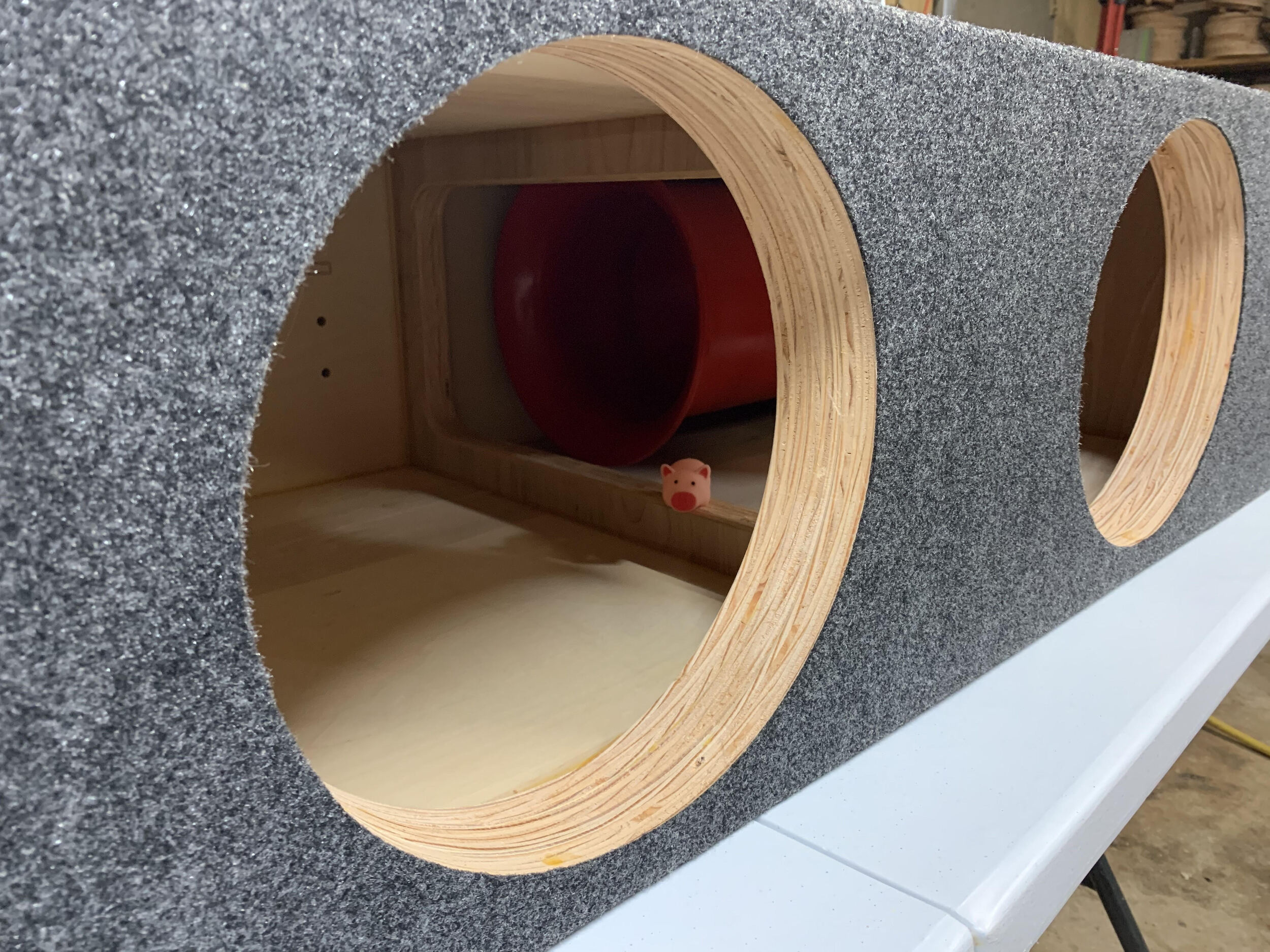

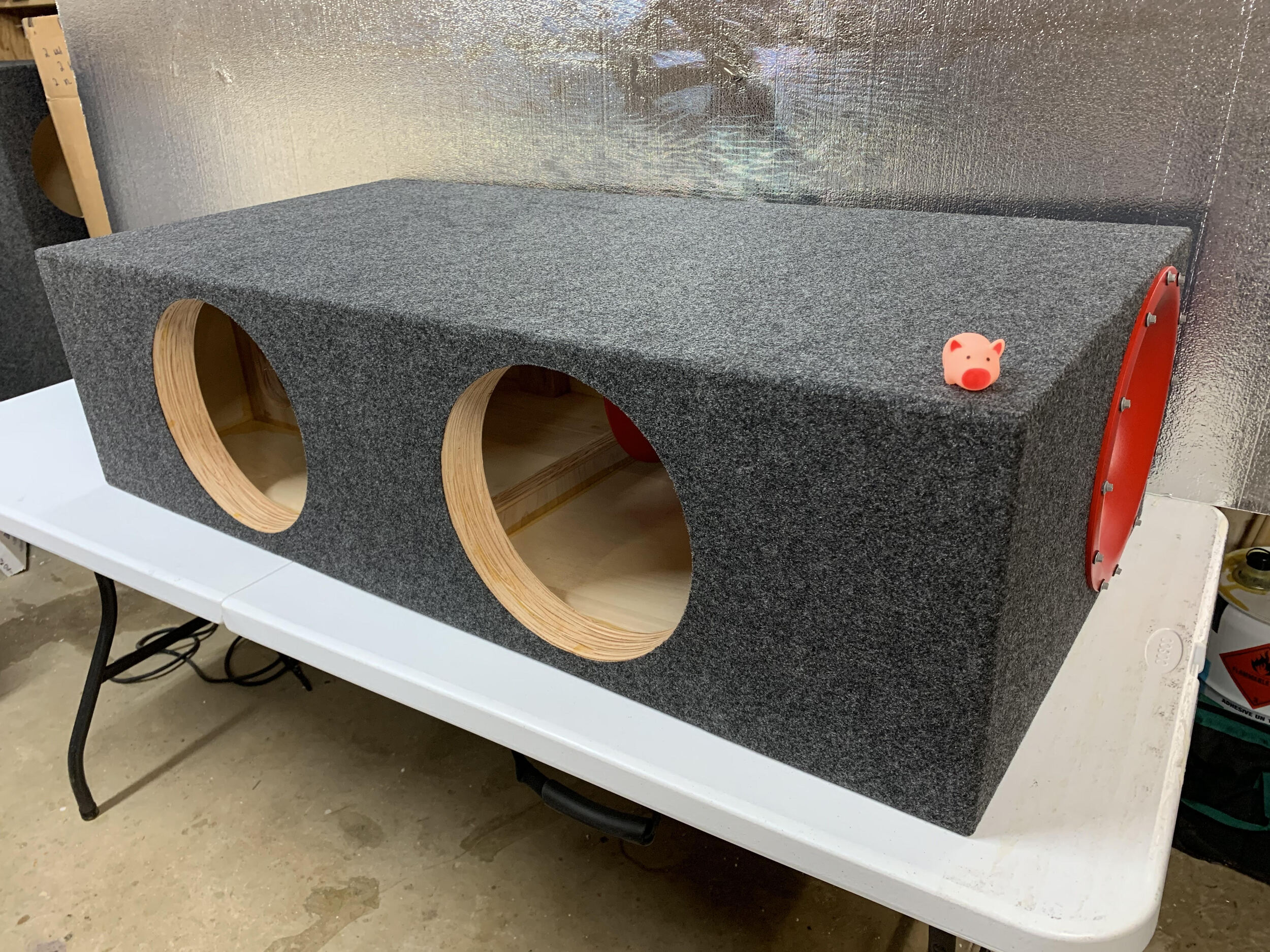

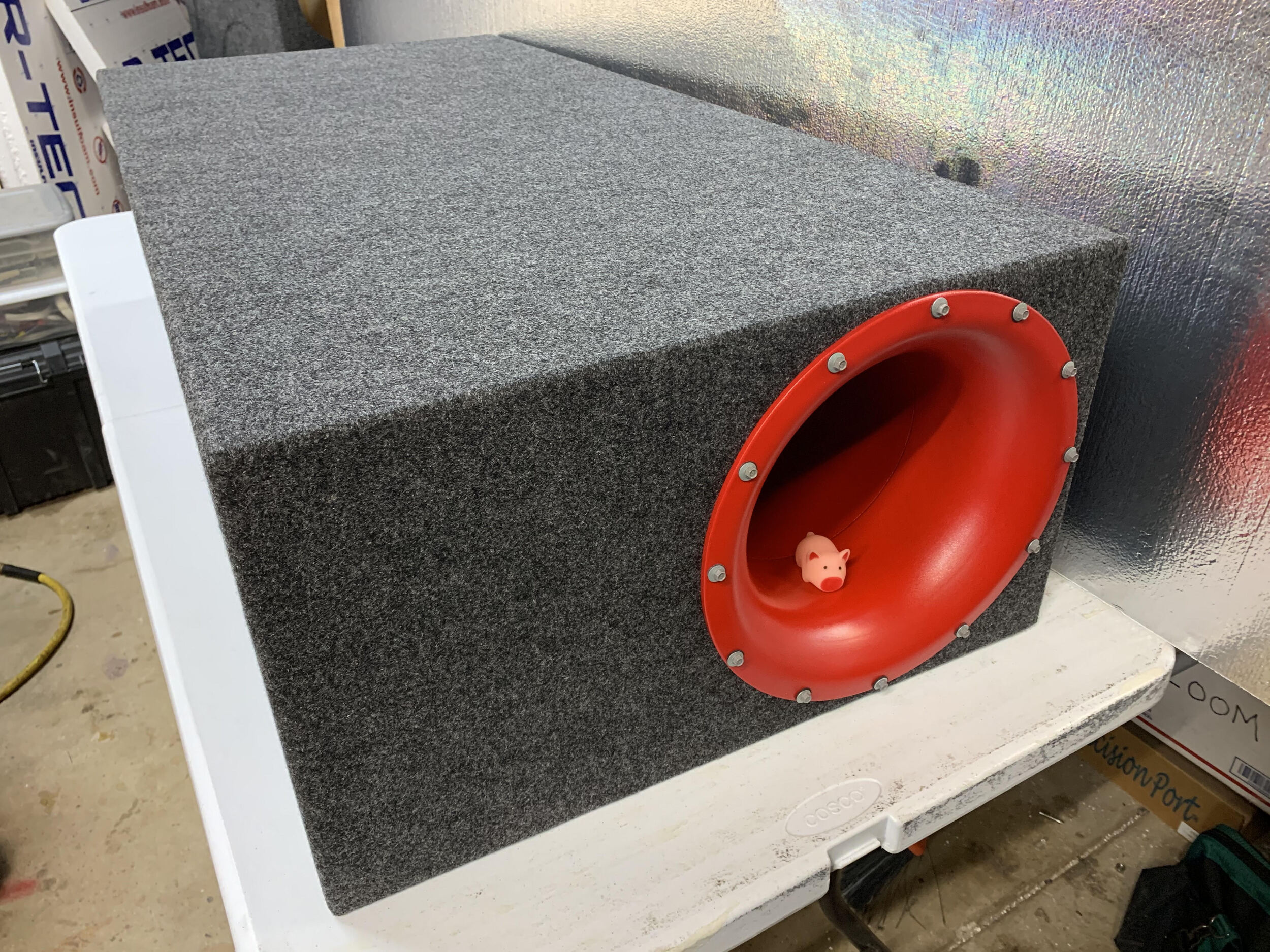

You can attach PVC to the inside of an outer wall, drill a hole, use a router to cut a perfect hole and then round over the wood and you basically have a flared aero that looks really nice and doesn't have a flare that's twice the diameter of the damn pipe.
Like flared aeros are cool until you figure out how much room the flares need to be mounted.

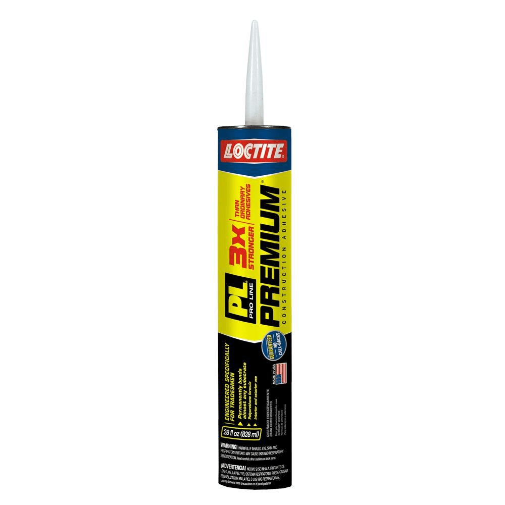

CA glue was used on that box I showed.
I like the loctite for people who are doing their stuff at home. Like if you have to use what you’re limited to, loctite is cheap and you can just make a box and buy a $5 tube and glue a port in and it’ll work great.
I just asked my installer. And, yes, it's called Ca glue. That shitt is incredible. Did you see ny lithium dilemma?
