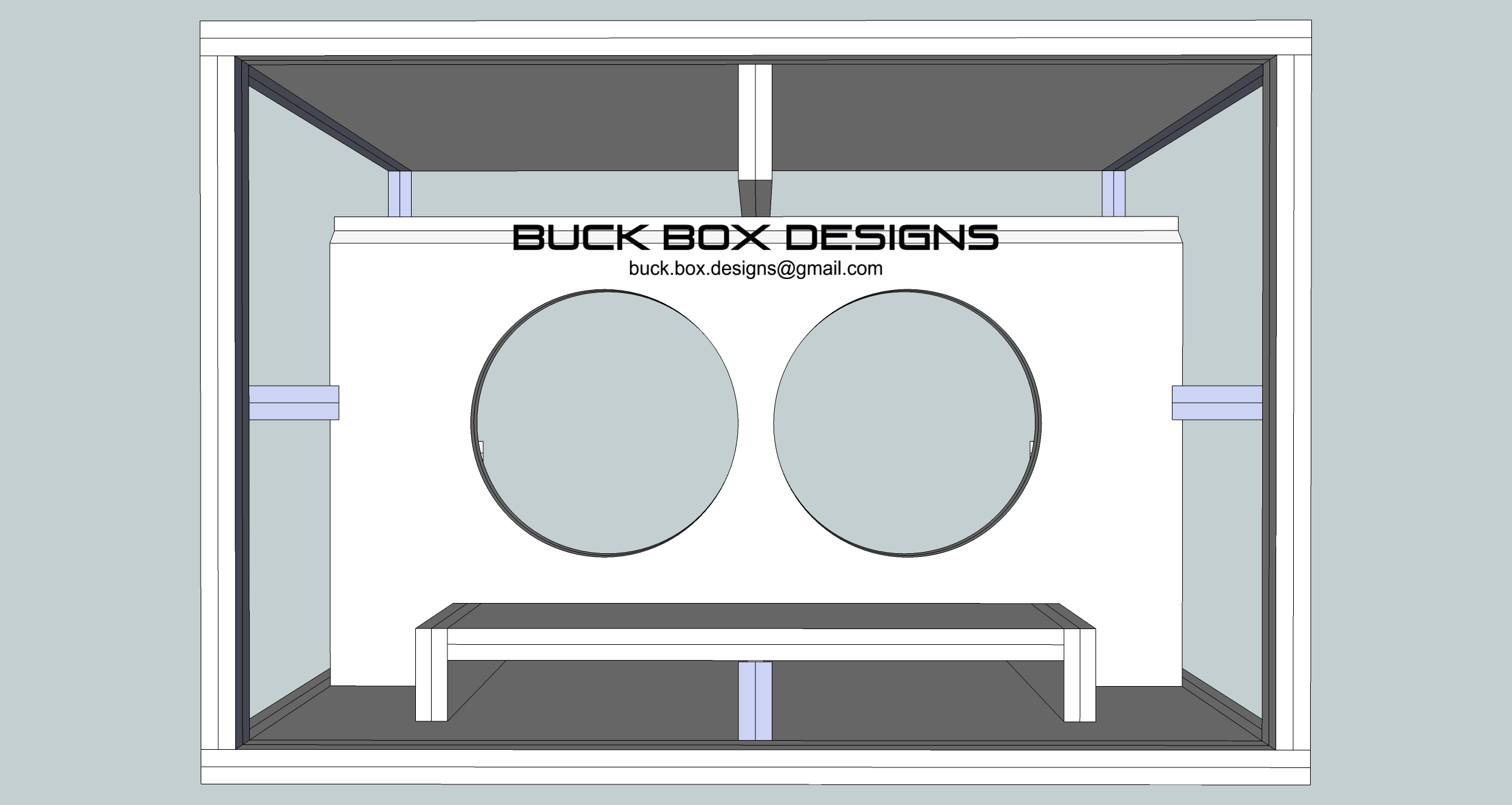

Mass in certain locations. I don't want to explain it fully haha.

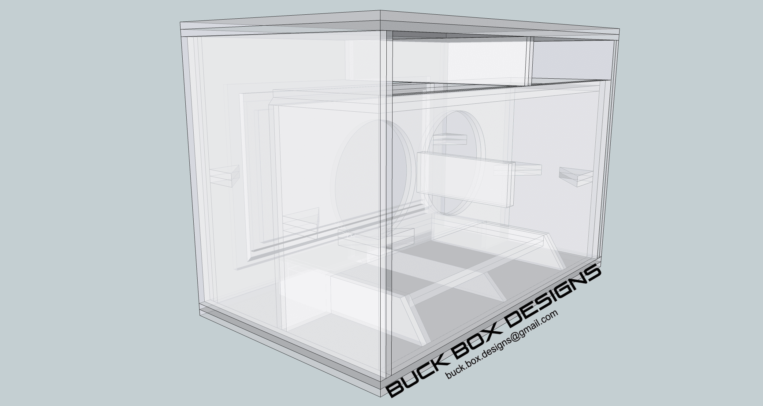

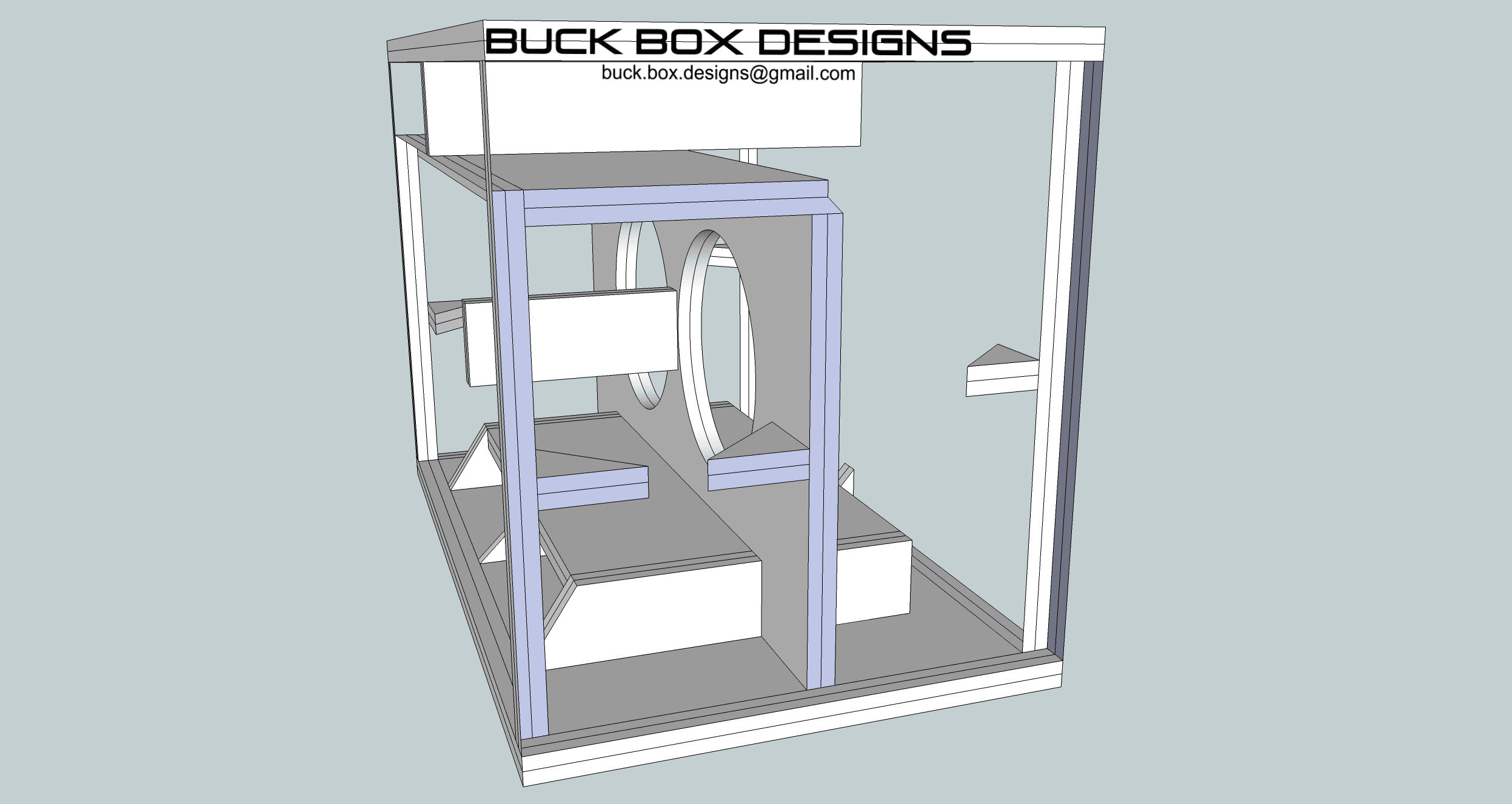

I'm not trying to steal any trade secrets or anything. I understand the bracing and 45's. Those two pieces just got me curious as to what the thought was behind them. But, I understand if you don't want to answer the question. Nbd!

So, is he saying that those two pieces that I highlighted are braces of some sort? All his designs look very solid.

Yes... adding mass is like a brace. The bigger the panel the more you need hence the double thick one on the rear panel in that design. Plus you can tie-in the bottom and top to it adding strength.
As he said, some are for mass, some are for airflow and some may serve both purposes. The hard part is when volume is at a premium and you require premium materials to get strength, you design specifically for the materials and end-up with bracing that cuts into your optimum volume. (trunks suk sometimes)
Then the compromising occurs. Lose a little volume, lose a touch of port to keep everything in harmony... designer stuff man.
A enclosure is usually a compromise somehow... even the optimum ones have small but necessary adjustments like for power, tuning or materials/space.

Just a different type of brace that I've never seen before. I'm Used to seeing the T type or window type of braces. I didn't realize that small of a piece would actually help brace a box. I initially thought that those pieces were for airflow, not bracing. Never too old to learn I guess. I guess that those pieces prevent the bigger panels from flexing.

There is math behind it. There's things going on inside of my boxes that people don't know about, unless you are a long time designer like me. Even long time designers that I've know, I don't see them doing it like I do. That's fine, I just have my own style, you know?
My brain has very very strong visualization abilities. Most boxes are immediately visualized in my mind before I ever start looking at numbers. I've done so many boxes, my mind just knows how it's going to lay out. People would be surprised I think at some of my boxes, and the actual math behind them. There's all sorts of tricks you can do with ports, bracing and airflow to save space and help the air actually flow through the box.

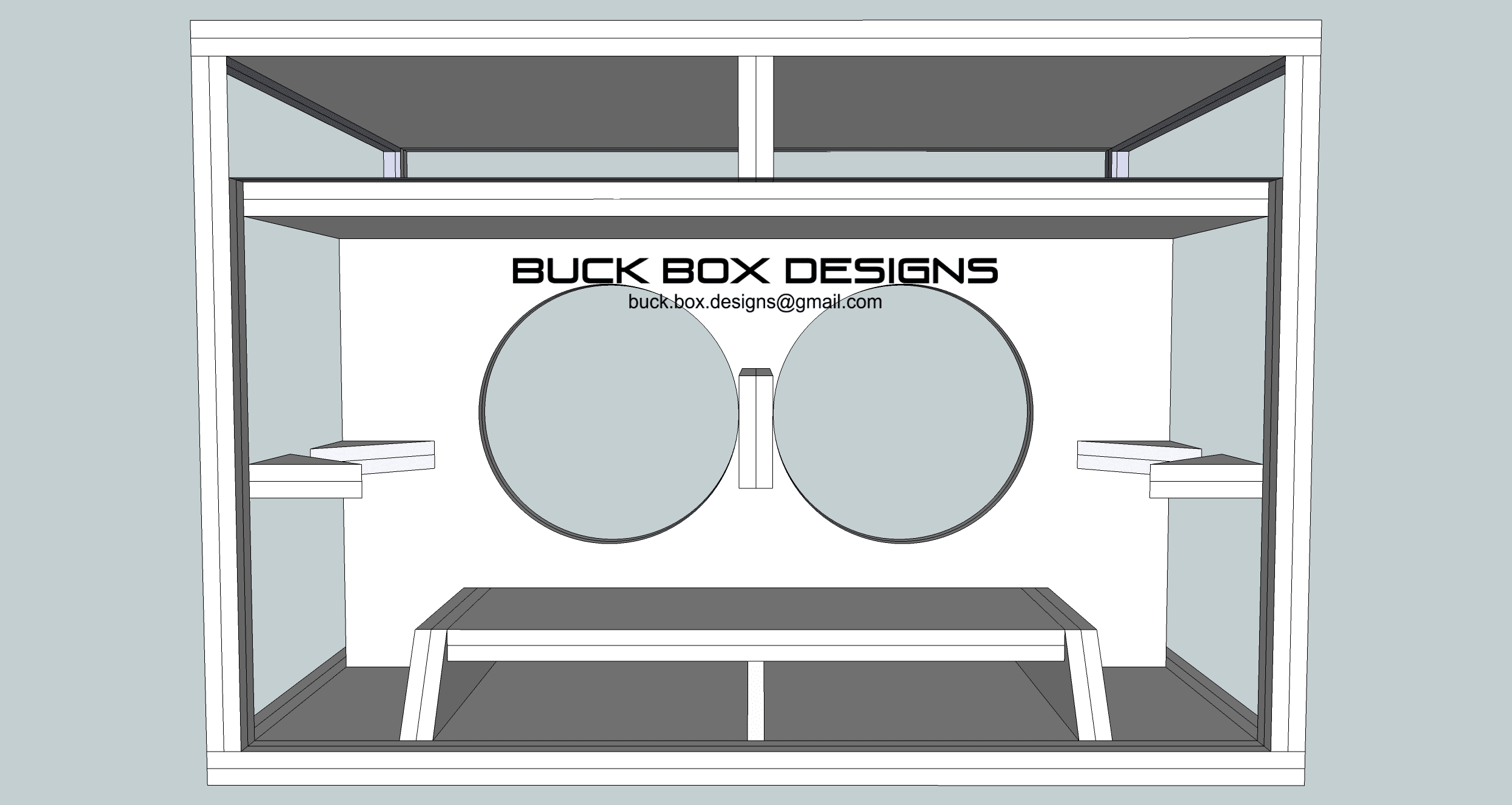

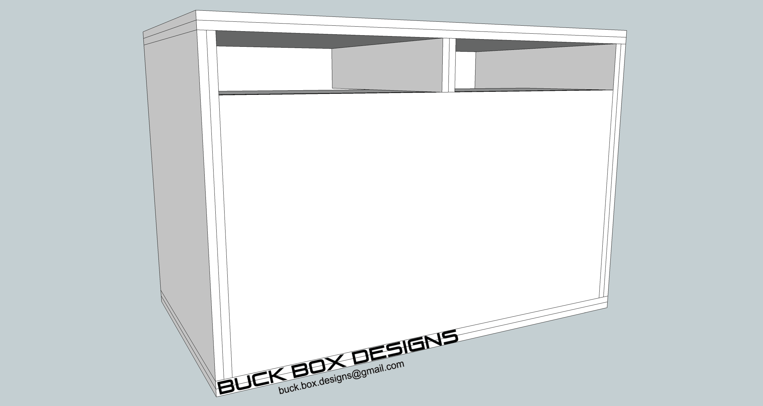

2 Fi Team 15's in a big SUV tuned decently low (good low daily). Series 6th Order C Pillar Wall on a 15,000 watt amp.
This is gonna be loud as F. 15kw amp powered by 4 alts in a series 6th order designed around a decent daily low end tuning, with pretty good port area to handle all of that power. The front port on this box is pretty large. And the whole box flows like a spiral, in and out. From the back of the subs, into the rear port, out the rear port into the front chamber, back past the subs, then out the front port. It's one big push and pull system.
Me trying to save space here to get the airspaces and port sizes I wanted actually made the port and chambers tie into each other well. It's just gonna be pain coming out of that top port.
