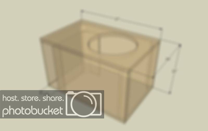

Here is what I would do if I had those dimensions to work with...
Net Volume: 6.49 cu/ft
Tuning Freq: 32.95 Hz
Port Area: 103.69 sq/in

I'm looking to build a box for (2) 15's that's 37w x 23h x 24d in the next weekend. It looks close to rpfuror's design, but I made it without the L port with my design it's just a straight port with 107sq.in. of port area. Watch for it next weekend.

man that box you built is pretty close to the design above... looks NICE!//content.invisioncic.com/y282845/emoticons/smile.gif.1ebc41e1811405b213edfc4622c41e27.gif
