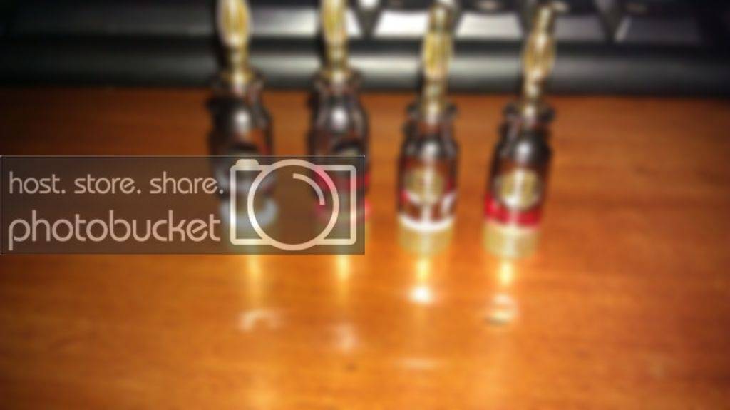

get some heavy duty banana plugs..
got 4 gauge into these ones easily lol
